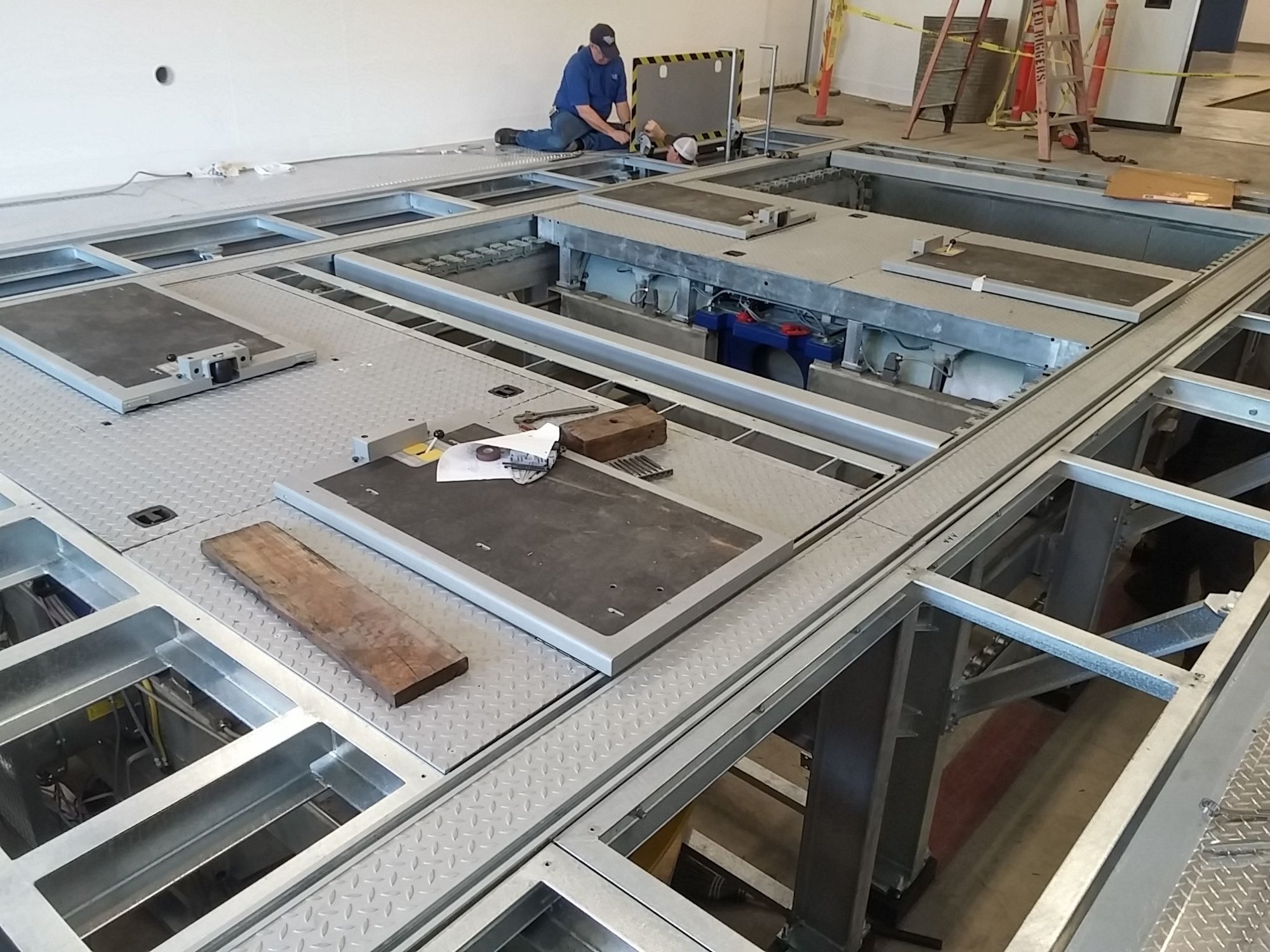

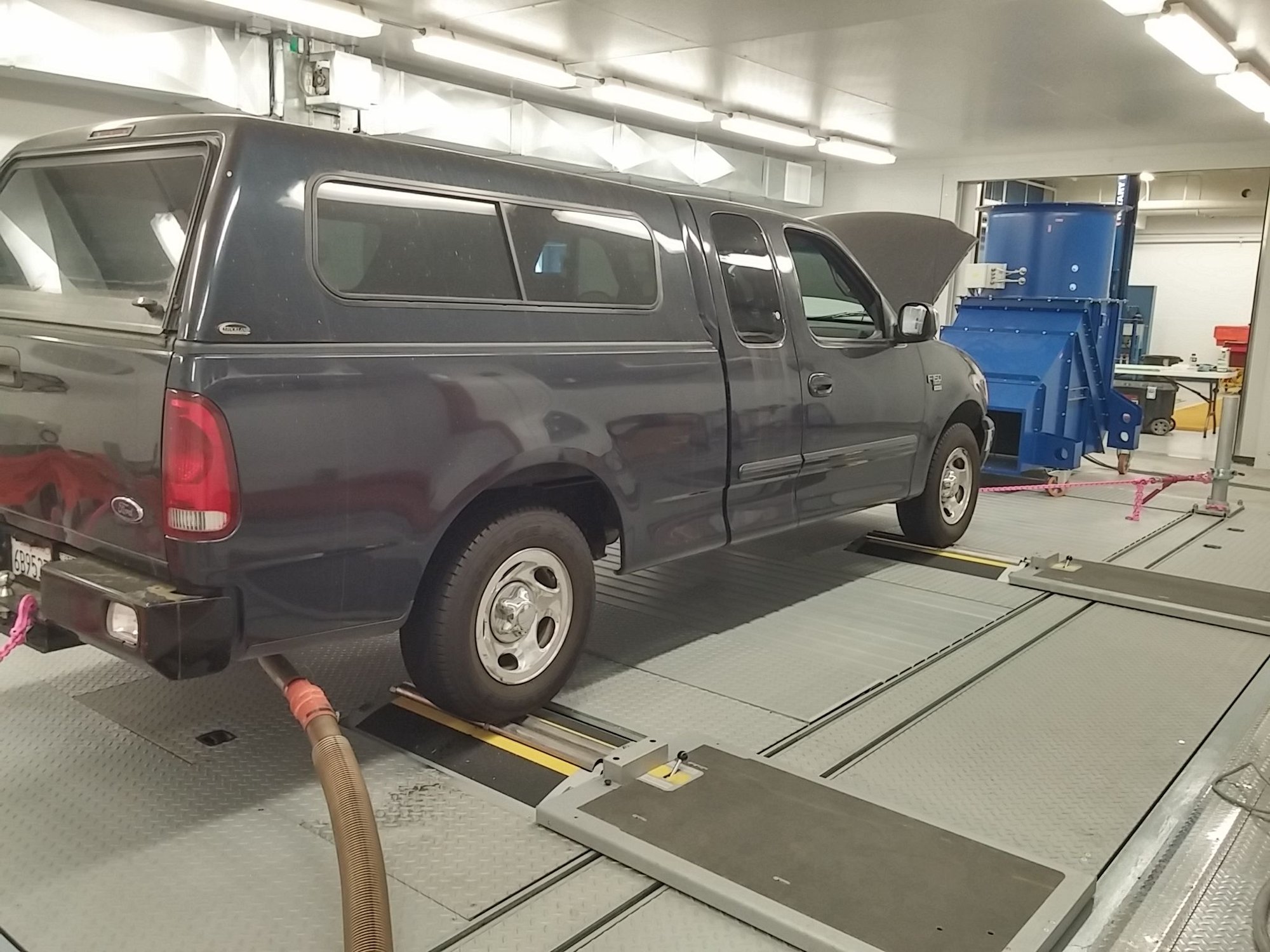

I used to manage the largest independent Auto Research lab west of the Mississippi. I have tested over thousands of AM products.
People have always reached out to me and asked for my comments about certain products that I have tested. Of course, I can't comment about the results of the products because it's proprietary information. However, this is what I told them: "If it seems too good to be true, then it probably is."
This is our > $1 mil AVL 4 wheel dyno in the cold room, temp can be adjusted from -40°F to >140°F.
