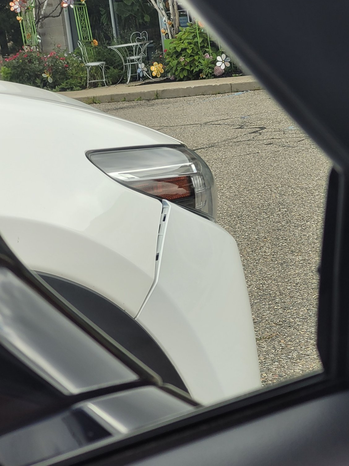

So I am at my local coffee shop & noticed this current-gen Mazda CX-9 with a front right Apron Issue. Is this common in the entire industry?
It is extremely common on older cars, but not newer cars much less a Lexus. FYI the bumper on that Mazda has been repainted so that's probably why its falling off. It doesn't match the fender.
I think in most cases with other cars it’s a lot with how people park too. In our family we’ve had two Corolla’s that the front bumper started separating and in one case it went as far as cracking at the clip area. I always wondered why it was always the case with the cars my dad drove. Then I got in with him and immediately realized that in the case of the Corolla it had an aero flap on the underside that would catch on the parking stops if you got too close. And my dad would go all the way into the spot and when he reversed you would hear that aero piece which is attached to the bumper, drag on the parking stop. Now I tell him I rather he not fully park all the way in than do that and destroy the bumper, but he still does it

Originally Posted by macmaster
It is extremely common on older cars, but not newer cars much less a Lexus. FYI the bumper on that Mazda has been repainted so that's probably why it’s falling off. It doesn't match the fender.
While I do agree that in this case it looks like it’s had some body work done, 99% of bumpers do not match fenders because of the difference in materials. They are also painted at two different points in the assembly line so the color is always somewhat off.
