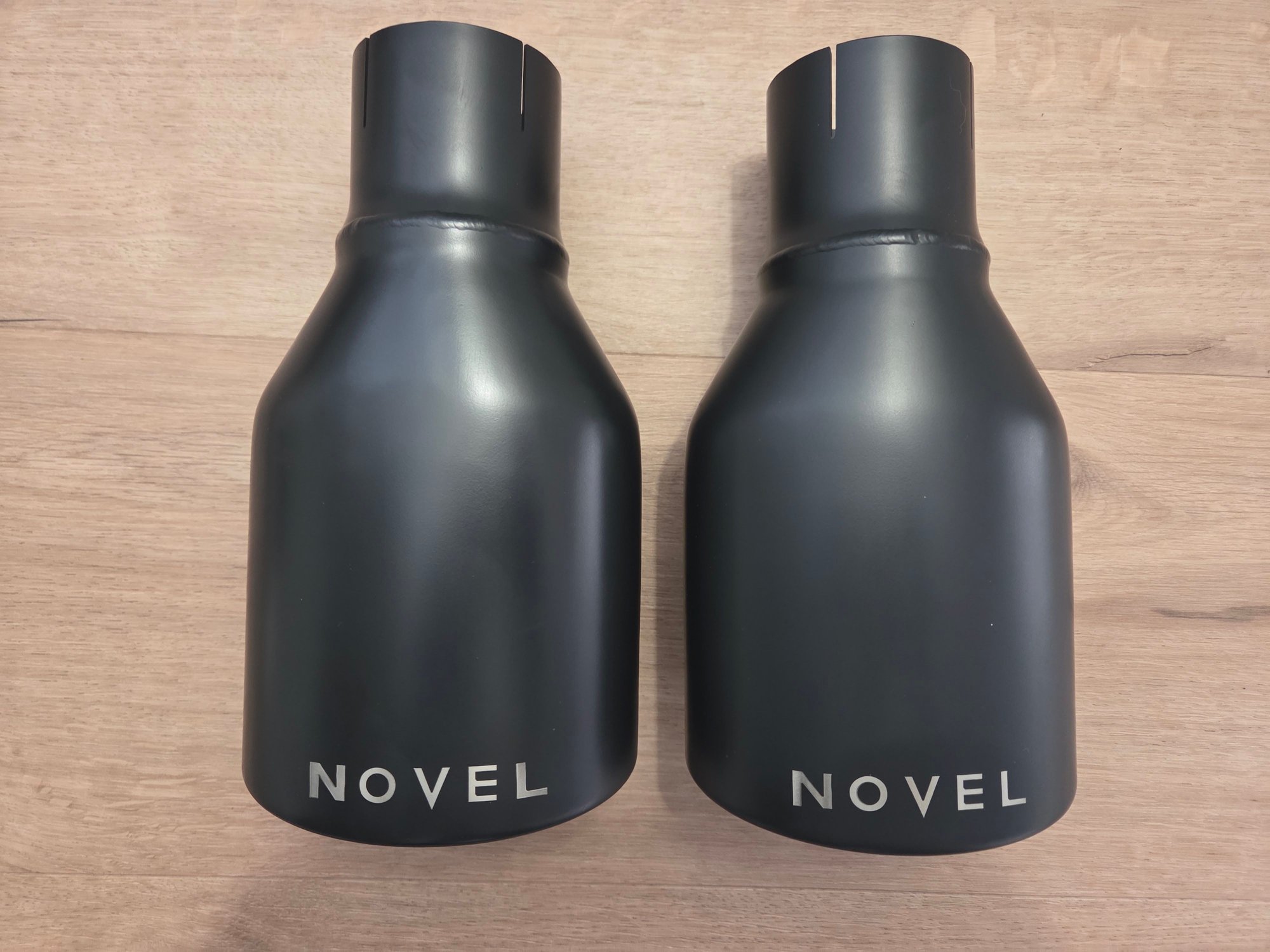

Powder coating these cost me $280. I wouldn't do it again though. The finish dulled out from the heat after only a couple of weeks of use. Only noticed it when I removed the exhaust and sold it.
If you're looking for a glossy, flawless, smoothest, and most durable finish, then go for PVD coating. If you can find a shop to do it for you, it's around $500.
If you're looking for a satin/matte. flawless, smoothest, and durable finish, then go for Cerekoat`d coating. You can get this done at pretty much any firearm customization shop. I went this route for my Novel tips (with laser etching back the Novel letters).
