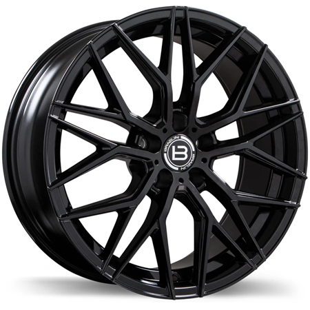

As others have mentioned, the OEM Enkeis will not clear the Brembos in the front without spacers. I ended up getting Braelin BR10 with +35 offset (BR10-1985-65BN+35C601) which had similar design as the Enkeis. Another member mentioned that they couldn't find it in the States, but google is showing that there is a online based vendor that does carry them, you might have to reach-out to them directly if you're interested!

@sfzxr89 Okay so Braelin looks like it manufactures the BR10 to meet many different dimensions according to the application list on caliwheels dot com
The dimensions are broken down in the name BR10-1985-65GM+35C601
  • BR10: Model name (Braelin BR10).
  • 19: Diameter in inches (19").
  • 85: Width in inches (8.5").
  • 65: Bolt Pattern (5x114.3mm, with '65' representing the 5x114.3 PCD).
  • BN: Finish (Gloss Black - "BN" for Black, "GM" for Graphite, etc.).
  • +35: Offset (ET35 or +35mm).
  • C601: Center Bore (60.1mm), sometimes represented as just '60.1
You did not need a hub centric ring right? This wheel looks like a good fit on paper but is it a tight fit / close call at all?
I may go with this Braelin wheel but in the Matte Graphite Finish. I don't think I can stomach dropping almost $6k on a set of OEM BBS wheels and be paranoid about potholes and other potential damage to them. I can save though almost $1k on the OEM's because Lexus is running an online special with 12% off and big discount on shipping. Would come out to $1,466 per wheel after all discounts
Old Dec 15, 2025 | 09:41 AM
sfzxr89's Avatar
sfzxr89
Joined: Nov 2025
Posts: 20
Likes: 16
^ yup, those are the exact specs! The only thing that was required were new lug bolts as the OEM ones were ball seated, and these are conical. To me, it's a perfect flush fit, here's a pic of mine from a week ago -
