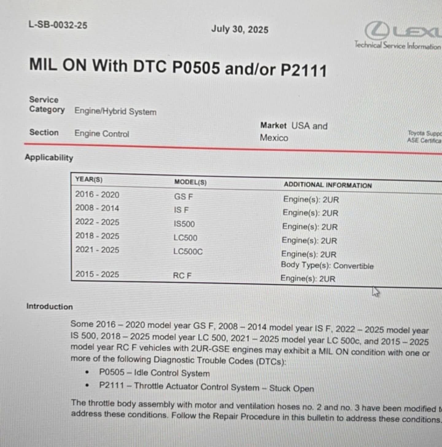

^^ Interesting to see that this suggest the Throttle Body has been modified/changed despite the part number having remained the same - This sort of sucks as I was hoping to just swap the hoses and clean teh throttle body and hopefully put this worry behind me given that my warranty is about to run out in a few months .
In the original TSB bulletin that was posted, only the hose part numbers had changed but the last line of the image you posted, it states "The throttle body and motor ... have been modified"

^^ So I went back to page 2 of this thread and the TSB that was posted there contained the same language (i.e. it is the same as you posted). What is confusing and misleading is that the word section suggests a new throttle body assembly while the part section suggests only the hoses have a new part number. Can they replace a part and keep the original part number (referring to the Throttle Body)? This is where I hope someone with lots of experience can chime in I remember a user (Sasnuke) was amazing for this type of stuff but I don't see him on here anymore

Originally Posted by DLPTony
@ILikeBlue posted this on the FB page today.
Good news everyone!
I was given this screenshot and told I could share.
Apparently end of July Lexus released a Service Bulletin(L-SB0032-25) for our throttle bodies. They were redesigned with a new part number.
This also covers every 2UR all the way back to the ISF, which leads me to believe it's a permanent item that's marked in their system if it fails in the future.
You won't be able to request a part swap preemptively, but it'll be better documented if it does ever fail in the future and you'll get the new version of the part.
Some piece of mind if you encounter it later on and one less thing to worry about.
This is why I had my doubts that just the hoses were supposed to fix anything. We can only hope that Lexus will do the right thing and honor this SB past warranty or the SB date if it happens to us later on.

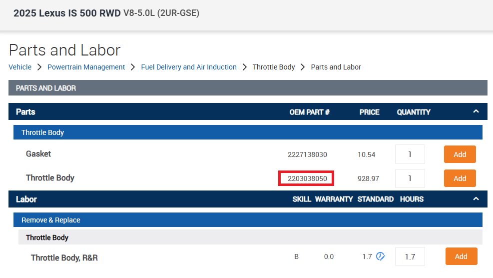

If the throttle body has the same part number, then how do they know if a throttle body is the updated version?

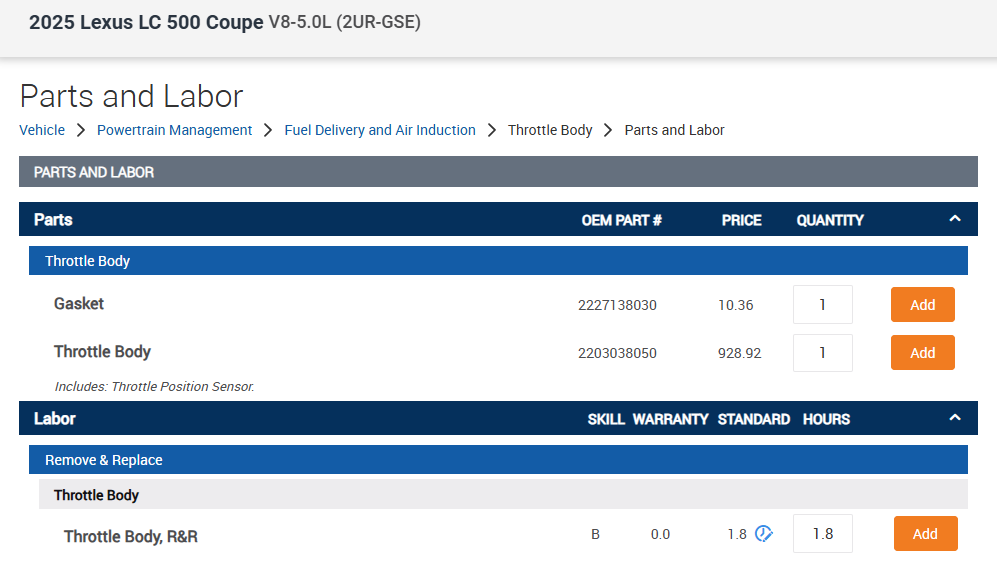

Old Throttle Body = 22030-38030 ?
New Throttle Body = 22030-38050 ?

Originally Posted by tammap
Old Throttle Body = 22030-38050
New Throttle Body = 22030-38030
The 38030 is a throttle body that seems to fit 08-2014 ISF. There is no new part number for the throttle body for the is500, etc.. not that I can find. TSB still lists the 38050 number.

My bad! Alldata shows 22030-38050 for both LC & IS
