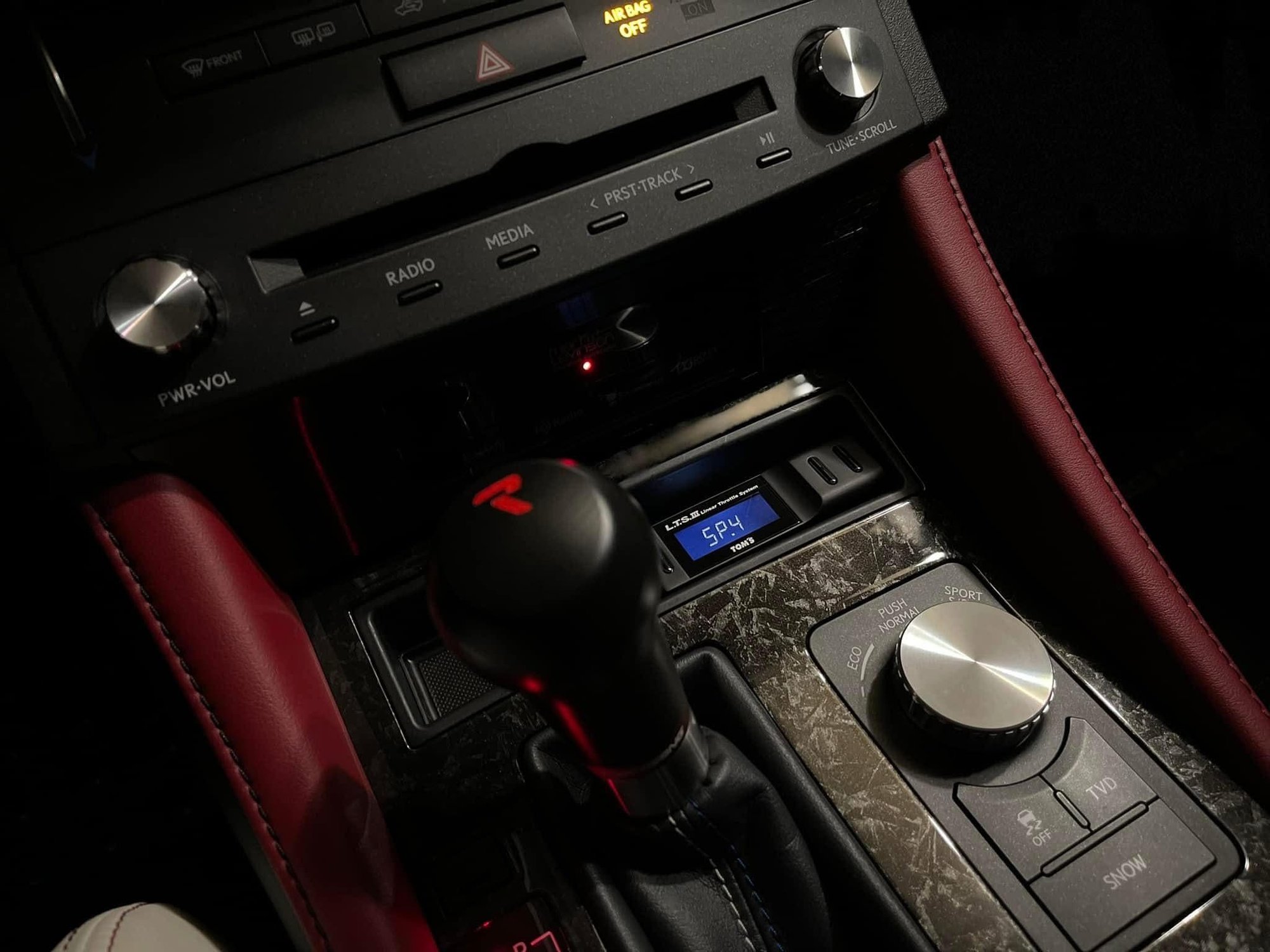

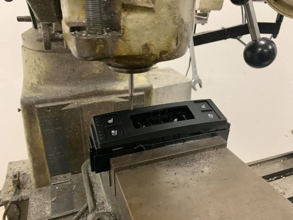

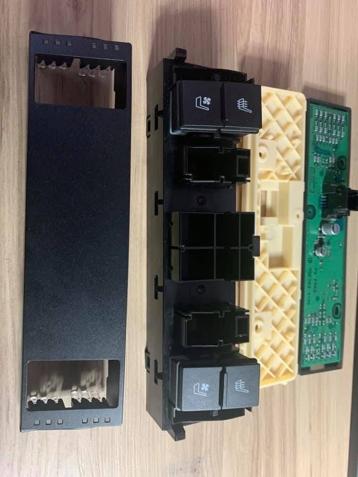

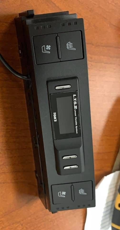

The top switch panel is all one piece and the whole switch assembly comes off from the bottom after removing the center console. There is room in the center of the panel to mount the Tom’s controller. I have removed the switch assembly on mine and replaced it with the track edition RC F panel, it’s just a cubby and I put the Tom’s controller in there. I did this because I don’t have the factory heated seats anymore on my RC F. However, here are some pictures from someone who made a cutout on the switch panel and mounted the controller on it.
This last picture is mine:
