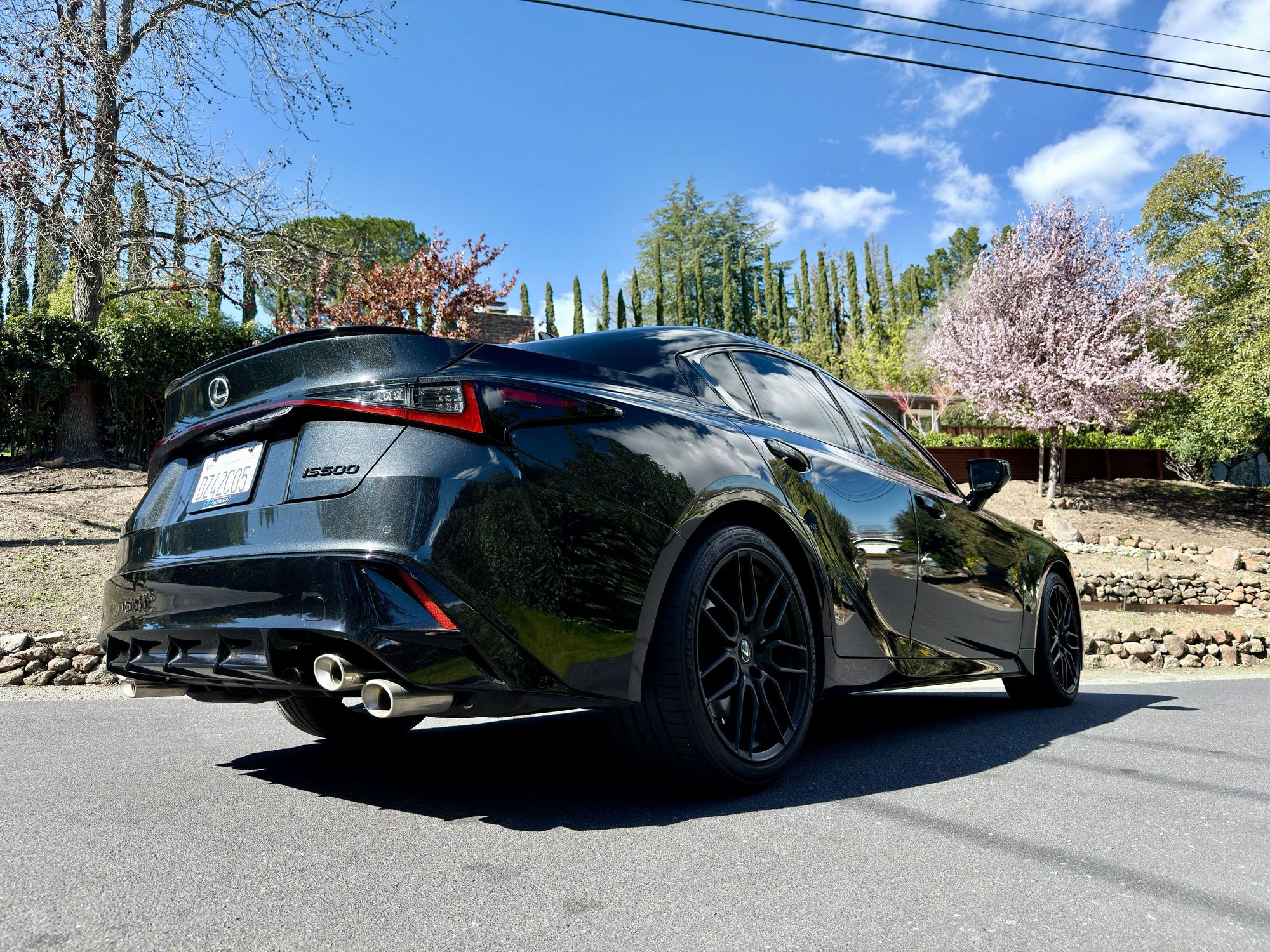

I had a 2019 IS300 that I bought IS500 wheels and put on the 300 shown here:
I bought a 2023 IS500 with the same wheels, shown here:
Long story short, I have newer Michelin SP4AS tires on the IS500 wheels that were mounted on my IS300. The wheels that came on my IS500 when I bought it used, have the stock Potenzas on but they are beat up so I wanted the fresher tires on while I buy new tires for the other set.
Very odd, as both should have the same sensors. I checked the frequency of both sensors and both wheels have 315mhz TPMS sensors. I have tried and tried and tried to add the other set of tires, both with my OBD tool, and a dedicated TPMS tool and neither seem to work. I ended up adding the TPMS serial numbers from the wheels with the bad tires back on and the TPMS light goes out instantly and those tires show pressure. I really can't understand why these sensors won't register.
