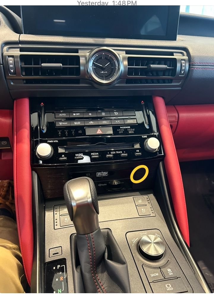

And where do you mount it? I see most folks using the right vent. Looks to me like you could also mount via a 3m disc right here. It is a dead spot.

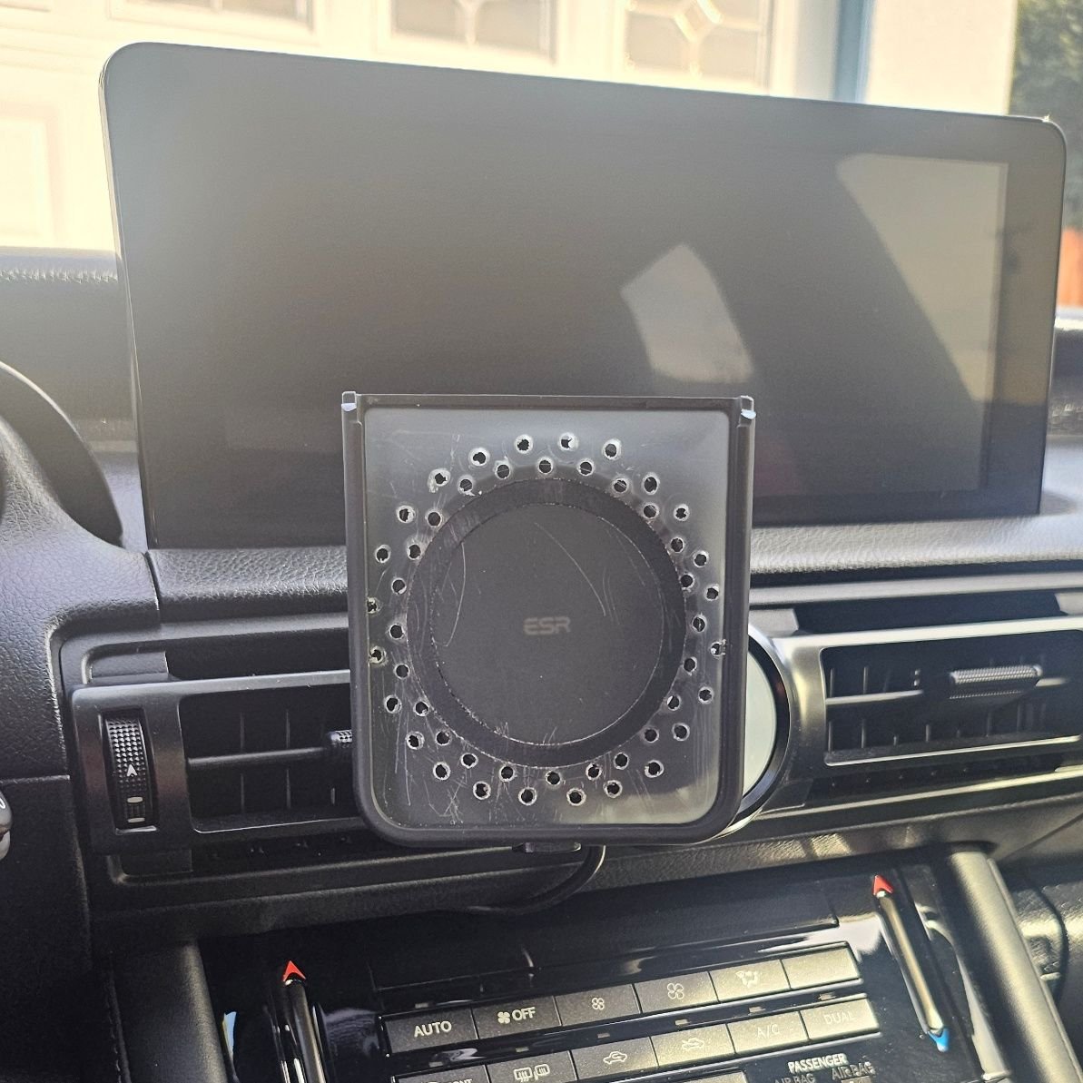

My exact setup probably won't work for you, but it may give you some ideas. I mount mine in front of the driver-side vent, preserving the passenger side vent, since I typically don't like the heat or A/C blowing directly on me and passengers often do like that. I live in Southern California, so I rarely need the heater - however I tend to have the A/C running most of the time, and that helps keep the phone cool since my mount is also a wireless charger. Here's the mount/charger on Amazon:
Amazon Amazon
Even though my phone is not an iPhone, the mount is MagSafe compatible, so I have a MagSafe compatible case for my phone always attached to it and slide my phone in when I get in. In my particular instance I only need the bottom half of the case as my phone folds, and I drilled some holes in it to help a bit with cooling. I use a 180-degree and a 90-degree USB-C adapter to keep the plug and cable mostly hidden, then removed the center console to run the cable out of sight. Underneath the dash I used a 12-volt to 5-volt adapter (powered when ignition or accessory are on) that has two USB-A outputs so I can simply plug right in with a C to A adapter. The setup is very stable and puts up with spirited driving without issue. It does, of course, bounce a tiny bit on bumpy roads, but that's difficult to avoid with this kind of mount. If you want links to all the parts I used, let me know.
Here are some pics of the visible setup (although it looks like the phone display is failing, it's not - I think that's a polarization issue between the screen and the phone I used to snap the pic)...
With phone
With phone
Without phone
Without phone
Without case
Without case
Adapters, plug, and cabling

Thanks. Yeah, I’m probably going on the right side or on that spot toward the bottom on the right.

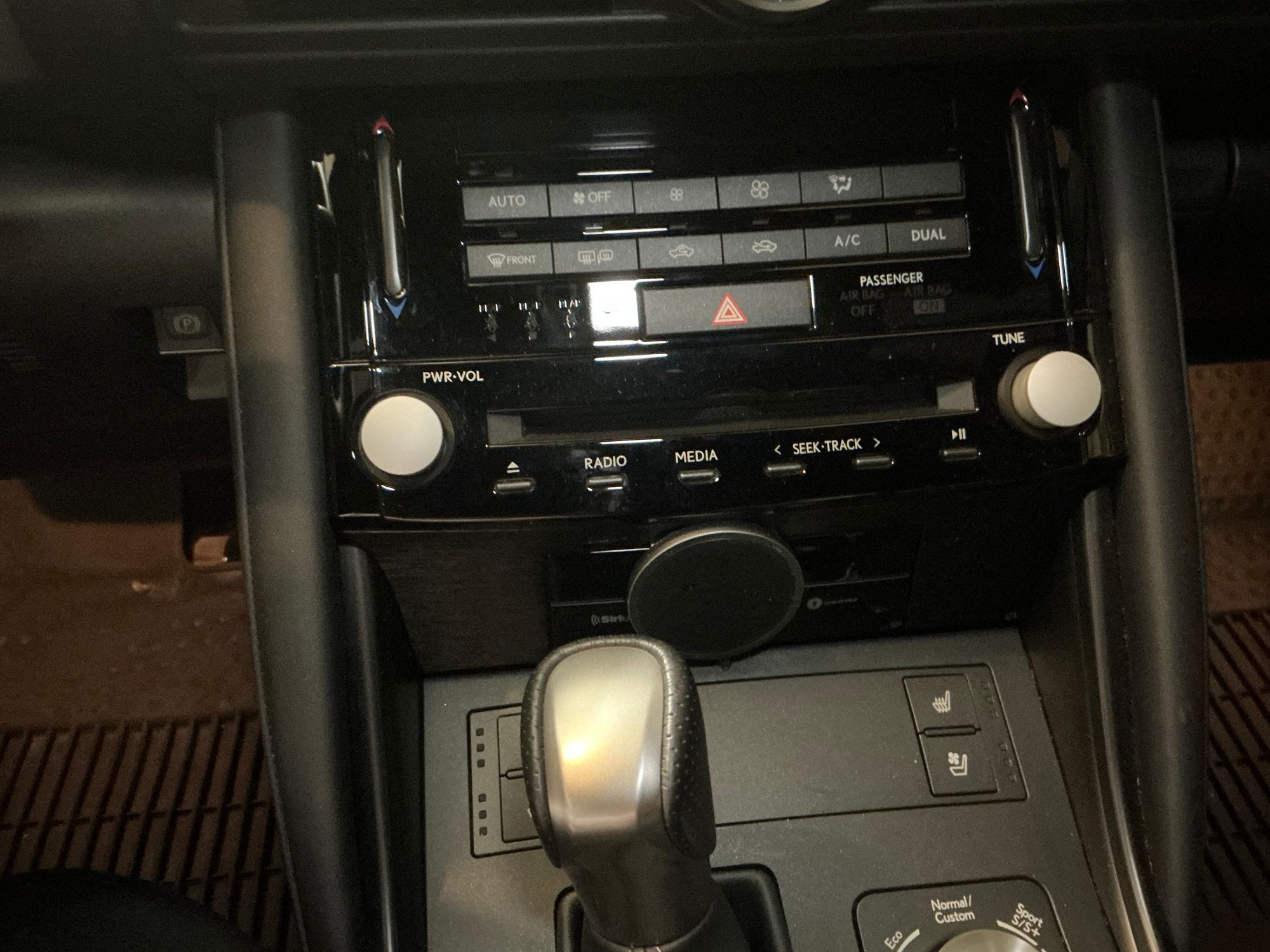

I used a basic MagSafe mount and some sticky tape. I drilled a small hole in the console right under it and ran the cable through. I ran the cable under the trim on the console and drilled a hole into the console to get to the USB. I had to cut and splice the USB cable. I can easily get to the seat heater buttons. The only thing it blocks are some logos. My standard size iPhone fits just right. Not sure it would work as well with a max phone.
