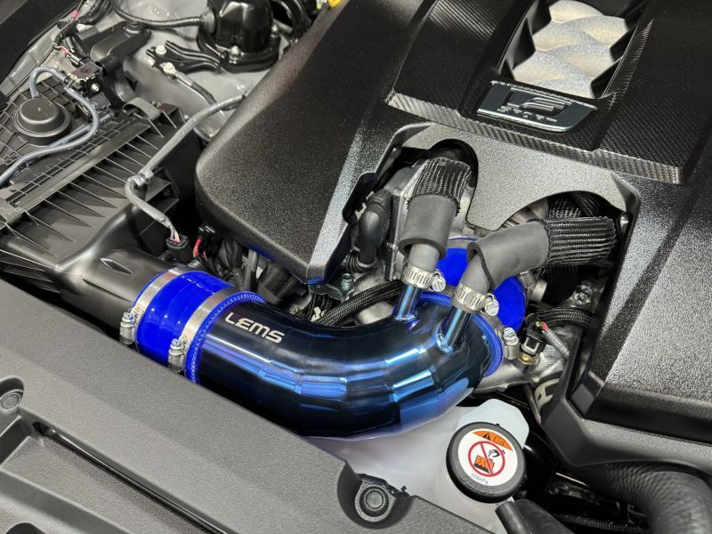

As this is just an intake tube. You can see that the hoses connect to the top of the tube unlike the the Afe intake. Also notice that the maf sensor is on the side while the aFe intake on the bottom. I'm just going off what I can see in pictures.

Just to throw my two cents in, my LEMS intake was originally for a RCF. The AFE should work fine i'm assuming. You just gotta follow the installation guide.

I think should fit due to intake tubes from lems, tom's and other brand are same between RC-F, GS-F and IS500, also someone on here installed the AEM intake which also fits RC-F, GS-F and IS500 and same part number, plus the takeda setup doesn't remove the other half of the oem intake box and there are ports for the hoses on top of the oem intake
