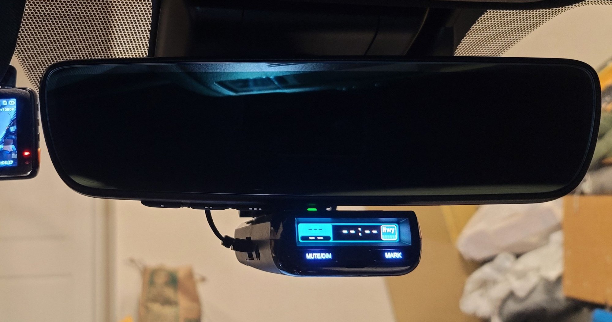

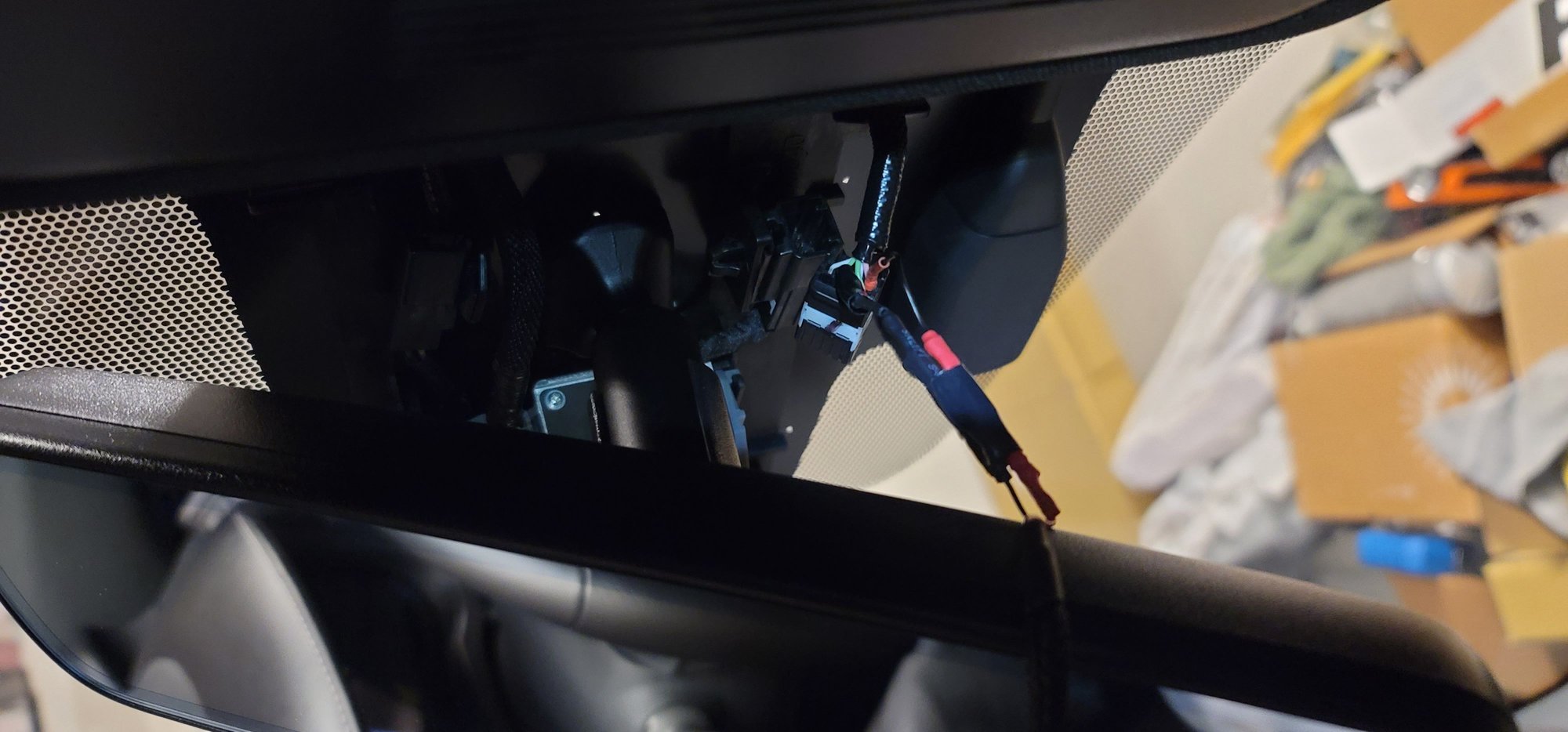

It is easy as grab 1 and just pull slide it against windshield towards the engine (towards the arrows). Then the whole thing should move little bit. Grab 2 and remove the it. Now, you can remove the whole thing. I might missed step or two. I did it like a year ago.
To tap, i didnt take good picture lol. I think i tapped 1 and 4th pins. Not too sure again. I measured voltages using multi meter.

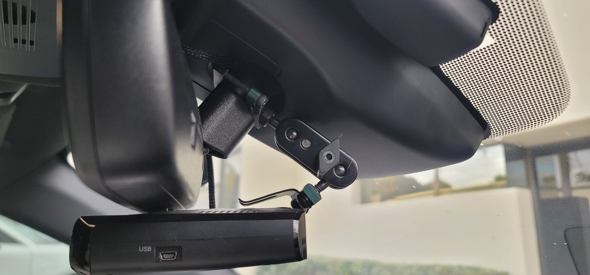

I went with a fitcamx for mine. It looks OEM and you can't really tell it's there. Regardless of camera, the rear sunshade might interfere with rear mounting so you might have to get creative. I decided to just velcro it to the plastic above my rear view mirror. Seems to be working well enough and I'll probably mount it a little more securely eventually.
I also picked up a BlendMount and mirror tap for my Radenso. If you go with the BlendMount you might want to buy a few link extensions to make sure the radar detector gets pushed forward and down far enough, especially if you go with a fitcam. I need to buy at least one more link. Other than that I'm quite happy with the setup.

I think I have a multimeter. But hopefully, I can find a pinout someplace or I assume there are instructions on how to find the proper pins using a multimeter. Otherwise, looks like a pretty easy install.

I didn't remove that. There is a small gap in between. I clipped it right behind that thing.

That works. No issue with accessing the mirror dimming button there? It so happens that I'm not a huge fan of that feature or the fact that its on by default. I typically tend to turn it off.

Here you go. It's not pretty but it worked well enough and gives a pretty good image out through the rear. I was a little worried about the little bit sticking down in front of the mirror, but I think I noticed it the first time I got in and then never again.

That feature didn't bother me. I never use that button so I put it close to the mirror but I can adjust it so that it won't block the button.

Has anyone ran the wiring of the rear dash camera to the back window? I'm having a hard time hiding the wire in the B pillar. Also the rear sunshade keeps hitting the cam too.

Yeah, I believe I ran it along the bottom of the interior instead of dealing with all the pillars. Unless you create a custom mount of the rear cam, you're going to have interference with the sunshade. My solution is to not use the sunshade.
