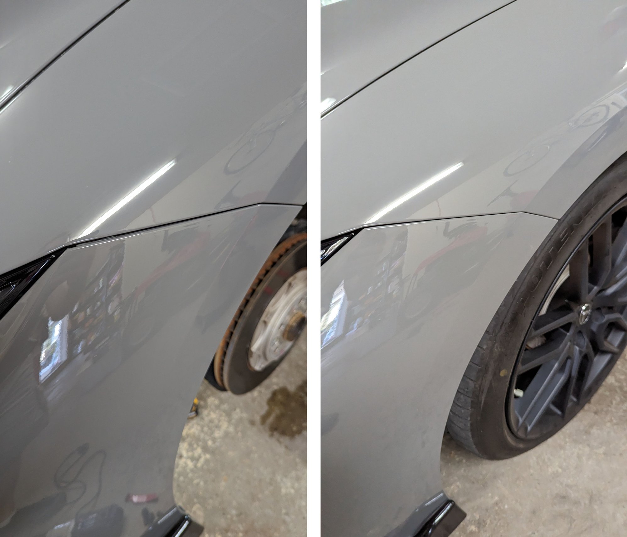

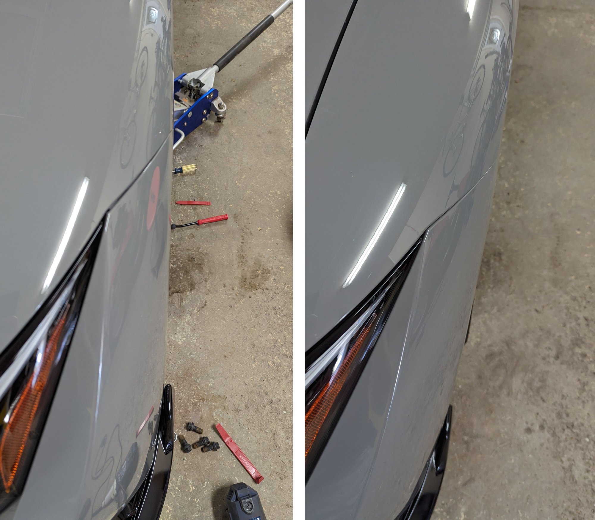

Let's start by saying that the issue wasn't ultra obnoxious on my 500 compared to other pics I saw, but I started to notice it looked to be getting a lil worse over time.
I was thinking about this trick for a lil while since I noticed that simply applying an upward motion from under the bumper closed the fender gap, then I saw a guy on FB doing it and it worked. So I decided to give it a go.

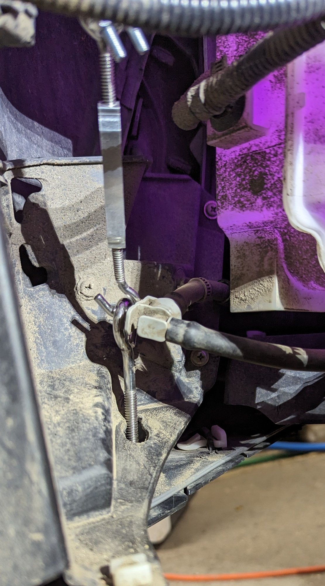

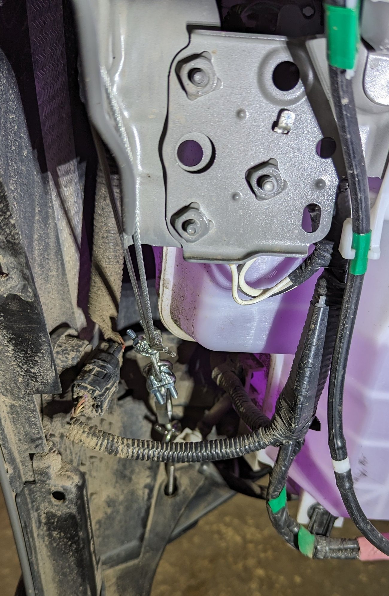

Basically, the most cumbersome part was getting that damn fender liner out of the way, once that was done, it was a matter of drilling a hole from under the bumper and fastening the lower eyelet bolt. Then threaded the metal wire thru a hole in the upper metal part, and joining both with a small turnbuckle. Only needed like 2-3 turns to make the bumper sit flush, made it a small bit tighter since I know the metal wire will get a bit of expansion.
Before / After
Here's the final product, used stainless steel hardware.
For the lower part, I sandwiched the bumper part between 1" washers, it shouldn't go anywhere. (Sorry, blurry pic)
I'll keep an eye on the gap, but for now, it's pretty much like the passenger side and i'm happy with the outcome!
