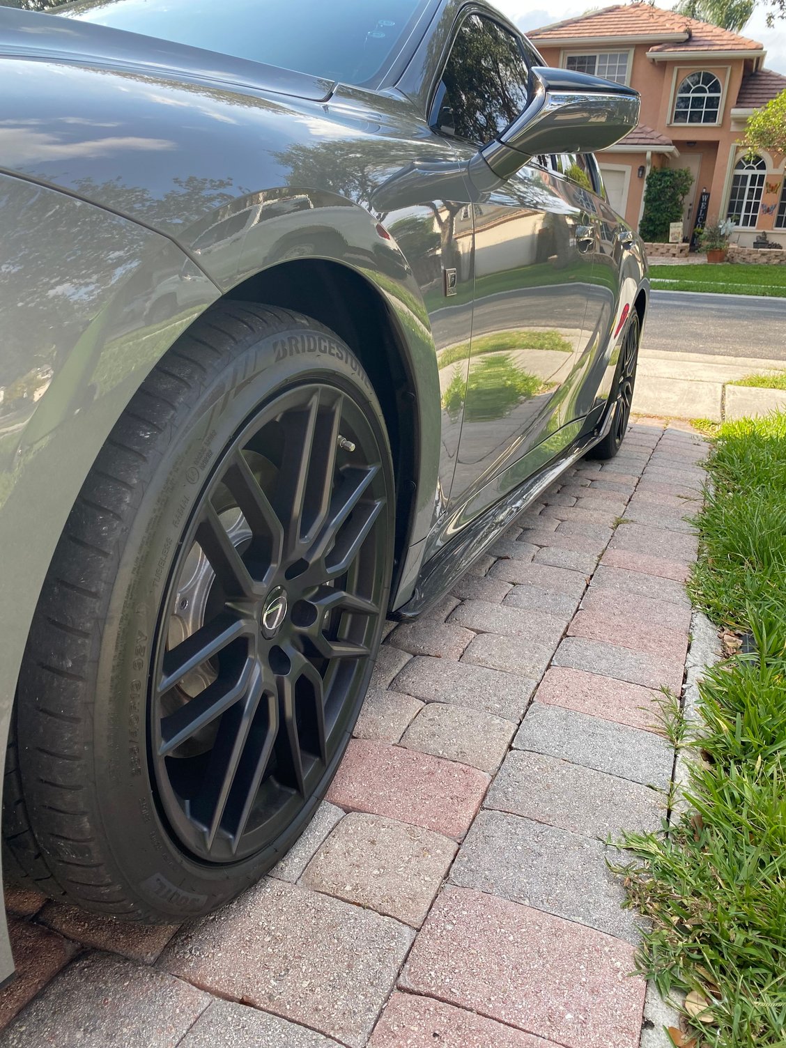

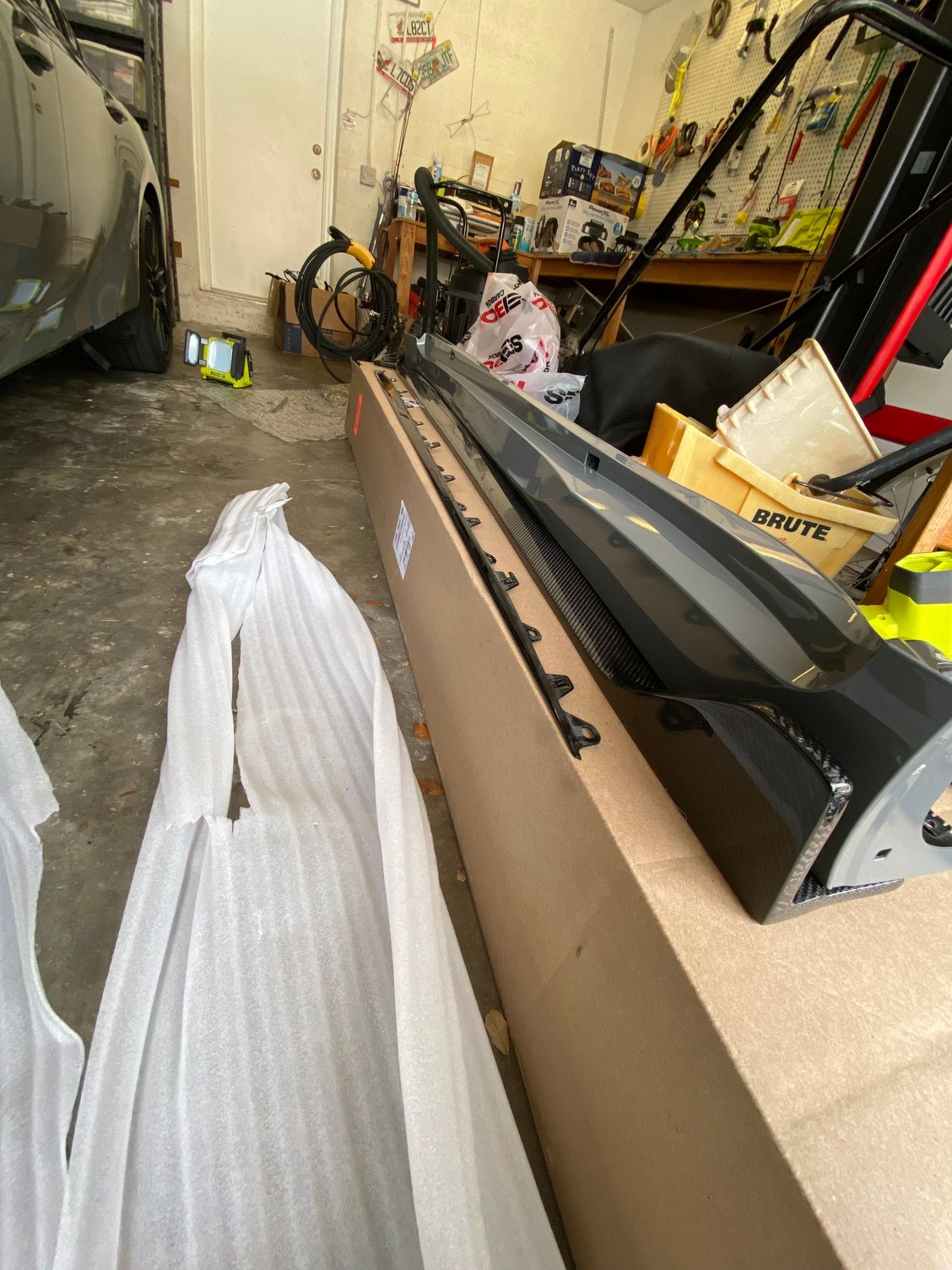

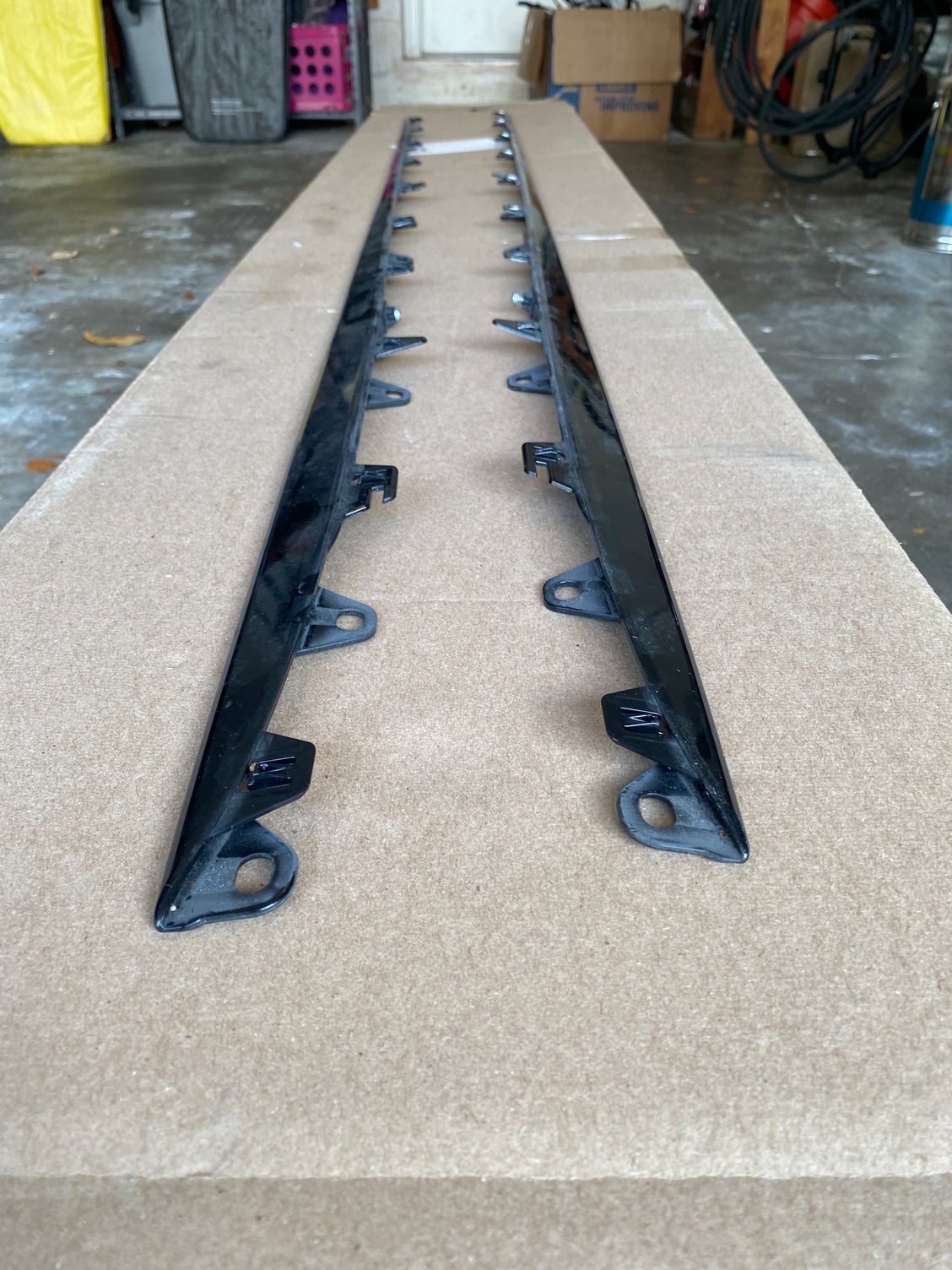

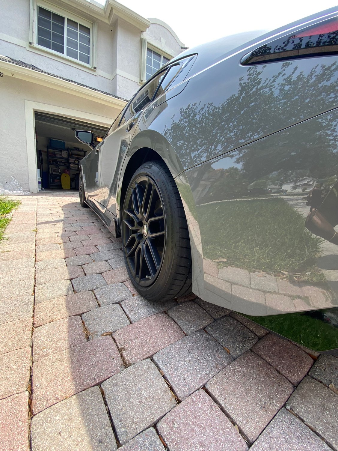

Got her done. Just needed to apply more force as there are additional plugs inside the plastic part that the side skirt is installed on that holds the entire part to the car’s body. Here are some pics:
OEM Side skirt inserts:
New Side skirts:
Installation:
On car:

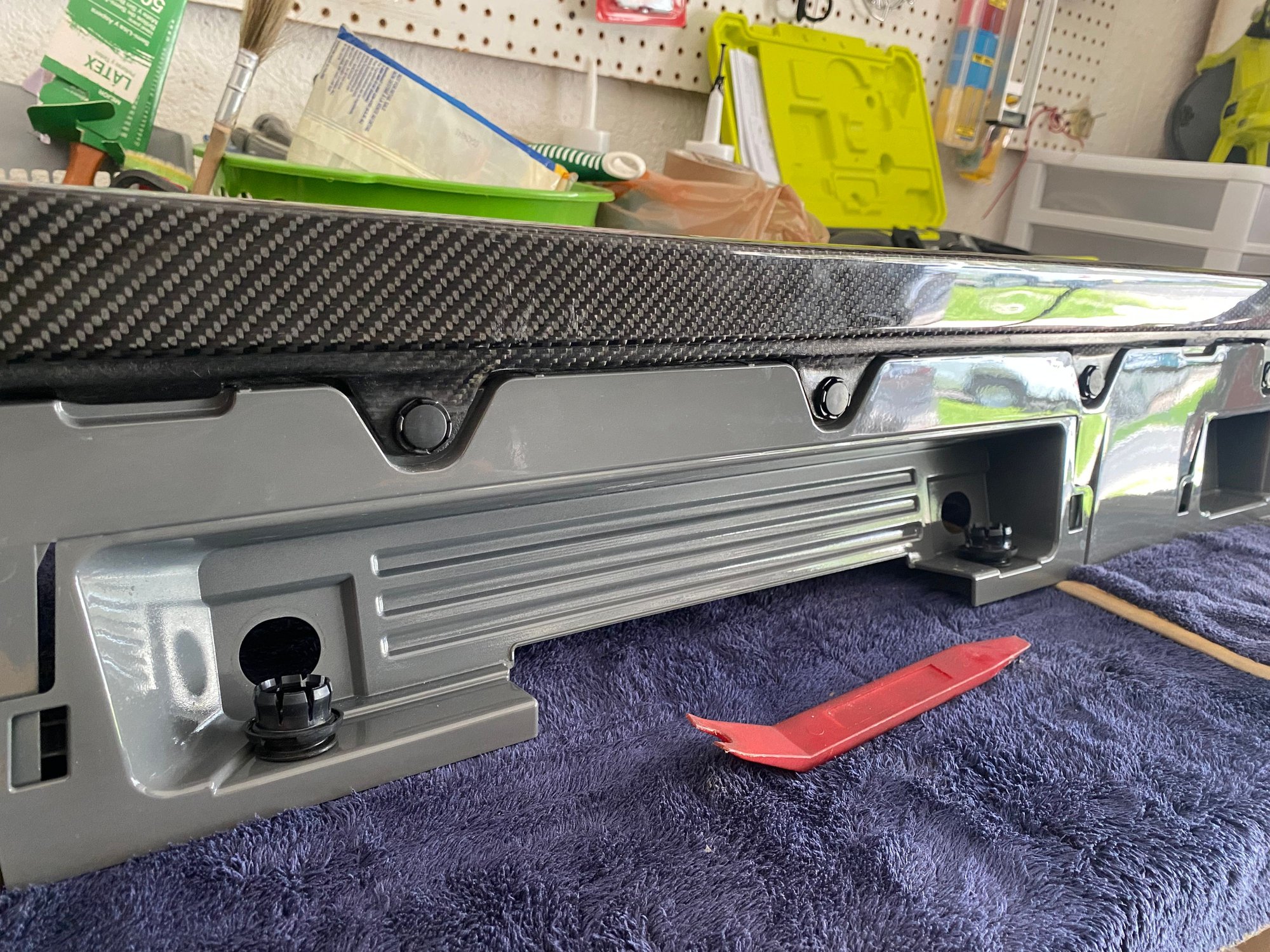

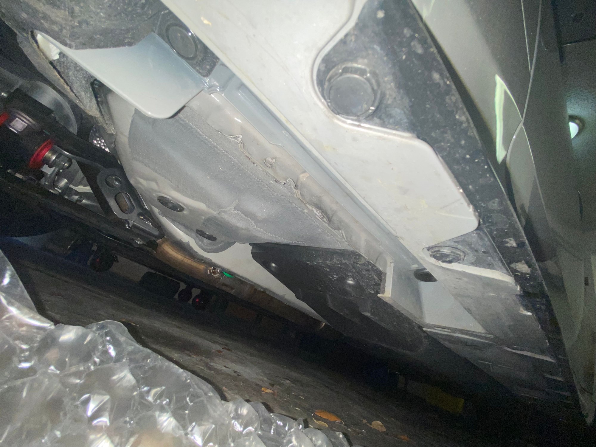

My first attempt to get the install done was a fail…I watched some of the other non IS 500 installs and I thought it was going to be simple. I removed all the plastic clips, screws hidden near the front and back doors and behind both wheels. The OEM side skirt refuses to budge. Any ideas? I will do some more research and regroup over the weekend.
Did you try using a mallet to tap it out of place?

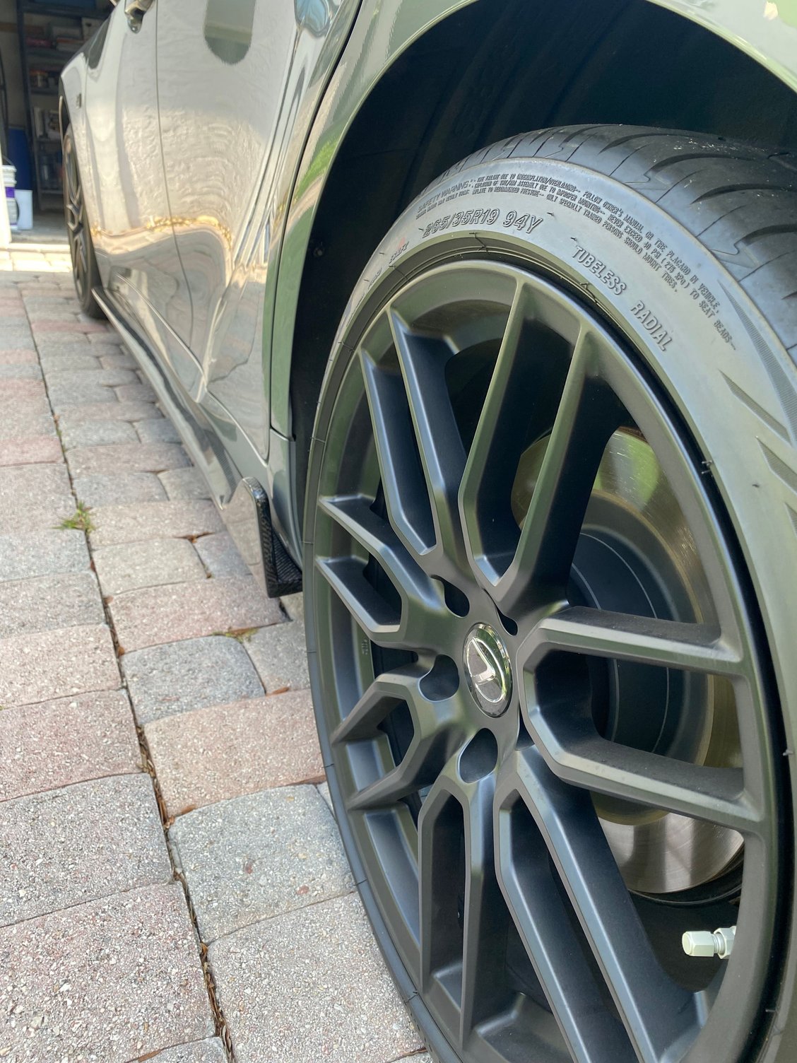

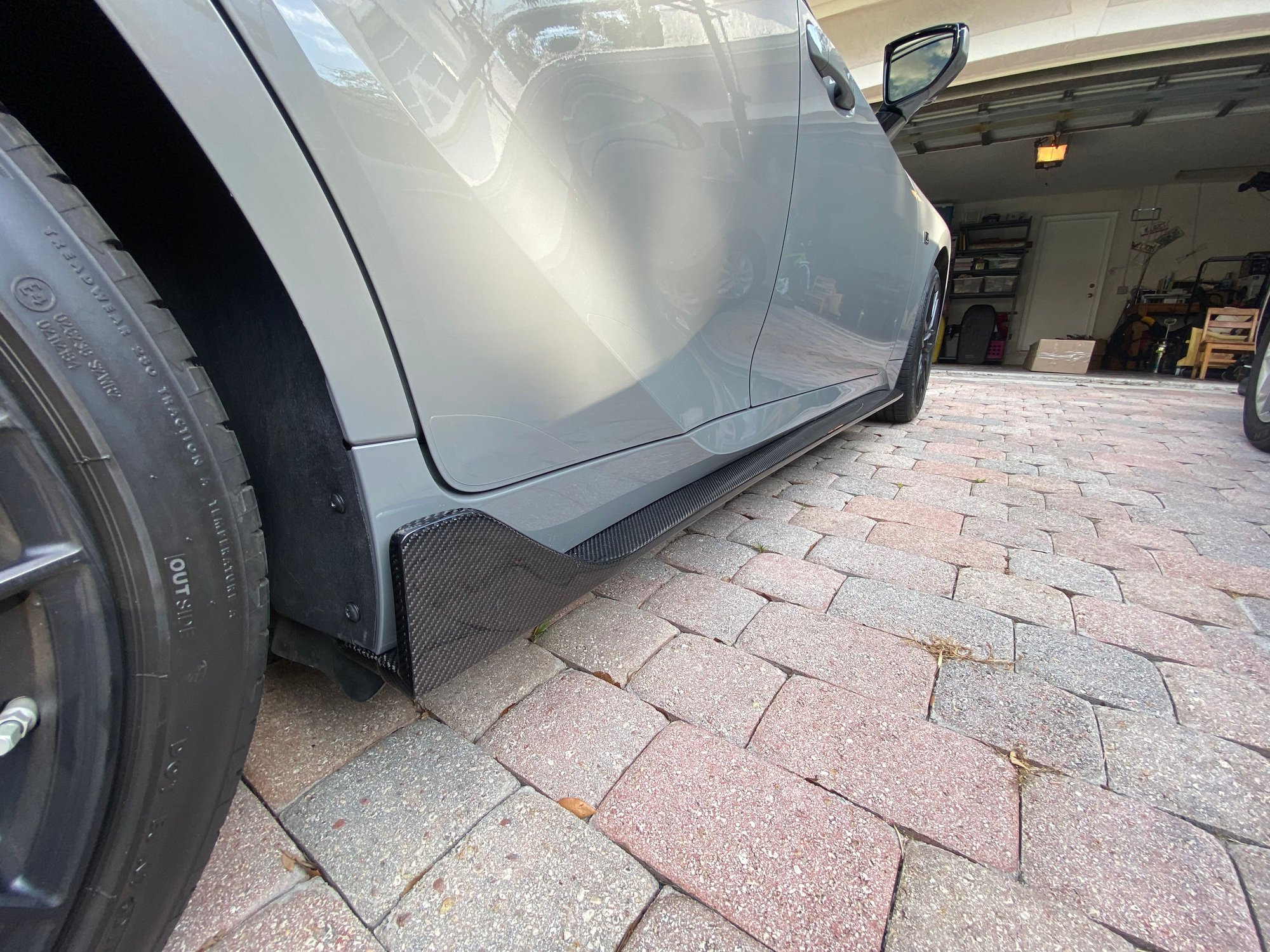

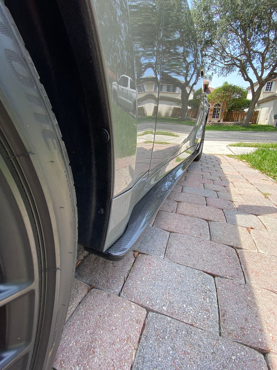

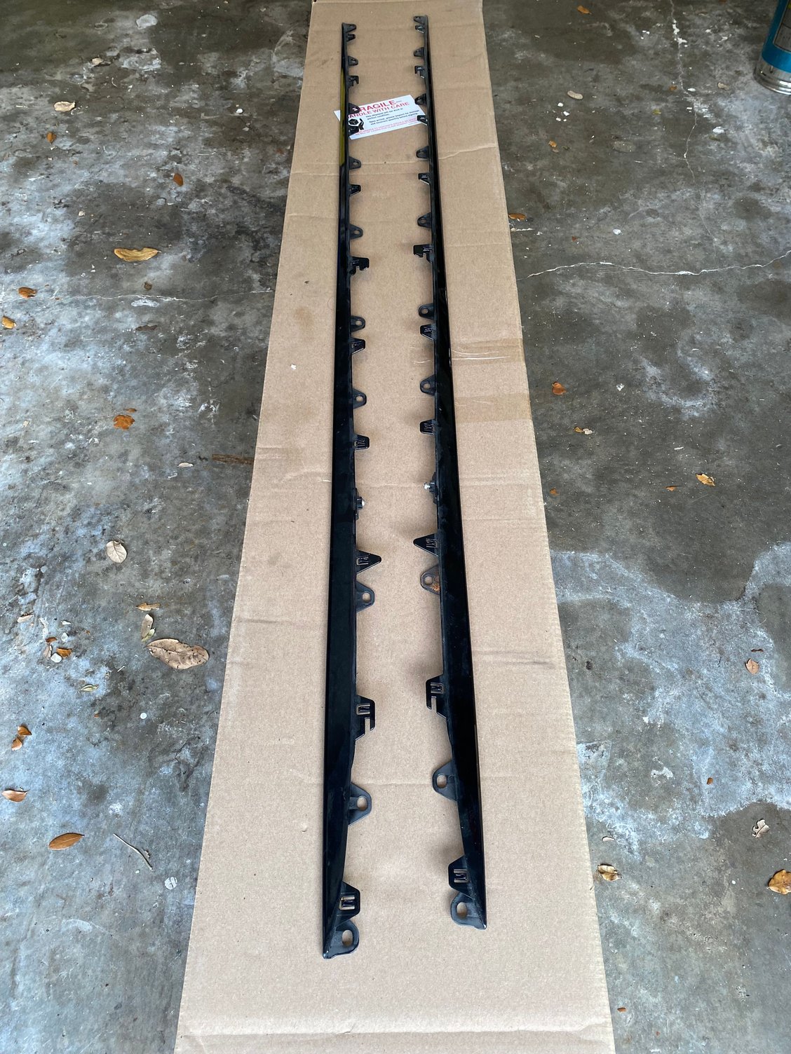

New Side skirts:
Installation:
On car:
