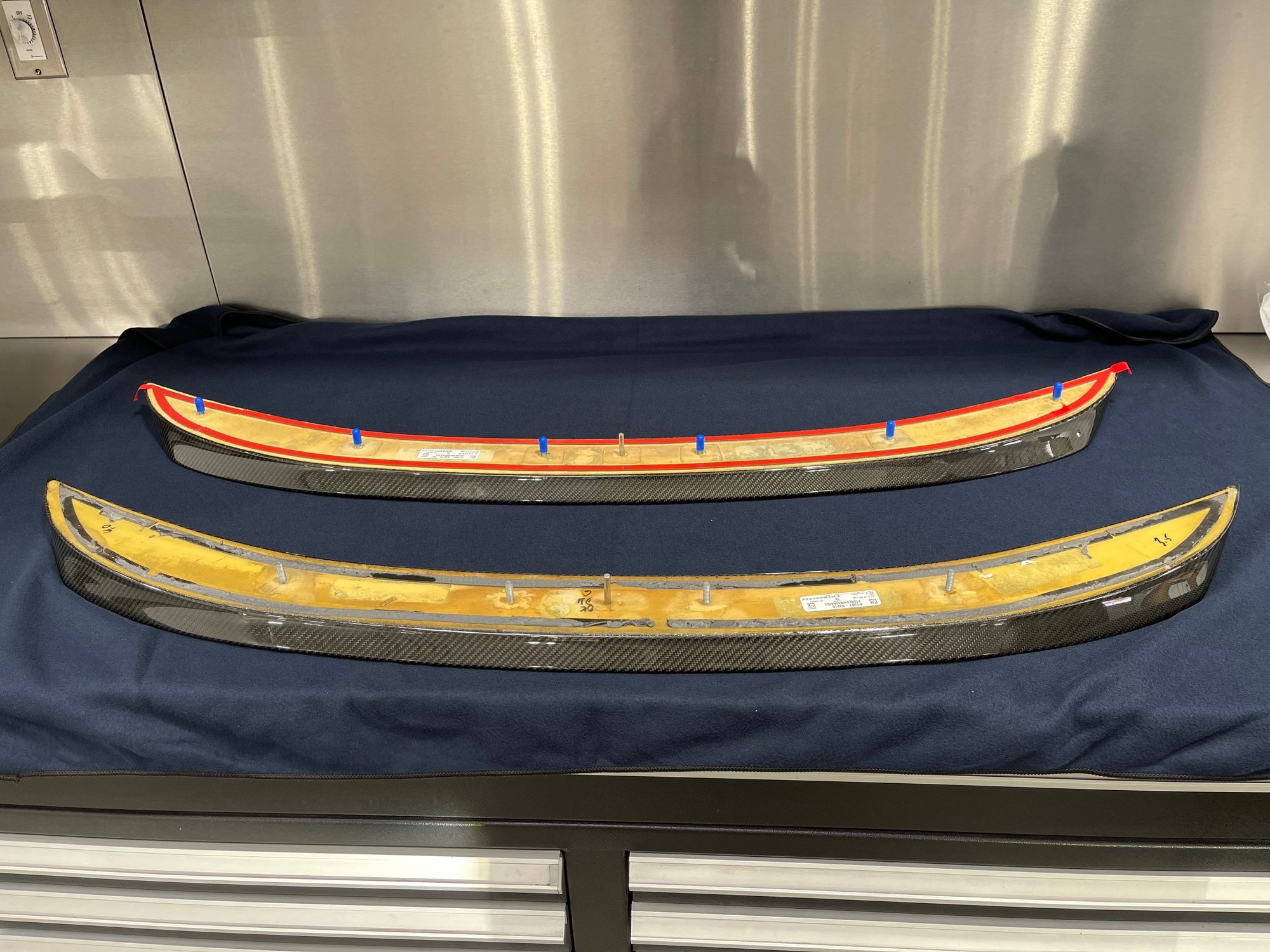

I’ve had my 2021 CF spoiler replaced twice. From my understanding it’s a common issue with the original CF spoiler. Luckily, the second replacement used a different bolt design. The original only had bolts in the center and 3M tape to the edges but after 6 months it would flare up. The second one had an updated design for the bolts on the end to prevent the annoying flare. Haven’t had any issues since! Here’s a pic for reference. Lmk if you have any questions! Good luck!
Great info, thanks!

Well, I'm finally getting this replaced under warranty. I have the new part (updated with the two extra bolts) and will be dropping the car off at the Lexus body shop next week. It took a series of dealer visits and phone calls to make this happen, but they finally agreed that a replacement is warranted.
