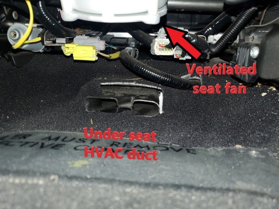

Side note: if I do remember correctly the fan for the ventilated seats is visible from the bottom and it just looks like a decent-sized fan slapped onto the bottom of the seat. Below is a picture I found showing the fan and its location so you can check.
Also, I know you already started looking at the fuses but I'd say check them all even if the fuse itself may not be directly related it doesn't hurt to check them all. It's going to be time-consuming and annoying but hopefully, it'll give you your answer. If that fails then I would tell you to check the grounds, I doubt it since bad ground would probably show signs other than just the seat heating/cooling function but you never know. I assume since the car came with the features the issue can only be either the seat or fuses UNLESS there was other damage/parts replaced without your knowledge, in that case, it's going to be tough locating the issues.

This photo would have been taken if you are in the back seat looking towards the front of the car. This is directly under the front seat so you would put your head in the rear passenger footwell and look under the front seat. I assume the passenger seat in the car wasn't affected during the accident so check that as well inorder to compare against the driver seat.
