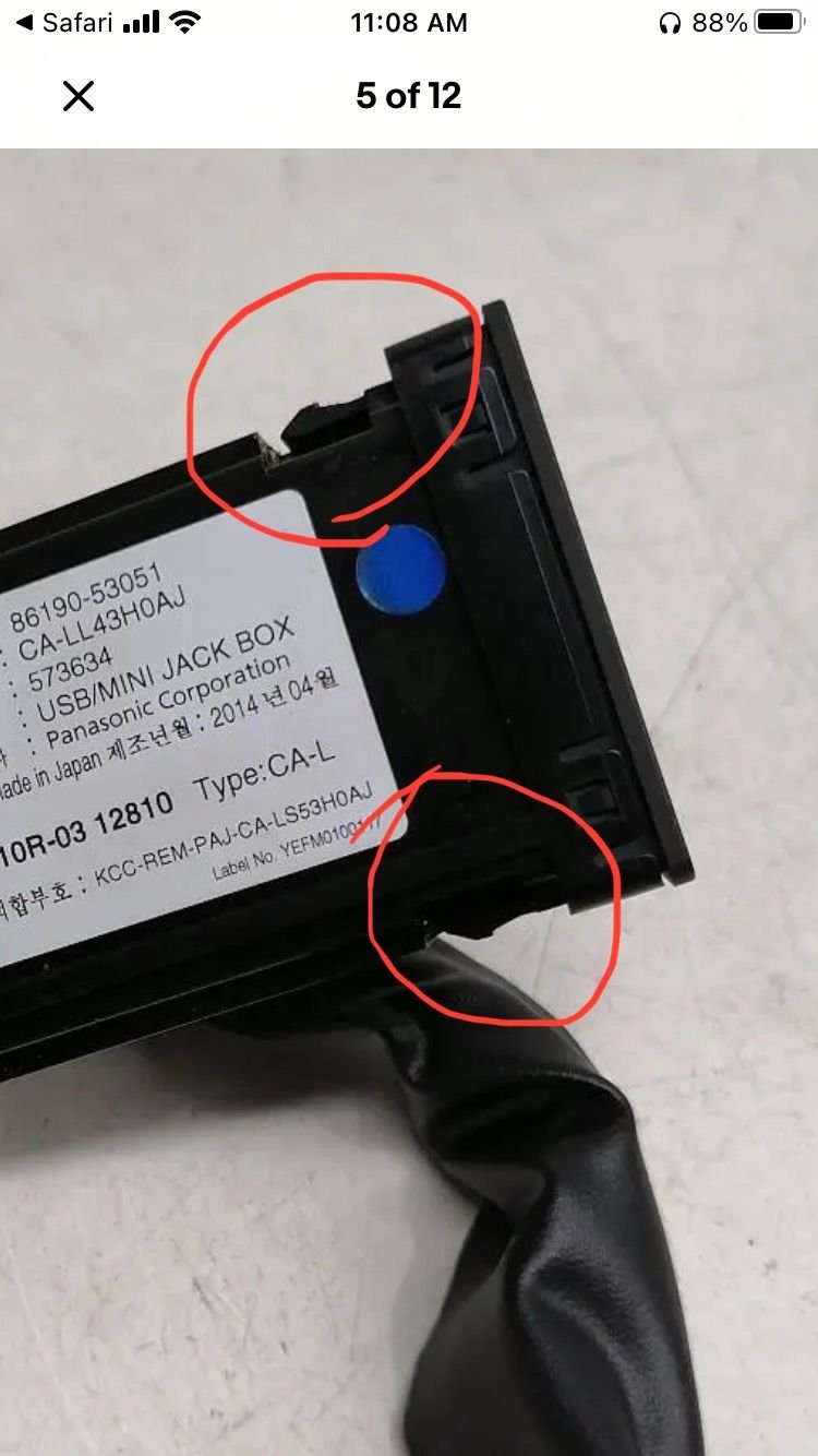

Previous poster is probably correct. I’ll bet if you look at the other photos in the listing you sent, you’ll see the tabs that need to be released, should look like these:
It’s not a big clip, you could try muscling it out, but that’s up to you.
Gonna make another guess (been modding cars a long time). Those "teeth" prob align with a plastic notch on the backside. If the notch is broken while trying to remove it from the front side , you'd run the risk of not being able to secure the new port. Just wanted to put this out there.
