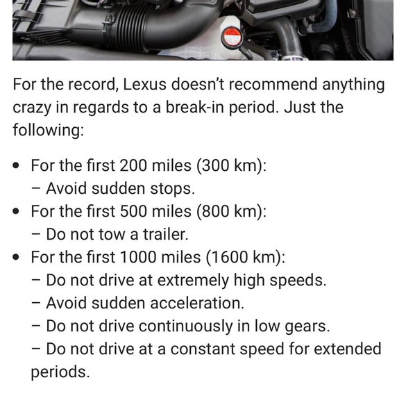

Not sure where you got this, but here's what the owner's manual states:
I avoided hard braking and full throttle for the first about 600 miles... I did get it up to like 4000 RPM a few times, but didn't go near redline before break-in was done. Also, I made sure not to cruise at super-low RPM for too long. I'd vary my speed up and down to make sure the engine was spending time in different RPM ranges.
But you'll be fine. Don't stress about it too much.
Hard to find anything concrete.
The owner's manual is either in your car from new, or we have the digital owner's manual in the car's infotainment system.
Just found it on page 121. That will teach me to read the manual on my cell lol.
Thanks!

Anyone knows the reason behind these procedures? I get the part of keeping RPM low because new engine might need to get smoothed out and rings to sit properly until they are safe to rev to redline.
For the first 621 miles (1000 km):
  1. Breaking in your new Lexus
    To extend the life of the vehicle, observing
    the following precautions is recommended: For the first 186 miles (300 km):
    Avoid sudden stops. (What is concern here? Brakes? Personally I don't consider brakes significant to warrant a proper break-in because they will be replaced in a year or 2 anyway)
    • Do not drive at extremely high speeds. (How high is extremely high, I hit 85 mph during break-in briefly. Also, what's the purpose here? Engine RPM can be relatively low at around 2.5k while speed is at 85 mph)
    • Avoid sudden acceleration. (This I think it's to keep the RPM low)
    • Do not drive continuously in low gears. (Why? Stop and go traffic it's always in low gears, so I should avoid stop and go during break-in?)
    • Do not drive at a constant speed for extended periods. (Not sure what this one's purpose is for)
Old Nov 26, 2022 | 07:40 PM
HeadShot's Avatar
HeadShot
Joined: Nov 2022
Posts: 70
Likes: 30
From: DE
No sudden stops = breaking in new brakes and rotors
No extreme high speeds = puts strain on new pistons and rings
No sudden acceleration = same as extreme high speed
Do not drive continuously in low gears = I always thought it was tied to breaking in the transmission
Do not drive at a constant speed for extended periods = allows piston rings to seat correctly
At least that's what I was taught. Maybe someone has other thoughts.
