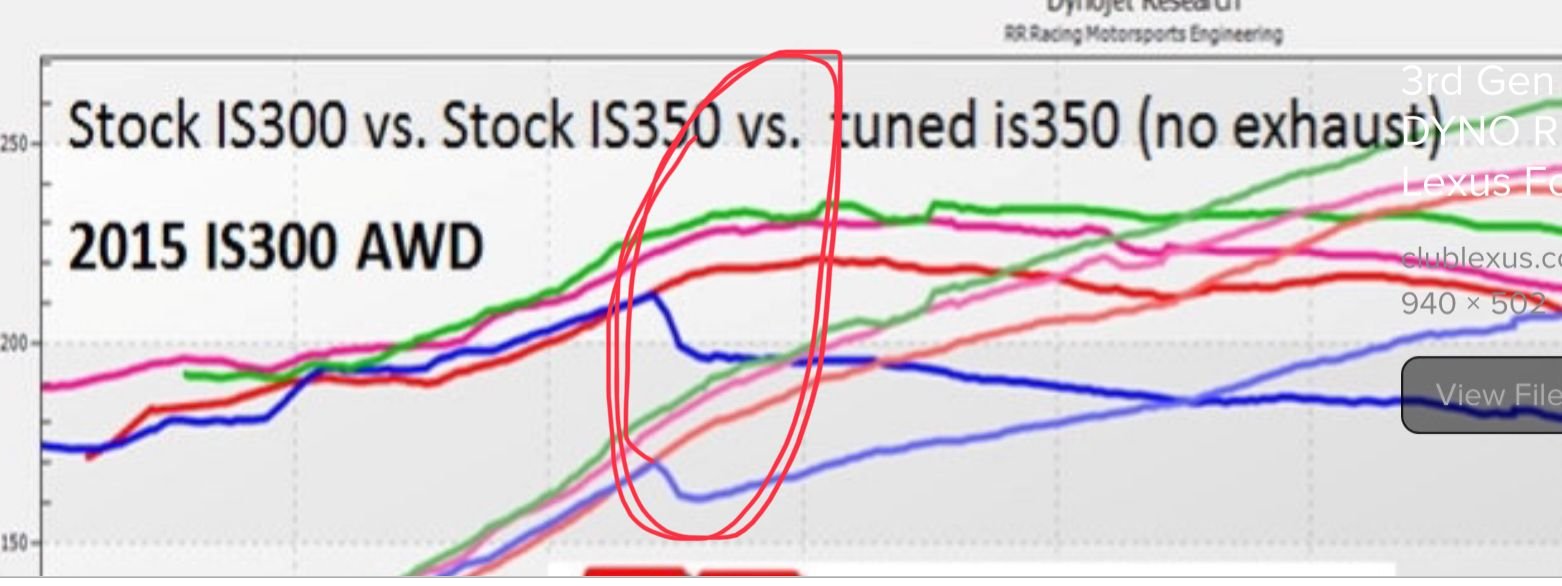

What supports this is the fact that 2015 is300 v6 has identical power/torque curves up until where that torque might become a problem after which it gets knee-capped. which is very obvious from this chart.
I've heard this theory before, but I don't buy it personally. What, do they manufacture transfer cases/ECUs/TCUs to different specifications depending whether it's a 300 AWD or 350 AWD?
I heard a theory once that engines/transmissions that can't handle the full power get sent to the 300 AWD pile instead of the 350 pile...
I'm still sticking with my theory that there's nothing mechanical separating the drivetrain of the IS 300 AWD from a 350 AWD, and it was purely a convenience choice on Lexus's part to de-tune the engine to create a new trim level. For what it's worth, I don't think your average owner would even feel that torque difference unless they knew where in the RPM range it was. When I drove a 350 AWD, I could feel it, but I already knew it was there. Honestly, the 300 AWD is pretty quick for a "base engine" car. Just tune it if you need 300+ horsepower.

However, yeah, the power difference between the 300 AWD and 350 is in the top of the powerband. Peak power is still over 6000 RPM in both cars, but the torque gets cut pretty hard just before 4500 RPM in the 300, and it never really gets back up to that level again. The 350 is allowed to continue building until it reaches peak torque around 4800-5000 RPM. If I am looking for it, I can feel that torque dip in the 300 as well as the peak in the 350 - in fact, that peak is one of my favorite things about my 350, like a reward for finding the opportunity to reach said RPM. As you said, it's a subtle difference, to the point where someone would probably say they feel the same, that is, until you get into higher gears and spend more time in that high-RPM range.
