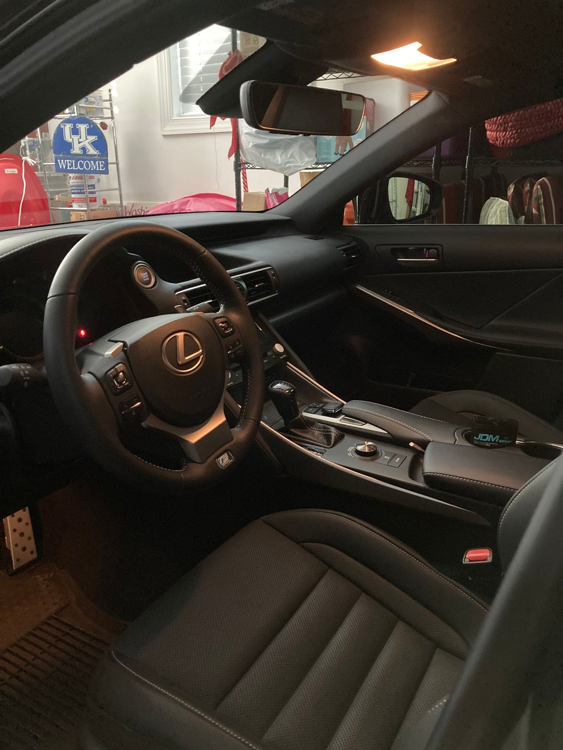

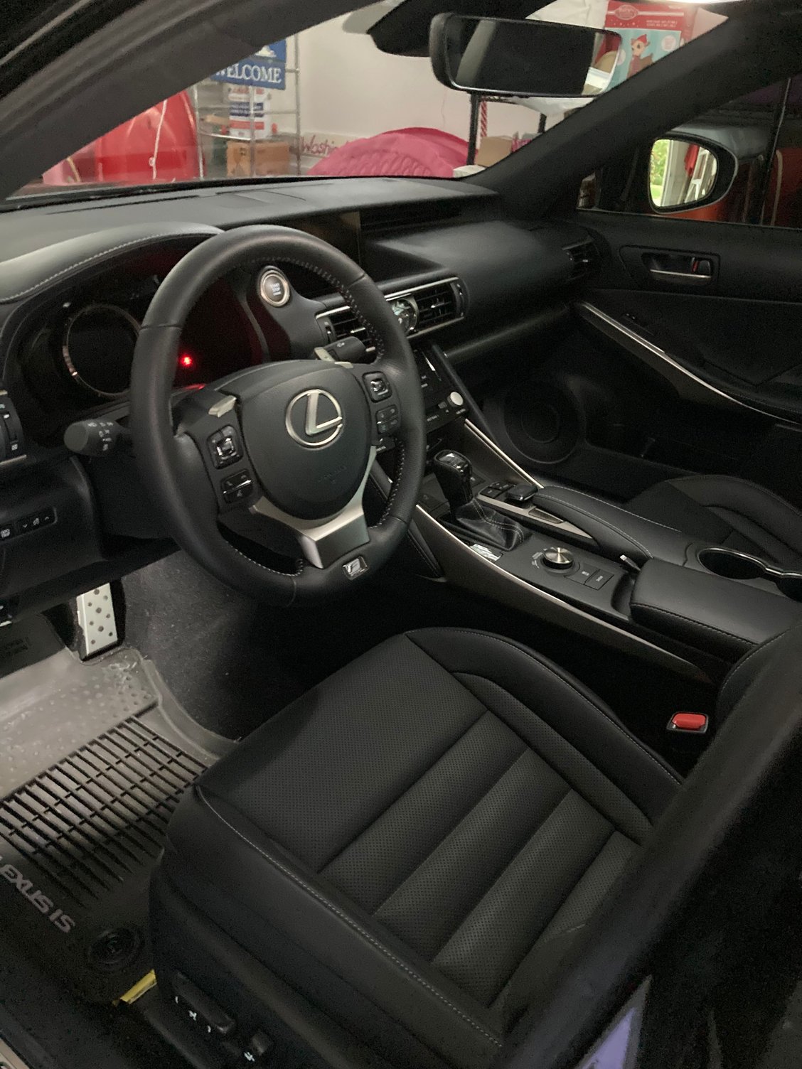

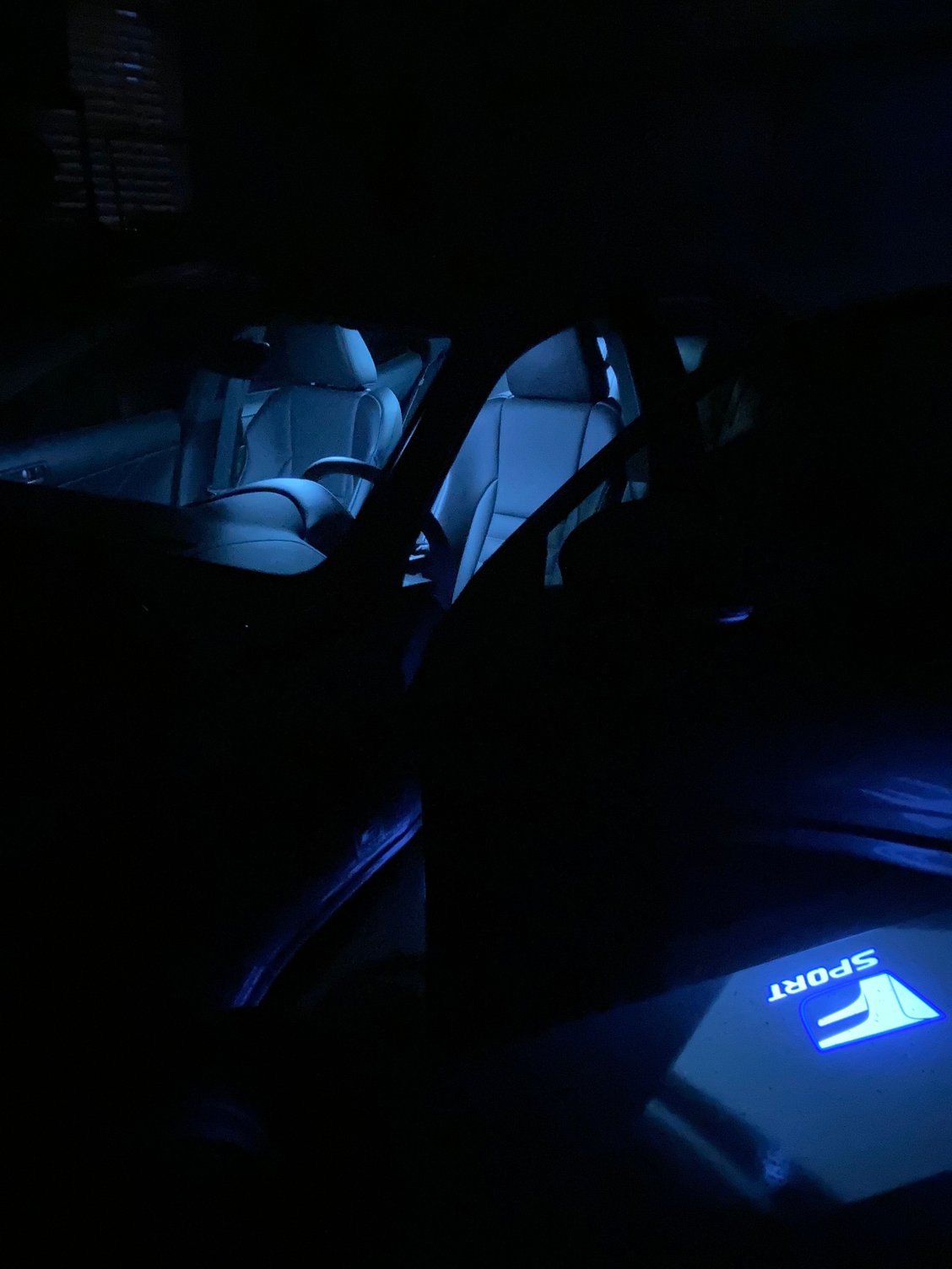

So today I had my JDM ASTARS LEDs come in so I swapped out the interior lights. I used the PrecisionLED video as a guide, but I found that my car’s passenger vanity light and door light were wired opposite than what the video stated. The guide was for all 3IS models, so I figured that everything would be the same for my 2018.
I found that my passenger vanity light wire harness actually was on the right side when the video said it should be on the left. My passenger door light wire harness was on the left side when I expected it to be at the right toward the edge of the door, per the video. Good thing I was gingerly prying out those light housings, when I realized that so I didn’t inadvertently break anything! Anyone encounter that too?
All in all, very pleased with the light conversion. Pure white light, but not blinding and offers a really nice luxury touch that should’ve come stock. Leaving the side mirror puddle lights alone… knowing my luck, I’d break each mirror lol.
LMK what you think!
Before:
After:
