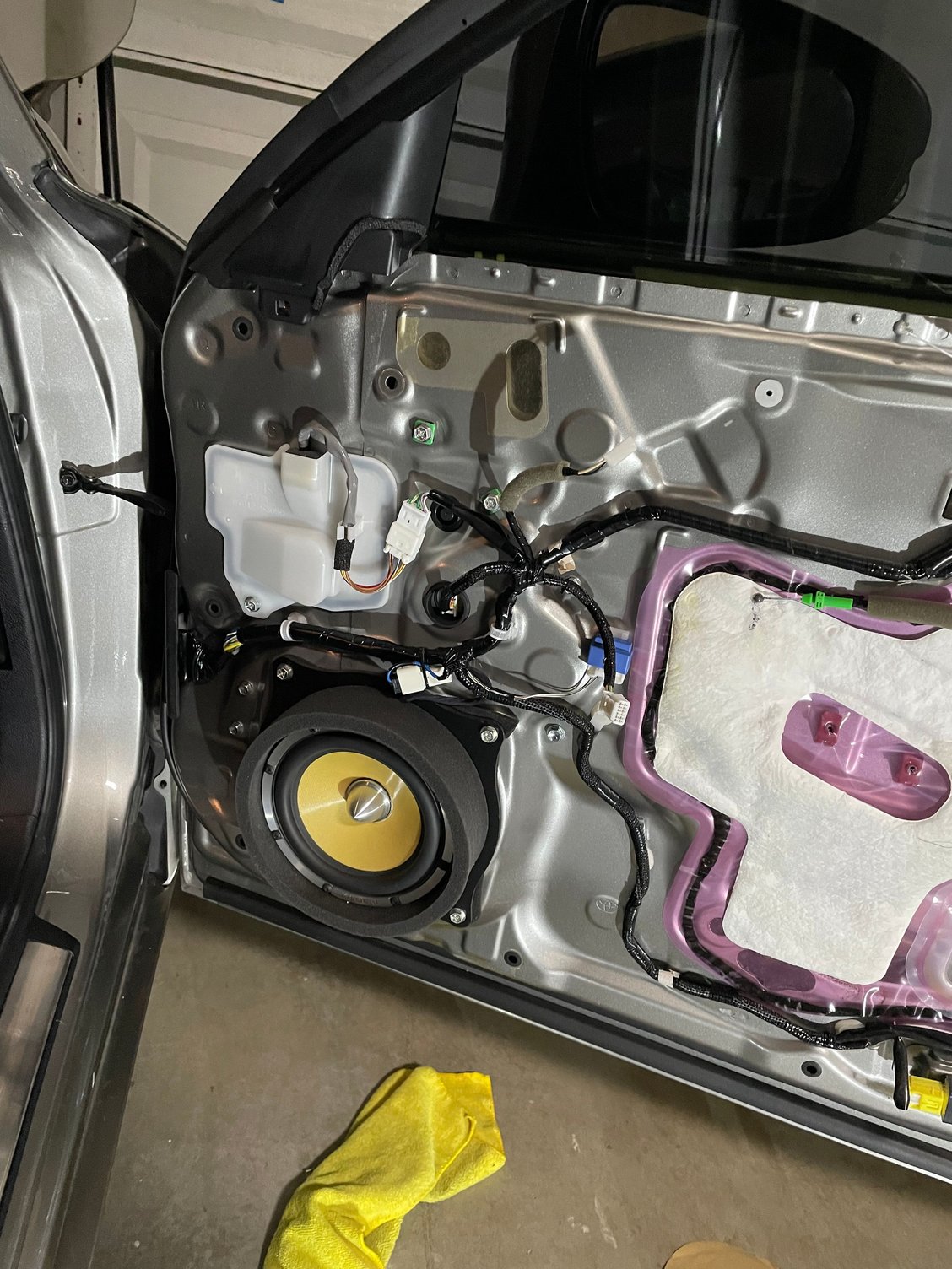

Be careful when removing and installing the door panels to not drop the panel, I had one slip, that may have been what stressed/pulled the lock cables ball end at the latch out of the plastic lever inside the latch and gave me difficulty unlocking the door afterward. I chose to replace the latch because I thought the ball snapped into the lever very loosely, I was worried it may happen again and make the door very difficult to get unlocked again, I was lucky and got it to unlock and open the 1st time it happened by rapidly cycling the unlock switch on the front door. When my door panel slipped out of my hands it pulled both cables out of the handle, maybe over stressing the cables snap in connection at the latch. That door had acted weirdly before the speaker change so I’m not positive it wasn’t already partially dislodged, it’s perfect now.
