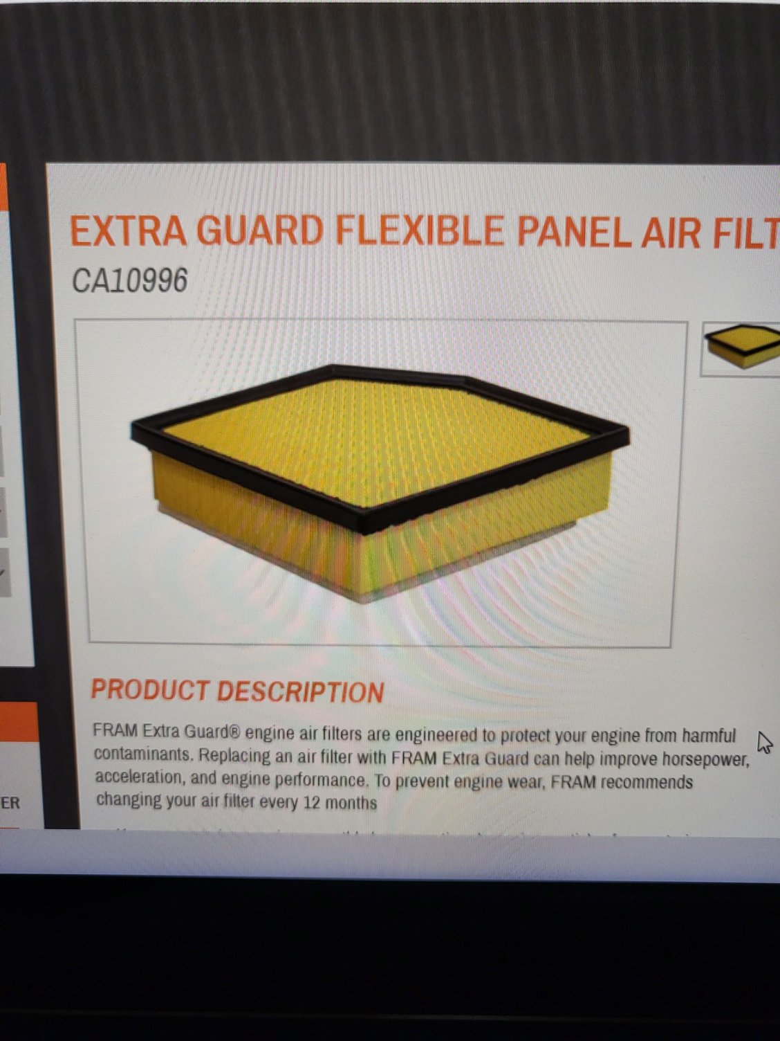

Found the culprit, switched back to the BMS intake with AEM air filter and the readings went back to normal (7-8/L/100 km).
Never putting back a Fram air filter on this car.
