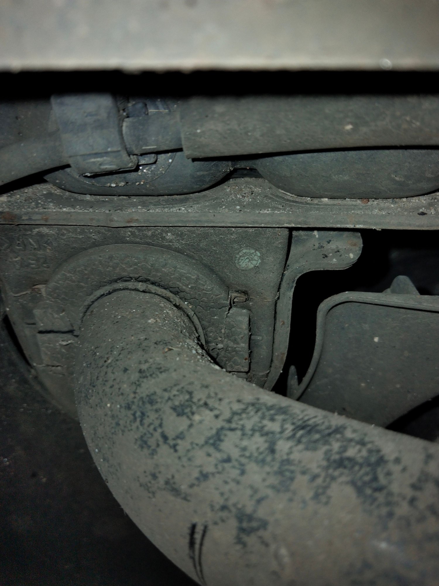

I think I have found where is from the noise (clunk, clunk..) when I turn at left at low speed.
When I removed the front end links (sway bar). The noise gone (I'm very happy to find, almost, where was from). So, I think it is about the sway bar bushing.
I took some picture but I can't see nothing worried on the bushing what do you think about it?

If you still have the end links removed, then see if you can wiggle the bar inside the bushings (left and right).
If you can wiggle the bar, then the bushing is worn and needs to be replaced.
By wiggle I mean move the bar up, down, left, right.

Ok I will try it for the front sway bar.
But I already make it for the rear bar I could move the sway bar up and down, does that mean the rear sway bar bushing are dead too?!
Does anyone know the torque spec for rear and front sway bar?

It depends how much force you're using and how much movement there is.
If the bushings are worn enough, the bar can move inside the hole of the bushings without much effort.
You could also almost reproduce the clunking sound if there is enough movement.
The key to judging the wear is if the bar can be moved without the rubber moving as well.
It's a little hard to explain without showing it at the same time.

I think I understand, for example for my car the rear bushing sway bar can move but only up and down, and slowly. In this case it s ok.
​​​​​​For the front bushing the sway bar stay stuck in the bushing It s why there is a noise, I think.

if it's a clunk, it's the end links. the bushings, while a bit dry, wouldn't cause a clunk. they'd just make your sway bar less responsive. end link ball joints probably are loose or have play (worn) they need to be really tight (hard to do by hand/feel) or they'll clunk. anyone lower your car before or touch it?
