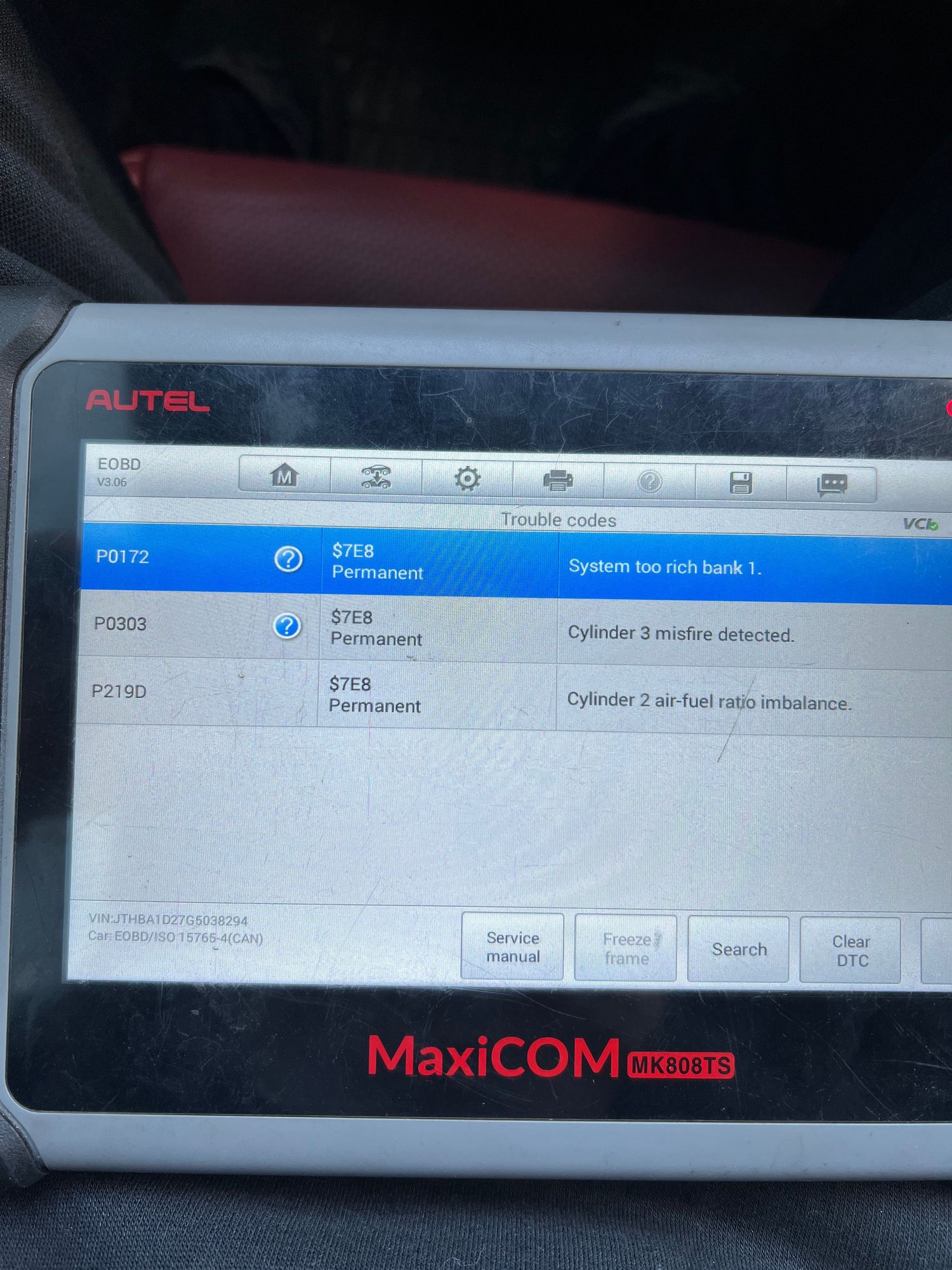

Hey there, I am currently having some trouble trying to figure out what's wrong with my car. As the title states I encounter a code P219D (air-fuel ratio imbalance in cylinder 2). My car is currently running rich and I have a negative long term fuel trim. It sometimes has trouble starting. I am leaning towards a faulty fuel injector, any ideas?

Certainly it could be an injector, but the question is, which one on cylinder #2? The Port injector or the Direct Injector?
When you said it has trouble starting, what is the starting issue exactly? Extended cranking time? Rough Idle once started? Can you see a puff of black smoke out the tailpipe when it first starts when it gives you trouble starting?
What's the mileage on the car?
Have spark plugs been changed?
Any mods on the car, specifically under the hood?
No one has reported that code on this forum, so it's likely a one-off issue with your vehicle only.
I'd start with the easy stuff before tackling the injectors.

I'm not too quite sure about which one on cylinder #2, but I believe it would be the Direct Injector.
And yes I do mean extended cranking time and rough idle once started. There is no puff of black smoke out of the tailpipe.
The current mileage on the car is 68400, I have changed the spark plugs (100 miles ago) when these symptoms arise.
The are no mods under the hood.
Things I have done so far are:
GDI Service, Fuel Cleaner, Spark Plugs, Coils checked, Cleaned the MAF Sensors.

Based on your pic you have a Cylinder 3 misfire and a Cylinder 2 Imbalance...and a system too rich...wow, that's more than just the one code.
I've attached a service bulletin I found on the Canadian side...two of the three codes you have are mentioned in the bulletin.
It's not gonna help you fix it, but maybe the dealer will goodwill the repair since you're just out of warranty.

Ok...where do I even start with the information in the invoice.
First, I can appreciate that the tech is not required, nor has the time, to type in an entire novel as to what they checked.
I can also appreciate that without the codes, they can't apply the TSB because then it looks like warranty fraud because they are fixing something that technically isn't a problem.
So...assuming the techs observation of the fuel pressure dropping after 45 minutes is accurate (imagine my eyes rolling to the back of head)...it leaves the question of how he determined ALL 8 injectors are leaking.
If I saw pressure dropping in BOTH the direct and port fuel lines, then my first thought would be the Fuel Pressure Regulator in the fuel pump assembly.
There is a global drop of pressure in the entire fuel system...the obvious conclusion is the regulator is leaking pressure back into the tank as it regulates the pressure for both the direct and port injection systems.
If all 8 injectors are leaking, that's really easy to confirm...let them leak for 45 minutes as per the invoice, and without starting the car, remove all 4 spark plugs and use a borescope to look into all 4 cylinders. If the fuel did really leak out of the injectors, you would have raw gas sitting on top of each piston.
You would get a long crank to start and a rough idle as well as black smoke out the tailpipe (that's the raw gas).
I'm assuming there are no external fuel leaks...as those would be obvious.
Also the low pressure reading of 33PSI is technically within spec...it is concerning it dropped from 70 to 33, but the minimum spec is 28PSI...soooooo
Man...I don't even know what else to tell ya...this looks like a dumpster fire of a diagnosis.
And imagine if the injectors were all actually leaking...the car would drive like absolute garbage cause the cylinders would be constantly bombarded with raw liquid gas...not to mention it would try to stall at every stop sign and red light.
