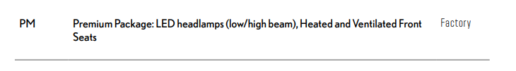

Just looking at them like arentz07 posted is the fastest and easiest way, but figured I'd mention this site anyways since you can check the full spec sheet of your car for any similar future refence questions you may have about what is equipped on your car.
You can go to drivers.lexus.com and to to "Manage Garage --> manage this vehicle --> Vehicle specification --> download full specs" and look up your vehicle spec's. If this is your first time using this site then you create an account and add your vin # to your garage. You can also view your service history on this site.
I also have a non F Sport, but I have the LED headlights as added option on mine. If you have them it will show like this:

Okay, so I have LEDs, thanks! So that brings the questions, are the bulbs serviceable, and if so, brighter aftermarket units available?
