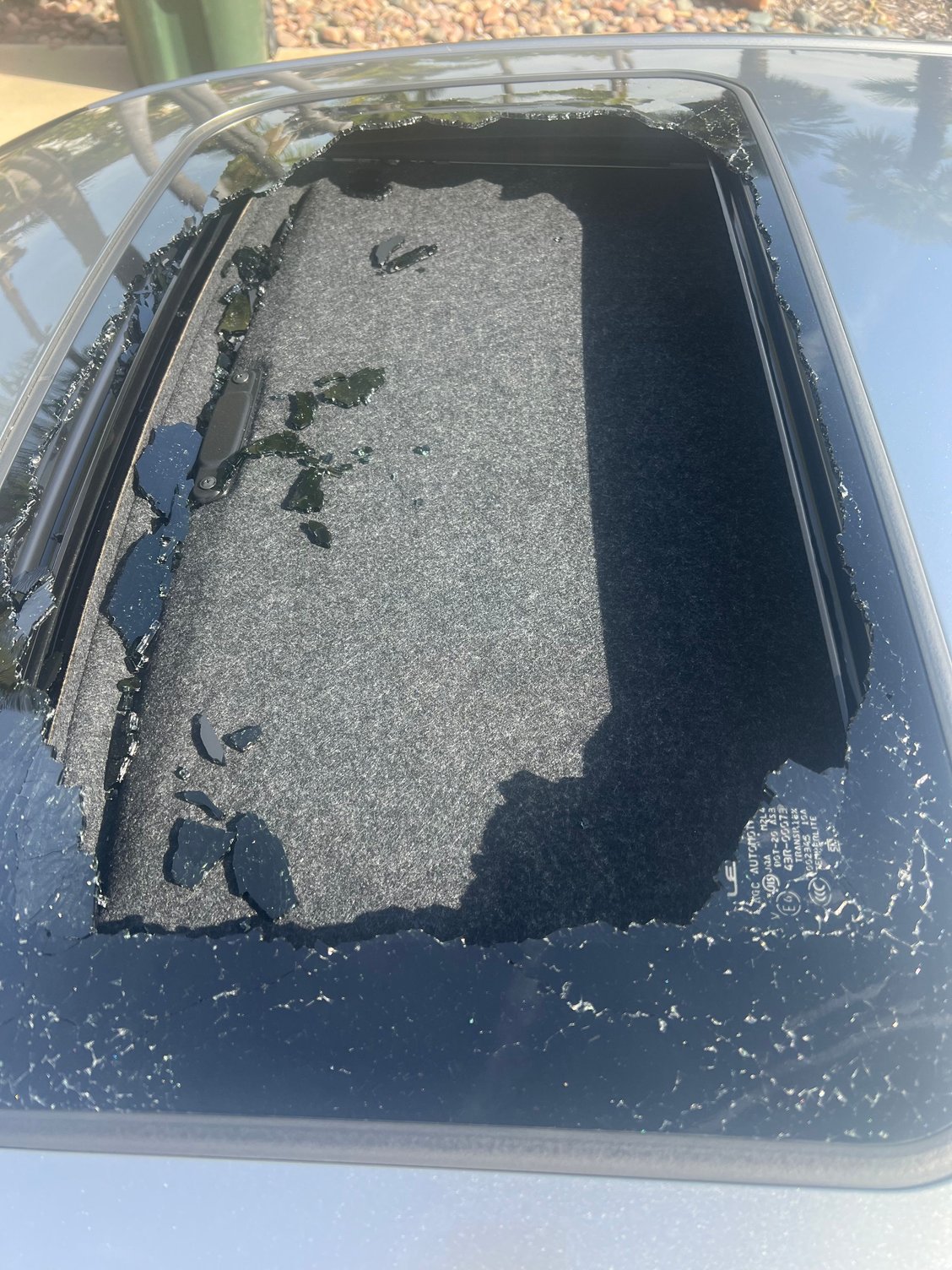

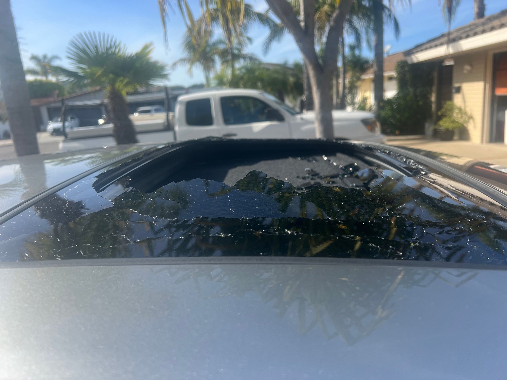

Glad you are OK! Today my 2021 Lexus IS 350 F Sport sunroof shattered and exploded while I was driving on the highway at normal speeds. No sign of a rock or object, I wasn’t driving under an underpass! Just a very loud explosion and then I could hear wind from above, which then told me my sunroof shattered. I reported to NHTSA. It is currently at the Lexus dealer under evaluation, to determine if it’s covered under my warranty. I also filed a claim with my insurance. This is more prevalent than I thought! Definitely think it’s due to defective tempered glass?
100%. Properly tempered glass can take fairly large stones and not shatter, you can even chip them without complete failure. My next door neighbour has a Sienna with a chip in the rear glass (it's pretty big) it didn't shatter.
