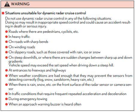

Situations unsuitable for dynamic radar cruise control Do not use dynamic radar cruise control in any of the following situations.
Doing so may result in control of the vehicle being lost and could cause an accident
resulting in death or serious injury.
- In heavy traffic.
http://www.lexomans.com/manguide-476.html

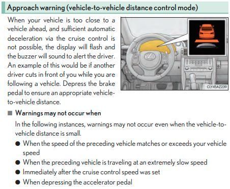

Radar cruise control will detect and track a MOVING vehicle. It will NOT detect a stationary object or one that is moving very slowly. Note the first two lines from the owner's manual paragraph attached.

Because it was a moving object when the radar detected it, it was able to track it to a stop. But it will not "lock on" to an already stationary vehicle if you are approaching it at speed.
