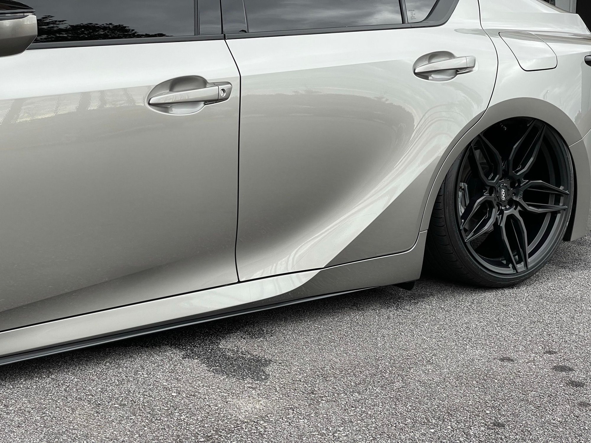

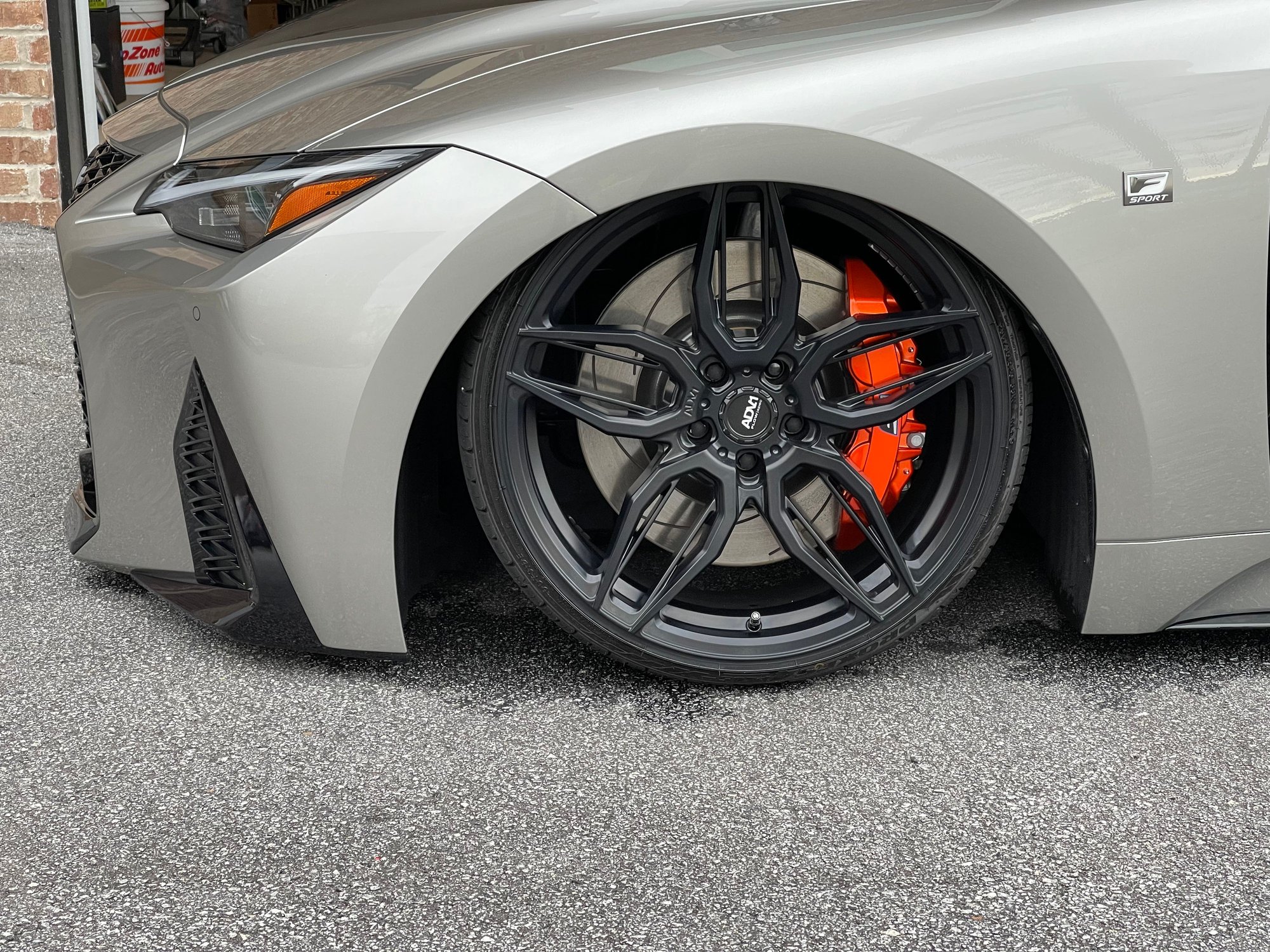

I’ll leave this right here

Originally Posted by Sasnuke
I think you want this thread: https://www.clublexus.com/forums/is-...usive-166.html
As cool as your pics are, they actually don't add any value to this thread...no specs of the wheels in the pics and no mention of the specs of the stock wheels...which is what the thread is actually focused on.
Or am I missing something?
Oh im sorry.. here's value to your thread....
stock are +45 front and +60 rear for stocks
aftermarket are 20x9 +35 and 20x10.5 +45
enjoy... and i hope that helps as far as clearance...
added bonus.. tire size
275/30/20 rear
and 235/30/20
275/30/20 rear
and 235/30/20
That's what I'm talking about...thanks for all the info...I'm sure it will be valuable to the OP when selecting wheels.
Any issues with the vehicle based on the difference in tire sizes front to rear?
The rear is 4 sizes larger...i can see an AWD IS having issues with this...warning messages can pop with rear tires even 2 sizes larger.
no issues no rubbing whatsoever. Airs out completely fine. I even put a 5mm spacer up front just to check clearance to push that offset to +30 and it was still good. So you may be able to get away with a 20x9.5 up front on a +35
