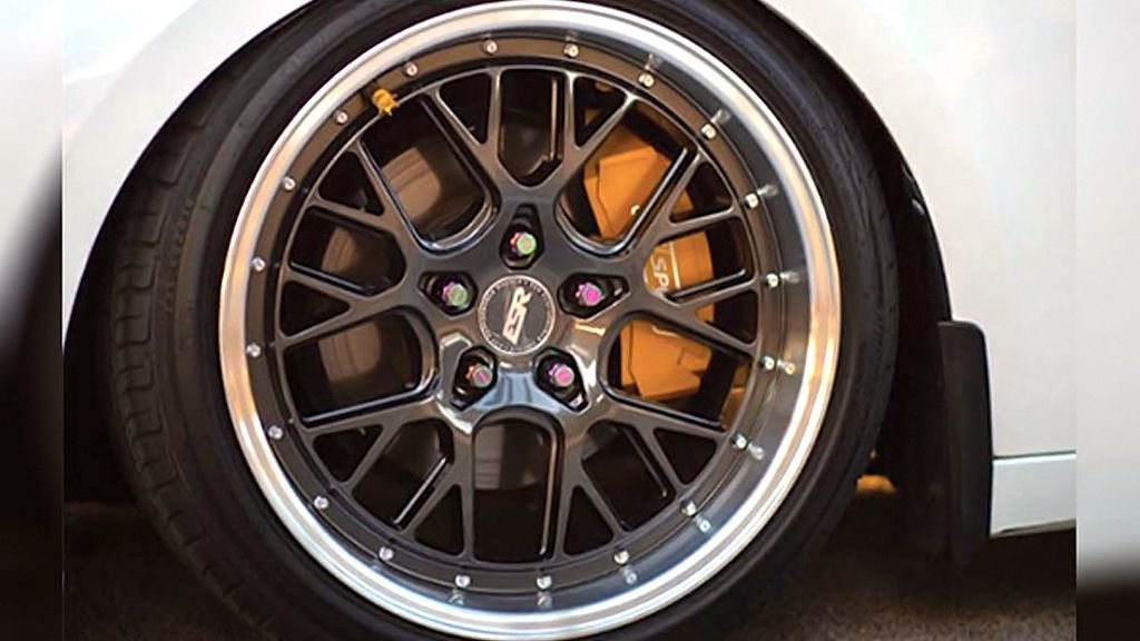

Originally Posted by Sasnuke
This is the rim specs for the vehicle in the pic: 18x9.5/10.5 +22 (EDIT: It can be found on ESR's Facebook page, unfortunately the link is not working)
I'm not sure what the tire sizes are, but something struck me as odd about the pic...the front calipers. At first glance it looks like it has the big calipers found on the IS200t/IS300/IS350...but upon a closer look the caliper doesn't look right.
I almost think this is an IS250 with some kind of caliper cover on it for appearance purposes.
It looks like an IS200t/300/350...but is it really.
If this was an IS250 then the rims would have a much easier time of fitting as the 250 front brakes have small floating calipers.
You can tell the rear tire is stretched for sure in the original pic posted above as it looks like the fender is covering/sitting on half the sidewall near the top, towards the back.
ESR does state you can contact them for fitment info...maybe give it a shot and see what they say.
Also the rear wheel looks like it's cambered a little, like it has a camber kit....trying to make the wheel tuck.
How do you know if tires are stretched? good question...for an ideal and safe fitment the rim width should be approx. 90% (+/- 5%) of the tire tread width.
Example: if you want to run a 9.5 inch (241mm) rim (the width), then the tire sizing would have a range of 245mm to 275mm tread width...the ideal fitment would be a 255mm or 265mm tire.
If someone is running a 10.5 inch (267mm) rim with a 235mm tire...without even doing the math you can see already the tire is stretched...simply the tire tread should never be narrower (smaller) than the rim width.
