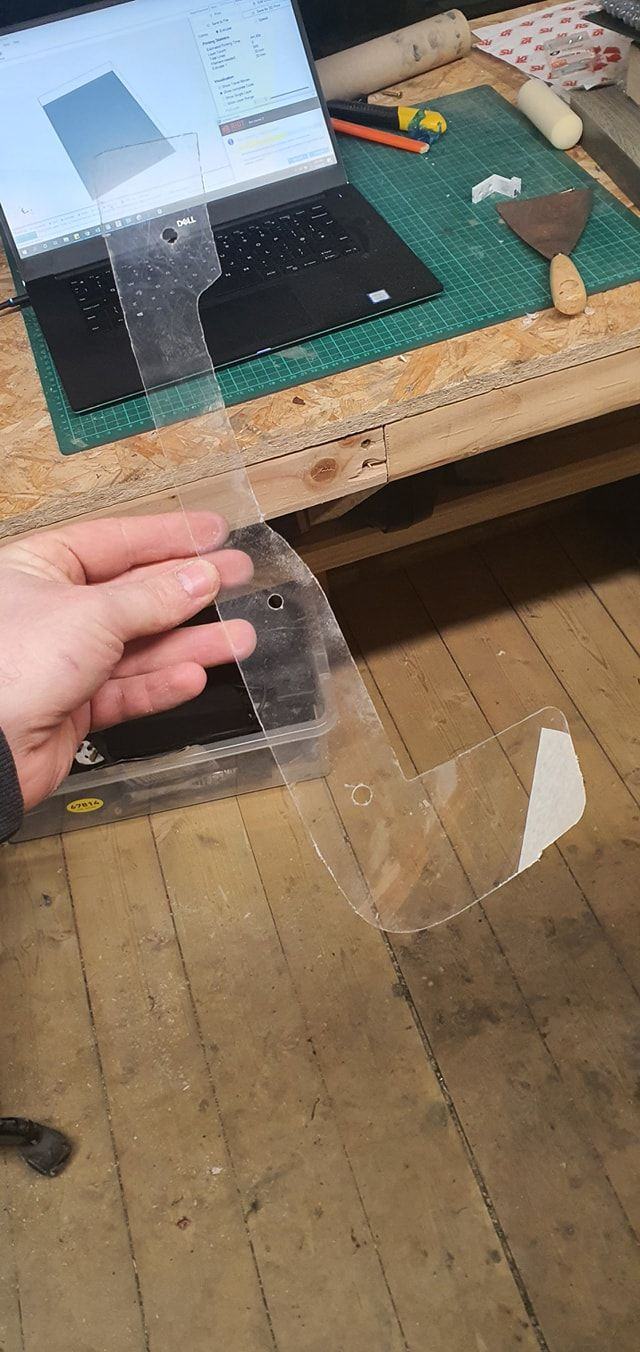

Next step for these was done today. I cut the templates in Acetate so that with the clear material I can address any misalignment with the holes and fix that up. Once I've got all the holes PERFECT changing the design wont be too much work.

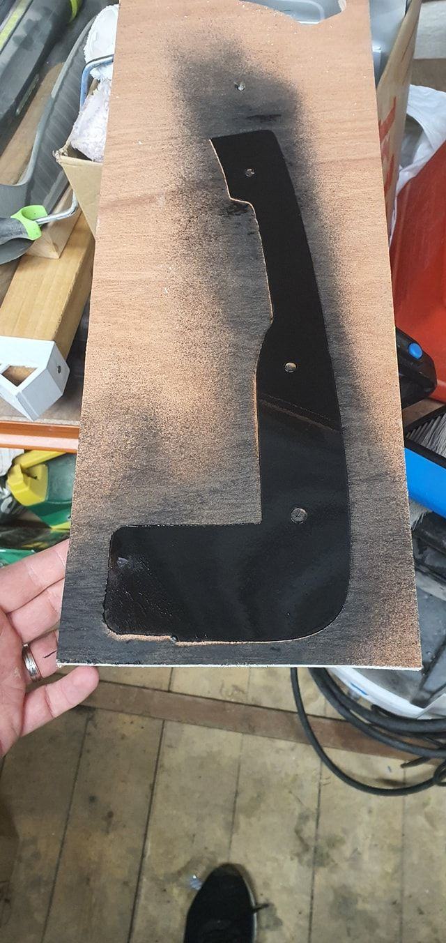

I've also sprayed one of them black so I can get a feel for what the contract and the overall look will be like on the car.

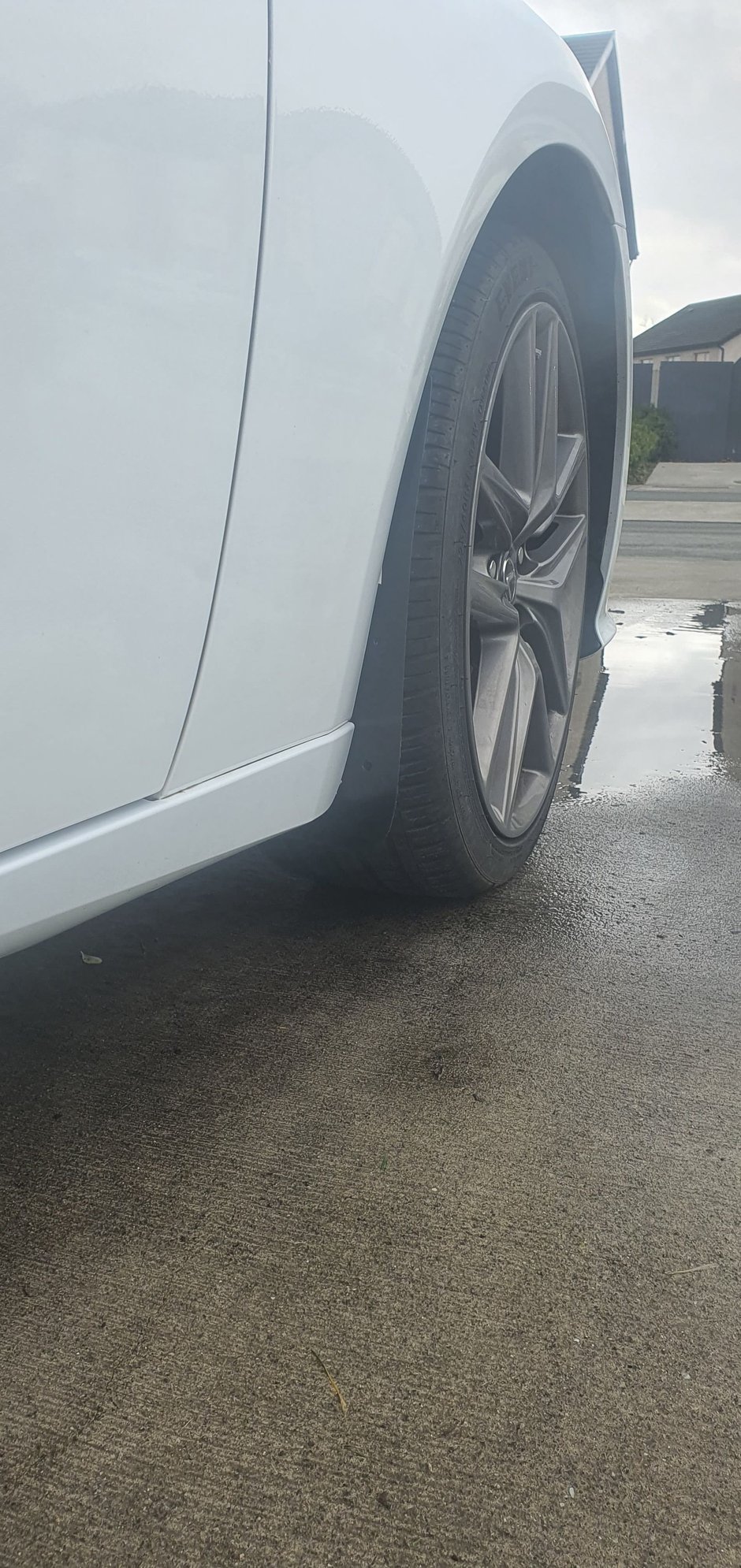

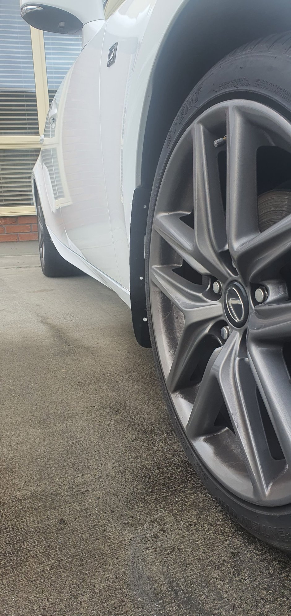

Don't you hate it when other people are right @ScytheDC may have been right and the dramatic flair is needed
I fitted my design this morning after the paint dried and it looks underwhelming. They do look sleek but I think they are missing the edge.
I pulled out the panel to be in line with the vertical line of the wheel so that it matches the original line of the wheel and follows the lines on the car (the wheel) and ScytheDC was right it does look WAY BETTER!!!
Dont mind the holes being in the wrong place now they are the original design just mounted to see how it would look so ill move everything into line.

Here's my first pass on a bigger flair it goes from just a rounded angle at the top to a 51mm flair at the bottom. I just eyeballed this but really I should probably line it up with the wheel so might do that tomorrow.
