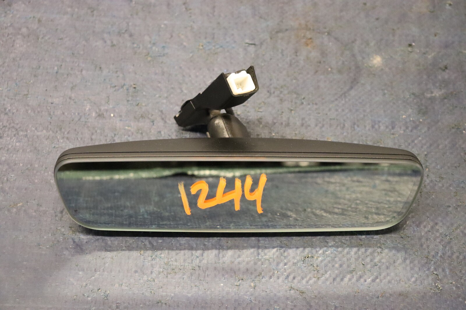

Yes, the compass is powered and does not require wiring up, however be careful with the mirrors that are not documenting as fitting. When I did this mod, I initially bought a frameless mirror with the compass, because I actually preferred the compass given the choice. However, that mirror had a base that did not allow the cover to attach in order to hide the wiring, and the wiring did not feed inside the mount, leaving it outside and dangling. I did eventually get the RC frameless mirror (without compass) and it works perfect.
This pic is all I have left comparing, the top one is the frameless mirror that had issues, in comparison to the bottom original, notice the base and wire differences.

Thanks for the comparison, I found this one which came off a 2017 Lexus IS, would this one fit, it has no compass, but i'm not sure if the harness is different or the same.
https://www.ebay.com/itm/14-18-LEXUS...S/273741231879

No, that is the same one I bought (only with compass), you can tell which ones are ok by looking at the base. The wire should not be seperate like that, it should be inside of the base and have a cover attached on the outside. The one you are linking to has the wire on the outside of the base, so even if you were able to find a way to put the cover on, the wire would push the cover off being on the outside of the base, if that makes sense. It will however plug in and work, it will just look like garbage with the wire and its plug in plain view with no cover.
https://www.ebay.com/itm/FACTORY-OEM...oAAOSwYNdcdE2x
This one has a compass but no wire on the outside, would this be good to use?

Yes, that one should be good.
