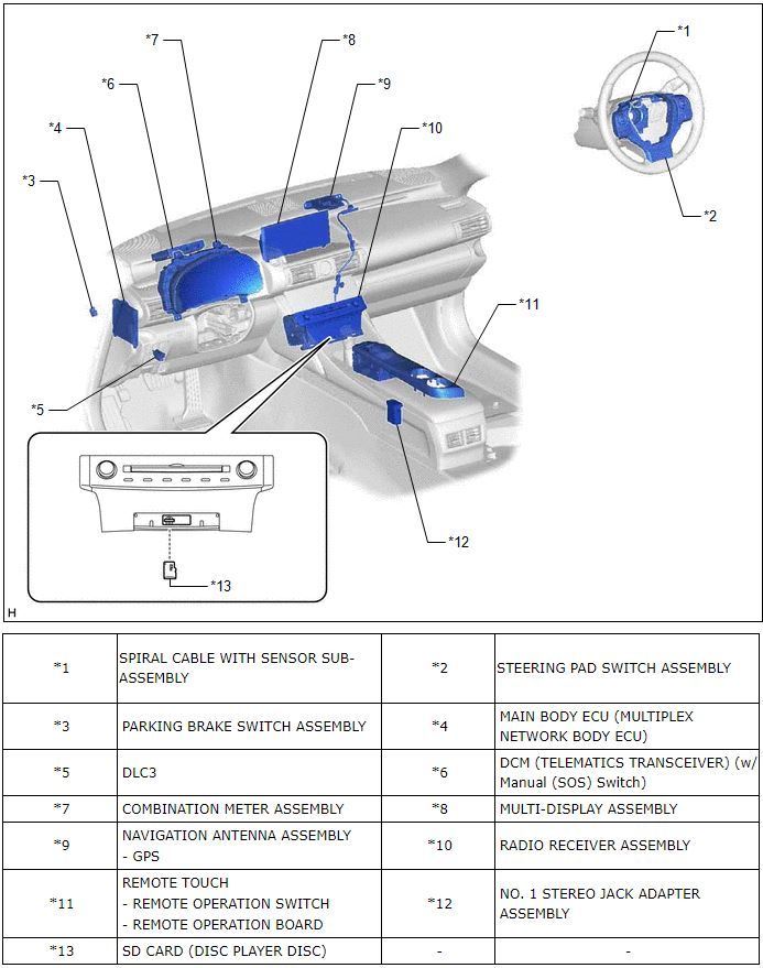

Great news. When you get the vehicle back, if they provided you the part number for the Telematics Transceiver on the invoice, if you can post it that would be great.
For your reference, it should be item number 6 in the below diagram they are referring to.
Just as a note, the Telematics Transceiver is only found on US vehicles (in North America) as it only applies to vehicles that have Lexus Enform and/or Safety Connect. So if you have a Canadian vehicle and you have this problem, this fix will not work for you, as the vehicle simply does not have that component.
The Transceiver does have the ability to mute the audio coming out of the radio and it uses the speaker on the top right of the dash to provide you with audio when using Safety Connect.
I'm a little surprised this was the issue, but if it fixes it, so be it. You will note this component was not on the possible faulty items list, which also makes it strange that this is the issue.
But at the end of the day it does have the ability to mute the audio from the radio.
