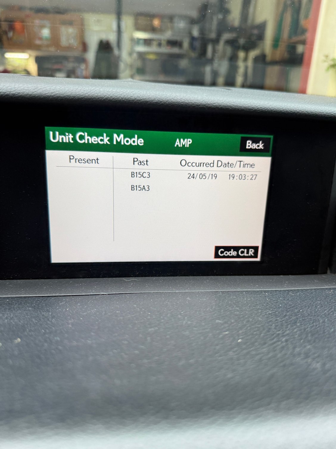

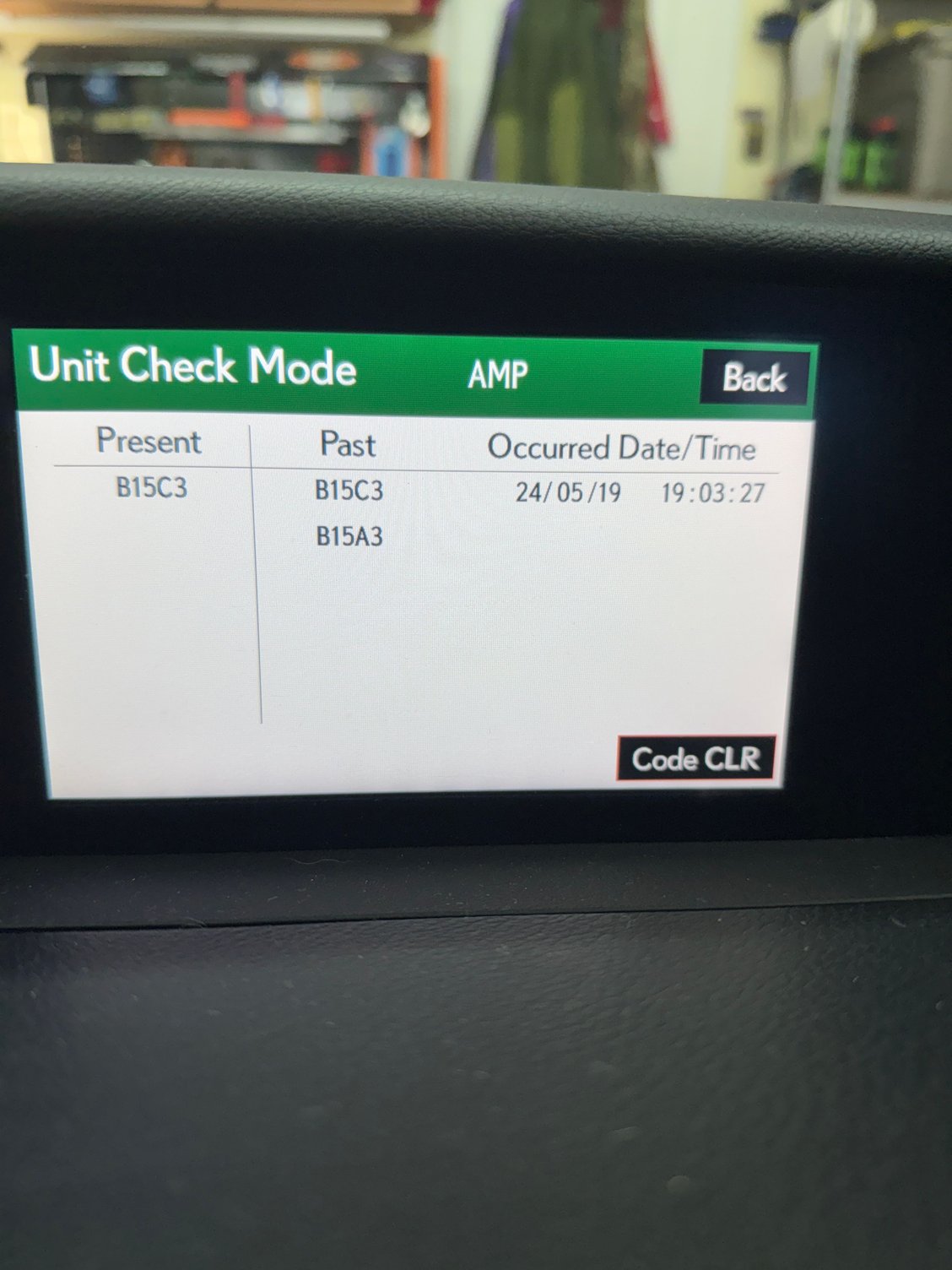

I'd like to get any advice that might be available for the same situation.
2014 IS350 Fsport, ML system, approx 90K, garage kept, half its life in Las Vegas, half in Florida.
First loss of sound was 6 months ago, replaced sunroof vents in the trunk, removed amp, opened amp and no signs of corrosion or water damage, sent to United Radio and they found no issues and updated the software. Put a small damp rid bucket in the trunk and it sound restored. I believe this is due to drying out the amp while it was removed and having it sit inside in lower humidity.
Last week, lost sound again, seems to have been paired with the car being in outside in the rain and then pulled into the garage. There was/has been super high humidity for several days.
Current trouble shooting.
1. AMP fuses good.
2. System check has a B15C3 present, a B15A3 past, a B15DB past, a B15D0 past.
3. Sealed the passenger side sunroof trunk vent, when removed the rubber seal that is exterior to the trunk was wet. No signs of moisture in in trunk area.
4. Sunroof(?) drain line IVO amp is unclogged, no signs of water or moisture.
4.1. No signs of corrosion on amp connectors.
5. Passenger side foot well shows no sign of moisture, kick panel amp connector not checked.
6. Removed center console, inspected amp connector, no damage, no moisture, no corrosion.
After all the trouble shooting, remove and reinstall amp, driving for 10-15 with AC on, sound is back after a full off/on cycle.
Questions:
This is most likely an amp problem, right? The loss of sound is seeming pairing with large amounts of rain or high humidity. ​​​Will new, used, or refurb amp not just have the same problem?
The amp probably past UR inspection due to the dry out period?
@Is350Zyzz how is your refurb amp?
@LaZeR is you loss of sound paired with high humidity, driving through water, or rain? I think the sound restoring through AC running is probably from reducing the humidity?

If I had your situation, I’d likely extend the amp connection wiring and mount the amp above the floor, instead of in its current hole.

No charge for the inspection and the software update. Cost me ~$30 to ship it to them. They shipped it back at their expense. They also turned it around in less than a week.
For the inspection I did have to agree to flat repair charge of ~$475 if they didn’t find something wrong. They didn’t charge me this in the end.
u
unrelated to your question about cost. When the sound is working I do not have B15C3 code.
