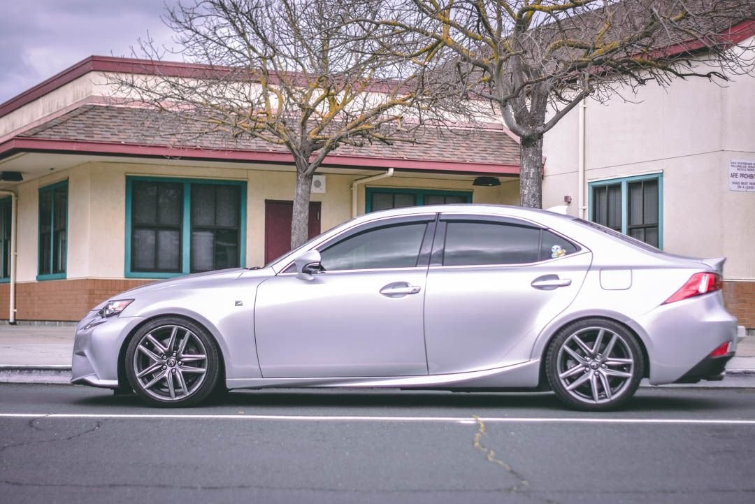

I've had the springs installed since last Tuesday. I've driven around 100 miles and my alignment is lightly off, but not too tilted. Here's how she's sitting currently.

That drop looks good
