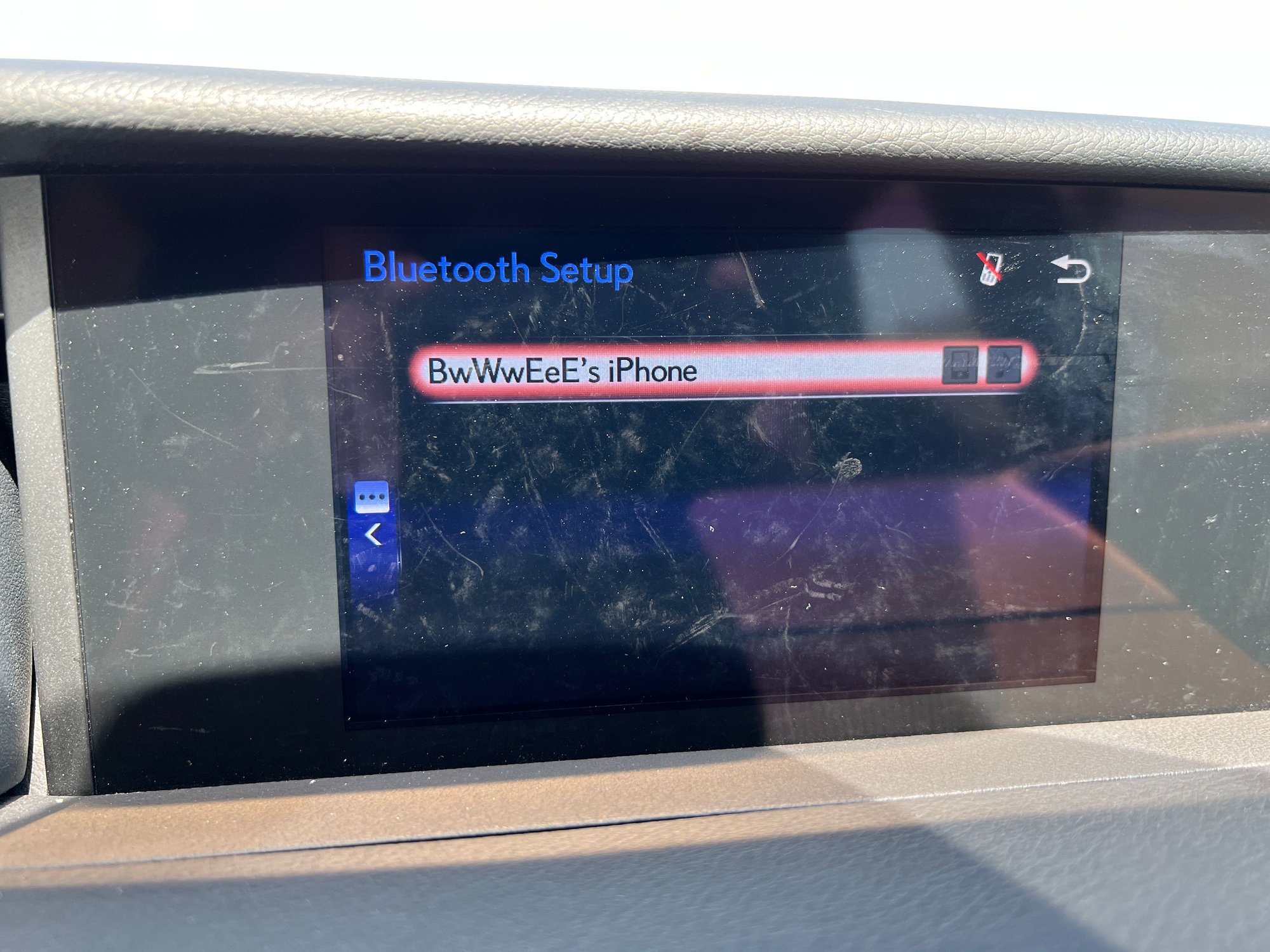

Could you post a pic of the screen where it lists the devices and has the Remove button grayed out?
How many devices are paired to the vehicle? Typically with Bluetooth 7 devices is the max you can pair...in this case, pair to the car.

This is what the screen looks like while I’m in park

Also in your pics I didn't even see a Remove button...not sure if it was the angle of the pic or maybe I just can't see it in the pic.
No the bluetooth profile did not transfer to new phone.
I only have my airpods profile that transferred over.
and yes you are correct, there is no remove button. sorry the grayed out part is disconnect phone.
