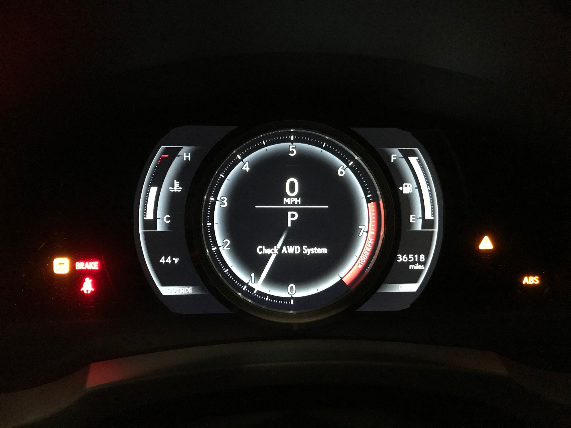

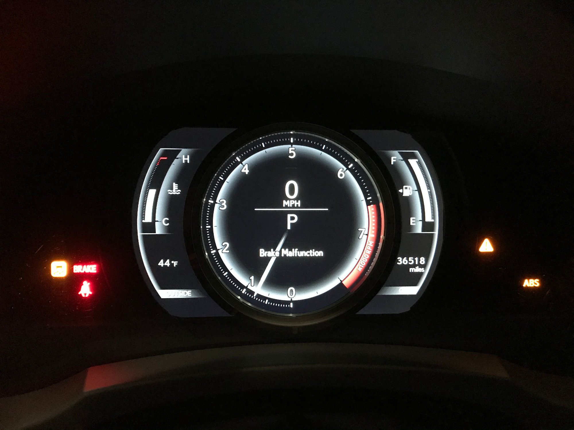

I owned a 2016 IS350 Fsport AWD and just replaced the driver side rear hub assy(OEM parts). Right after replacing it the abs, handbrake, and traction control light came on. Can anybody help me out with this?
the car feels great, just concerned about the lights. Please see attach picture.

Have you pulled what codes you might have?
Did you remember if the bearing you replaced with had a magnetic strip around the inside part of the bearing?

No, I haven’t pulled the code (don’t have access to a scanner). It did had an internal strip, but I didn’t check to see if it was a magnetic one.

just did and it came back as soon as I start driving it. The tracc light was flashing around 8 time and 3 times cycles. After I pass 5mph all the other lights come on and “brake malfunction” message. I recorded a video but can’t upload it for some reason.
