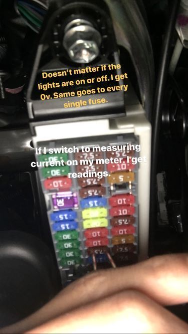

Originally Posted by UngBuck
I already try swapping another 7.5 Fuse with the 7.5 Panel Fuse. It wasn't helping. Of course when I pull it out, nothing lights up.
I used my multi-meter to read the voltage. Here is the voltage for the 7.5 Panel Fuse.
Just something to note, you had your multi-meter set to the wrong setting. You had it set to read current and not voltage.
I was wondering that as well. Thank you for letting me know. Lol it should be pointing to the left side right? the white section?
Yup! The one with the "V" label and range of 200m to 600. In this case you'd have to set it at 20.
^^^ Agreed...set to 20 as the vehicle battery is 12V...and the next lower setting on the meter is 2V.

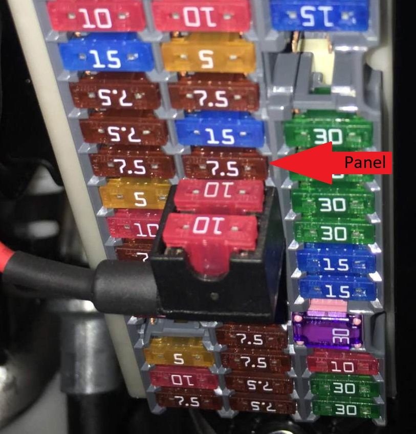

First thing I noticed was that the Panel fuse is right above that fuse tap for the dashcam (see below)...which I find more than coincidental as that's the circuit that's having an issue.
I know you said you disconnected it earlier, but it may be worth taking the tap out completely and checking all the surrounding fuses to make sure all are secure and nothing is touching or interfering with anything else it shouldn't be.

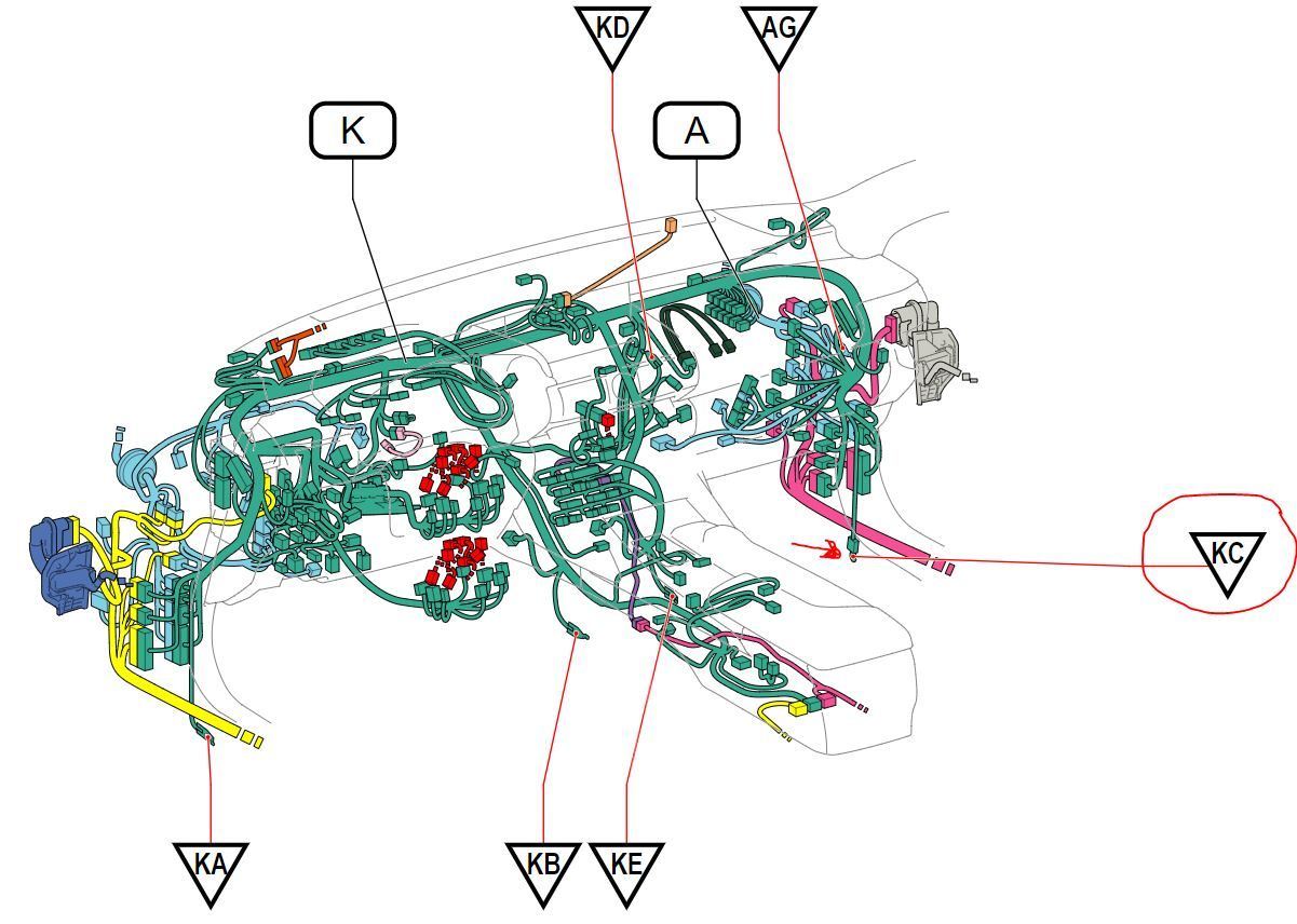

From the lists of components that the backlight (illumination) is having an issue, this would suggest a global problem rather than a component issue.
The Window Lock switch is part of the master switch on the door panel. The A/C controls is separate from the master switch, and seat vent controls is separate from the A/C controls and Window Lock switch.
This suggests it's either a power supply issue or a Ground issue.
As mentioned earlier, the Panel fuse supplies all the power for the illumination circuit for the interior...it does this through two Green wires from the fuse box where the Panel fuse is located.
One wire feeds the master switch on the drivers door and the other wire feeds the rest of the lights on the various circuits.
The Ground for all the illumination bulbs goes through the Combination Meter (aka Instrument Cluster), as that's where the processor is that controls the dimming of the lights via the input from the dimmer up/down buttons. The Combination Meter grounds the illumination circuit to the Ground Point KC...see below. You may want to check KC to make sure it's secure and is not corroded...and that the ground bolt is tight.

Considering the proximity of the tap to the Panel fuse as indicated in my post two above, I'm still betting the issue is there, but I can't see what it might be off hand.
If you put your meter on the exposed metal blades on the Panel fuse on either side of where 7.5 is printed, while the illumination lights are not on, meaning the circuit isn't activated, you should get battery voltage, so approx. 12V.

My last thought for now is maybe the tap blades are a little too long and putting stress on the inner circuit of the fuse block, causing a poor connection of the Panel fuse internally, even though the fuse itself if securely inserted. The inner circuit is just a bunch of flat metal strips with fingers at the appropriate spots which fuses are inserted...think of it like looking at a Google map.
The metal strips carry the voltage throughout the block to wherever it needs to go...when you remove a fuse it causes a break in the path, hence the voltage stops at that point
