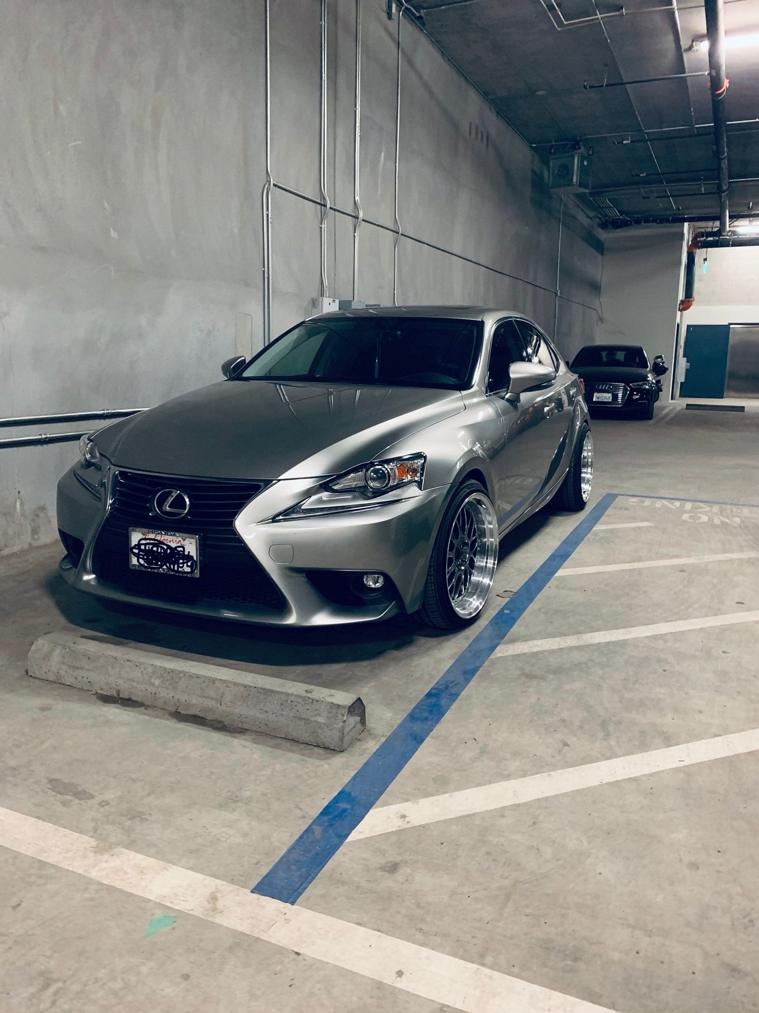

I feel I must mention the fact That I am fairly new to modding my cars. I have owned my Lexus for about a year and a half. I own a 2015 is250 rwd. I recently came across a good deal on some 3 piece wheels with tires. I rolled the dice and bought them. I put them on the car but I’m experiencing some fender rubbing on Both front and rear. They are on some 245/40zr19. I’m guessing upgrading my suspension would be the solution? If it’s a big project I’d prefer to return to stock wheels and tires. If anyone can let me know how much work I have ahead of me and maybe a ballpark on price? Just so I can assess if it’s worth it on my end, it would be so much appreciated.

Just looking at the pic, those are some nice wheels, but the offsets of the wheel look way too low.
Do you know the specs for the wheels? They are 19 inch, but what's the width and offset? And are they staggered? (meaning the rear are wider than the front)
Realistically speaking, there's nothing that you can reasonably do to fix this, aside from getting wheels with the proper offset.

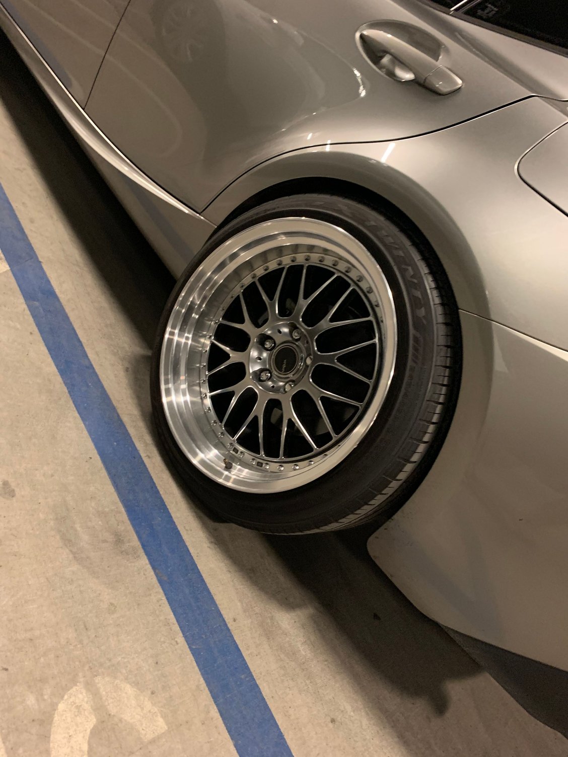

I was looking at that too, but then I was looking at the tire size, the amount of stretch, and how far the barrel of the rim was sticking out, and was thinking that even with a center change the barrel is probably too wide anyways.
My guess is that those rims are 19x9.5 at least, if not 19x10...which neither will fit the front without fender work as you mentioned. With a center change the rear might be salvageable though.

this is the rear and front
