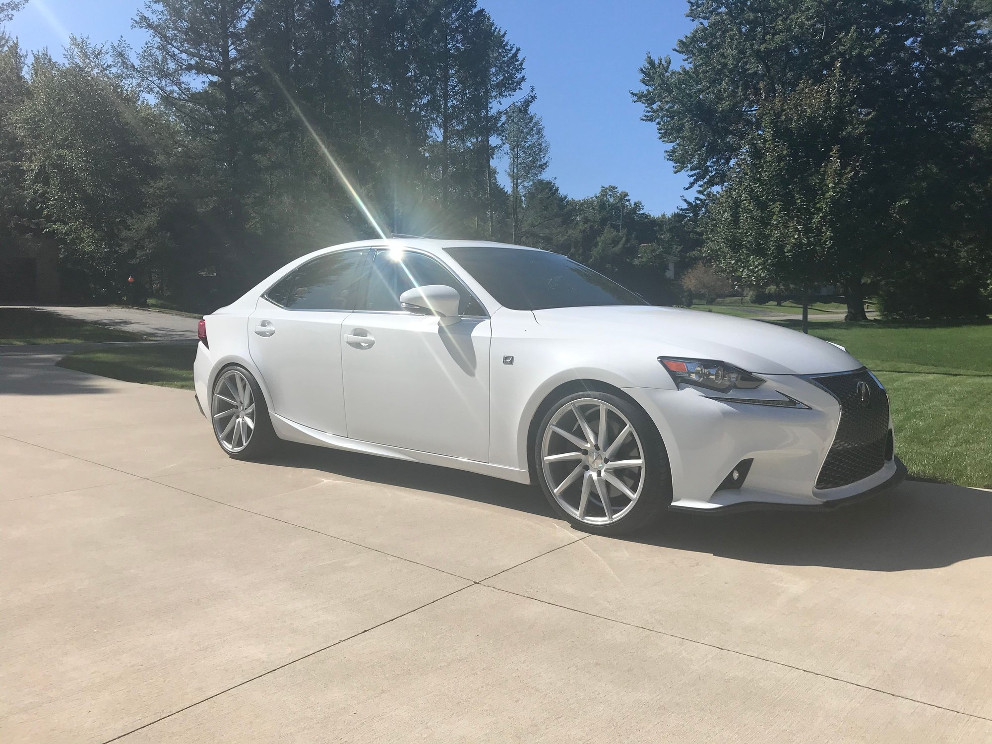

19x8.5 +32(235-35) 19x10 +42(265-30). Lowered on RSR downs with no rubbing. Also AWD.
