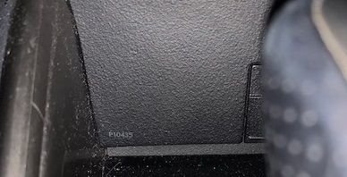

Hello Everyone, I previously posted a thread regarding issues I was having the the Radio/Nav unit in my car continuously rebooting. It led to not turning on at all during the summer months and briefly turning on during the winter months and shutting off shortly after.I have tried everything in the books, disconnect the battery terminals,update the firmware, etc.. it has all failed to fix the issue. I've come to the desicion that I'm going to purchase a new(refurbished) unit that will be coming from down south. However I realize that US models come equipped with Enform , something that canadian models did not come with up until 2019/20 models.
My question is , since the unit should most likely be a plug in and play type of deal, how will the unit or car react to having one installed from the US ? I don't care for enform to work, as all I really want to to listen to music again !! One difference I noticed from the US spec units is that it doesn't have a memory card located on the front like mine has.

I'm going to attach a photo of my unit where you will see the memory card slot(2014), the US versions, and I'm sure some newer models post 2015 don't have this slot.

The navi equipped units have the door on the front for the micro SD card slot...the SD card contains the map data.
The non-navi units do not have the door for the micro SD card.
If you've ordered one without the door, then it's not a navi unit...sorry.
Having said that the unit should function otherwise, except any subscription based services like Lexus Enform.
If you just want to listen to music, then that shouldn't be an issue.

The safest thing you can do is get a unit that has the same faceplate ID as yours. The faceplate ID can be found to the left of the micro SD card door. It will start with the letter "P".

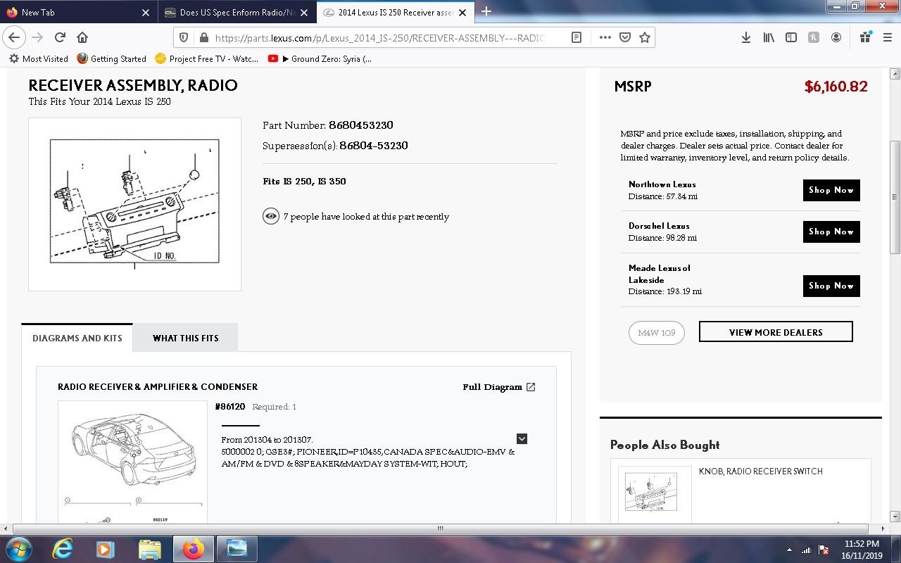

That makes complete sense now, they're probably harder to come by, and if they pop up they're either too expensive or they're gobbled up fast. In that case, as long as I get my original functions back, Im happy. It's funny you mention the faceplate ID, because I was searching up under that ID on the lexus website and the prices I seen quoted in MSRP were astromonical , a fraction of what the car is worth.
P10435
P10435
