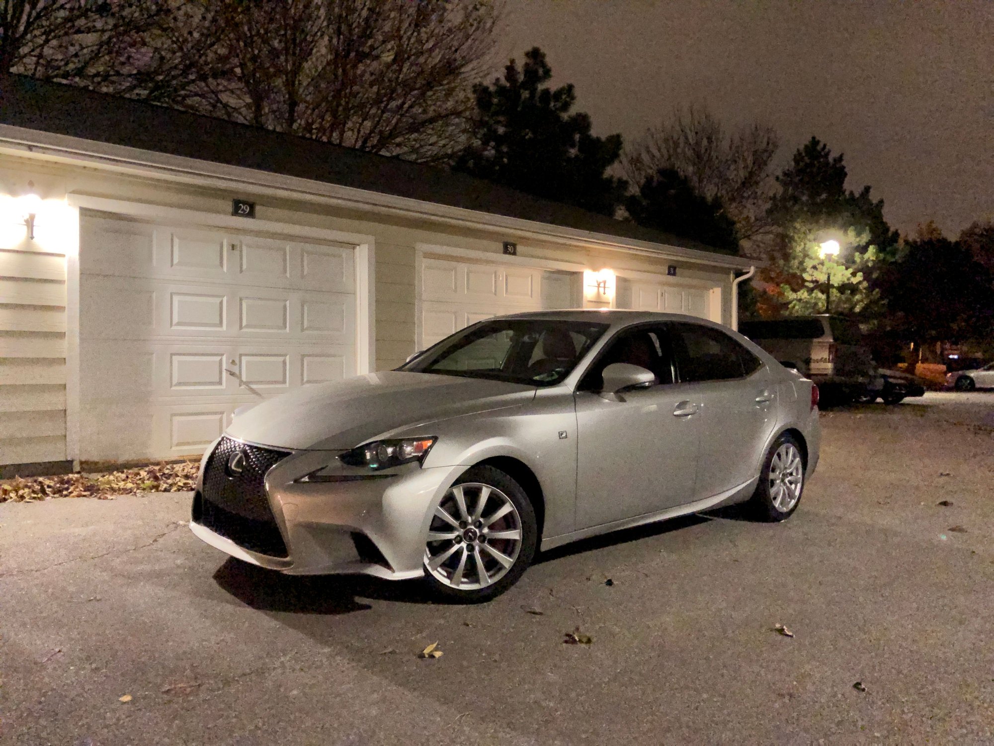

Hey guys/girls, I'm new to this forum and lexus (also cars).
I just got a 2017 lexus is 300 AWD 20 days ago with 17k km on it so practically brand new.
I was just looking for some advice on how should I proceed to deal with the Toronto winter.
I am going to purchase winter tires and was reading that I need staggered tires, is that something I should do? and keep my current rims?
Also was going to get the weathertech mats.
If anyone else has any suggestions or other opinions for me it'd be greatly appreciated and will search this forum around to see what others have done.
