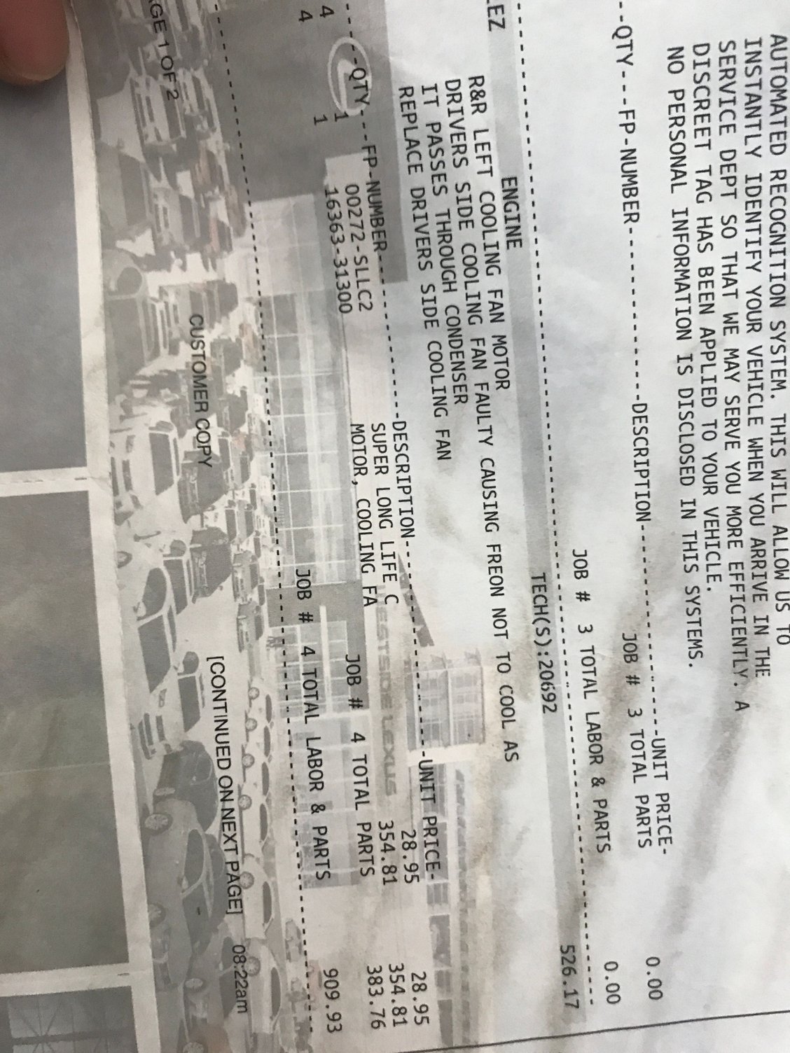

This is what they did last time last year. They said it’s not covered under warranty anymore either.

The invoice shown is for a radiator fan motor, located under the hood just behind the radiator, which won't have any effect on the fact the front of the cabin isn't getting cool, and the rear is.
It sounds like you are having a blend door issue where you're requesting cool air, but getting warm air.
As pngo mentioned, a servo motor initialization using the Techstream tool at the dealer will likely resolve the issue.
And holy **** they raped you on labor. I haven't replaced a fan motor myself, but it looks like they charged about 4 hours labor (give or take). I'm struggling to think it took that long...but I could be wrong.
