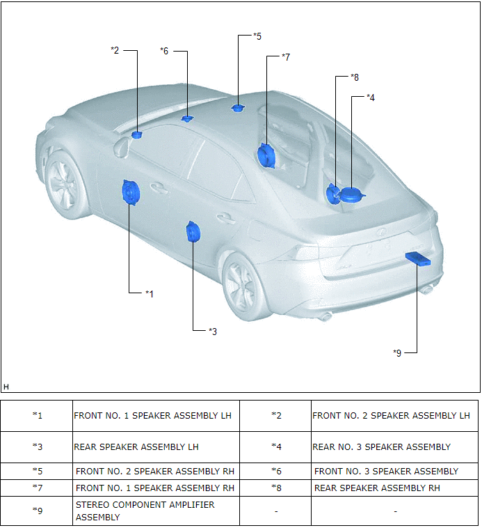

Guys, I have some follow-up questions. Where is the amp located? I heard it's on the passenger side of the trunk. I opened the trunk but didn't see anything. Is the amp behind those panels? Also how does the amp look like and is it something that I can buy on eBay?
Why does it break now? I've have had the car since Aug 2013.
Old Oct 20, 2019 | 05:54 AM
Sasnuke's Avatar
Sasnuke
Joined: Feb 2017
Posts: 6,260
Likes: 1,752
The amp is located on the floor on the passenger side of the trunk.
You will need to take some trim pieces off to access it. It looks like a rectangular metal box.
You will find a part number on it...you can use that to search eBay and other sites for a replacement.
