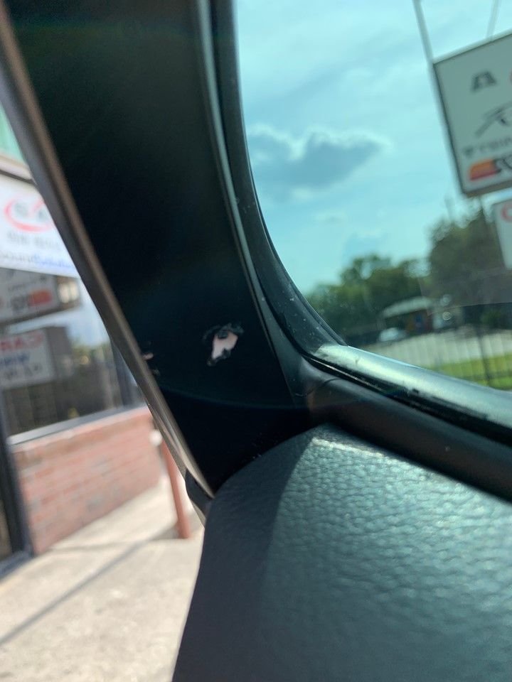

Has anyone ever had this interior trim piece scratched? It seems to be a wrapped piece and I can't find the replacement part. This is the back driver side window.

That’s actually part of the door fame itself. You are correct though in your assumption, it is wrapped, it’s just automotive blackout tape. All the upper door frames are wrapped in this, with a little disassembly you can peel and replace this tape, I’ve had to do this when buying a used vehicle that had smokers in it, in which it was melted from flicking from the window. Not a hard task, just a bit time consuming. Hope this helps.
