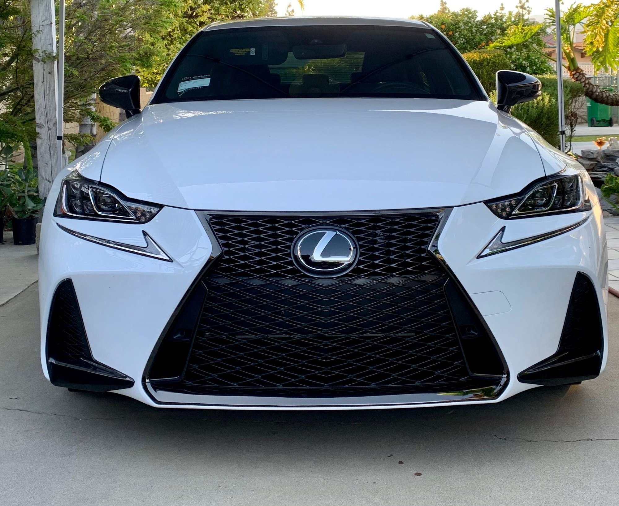

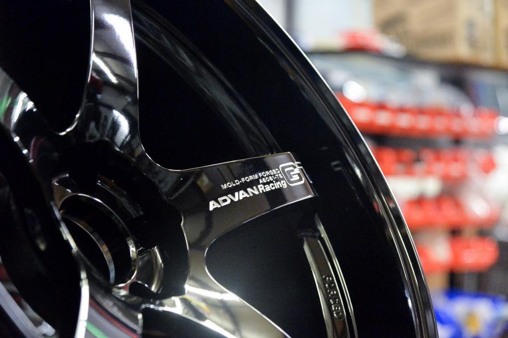

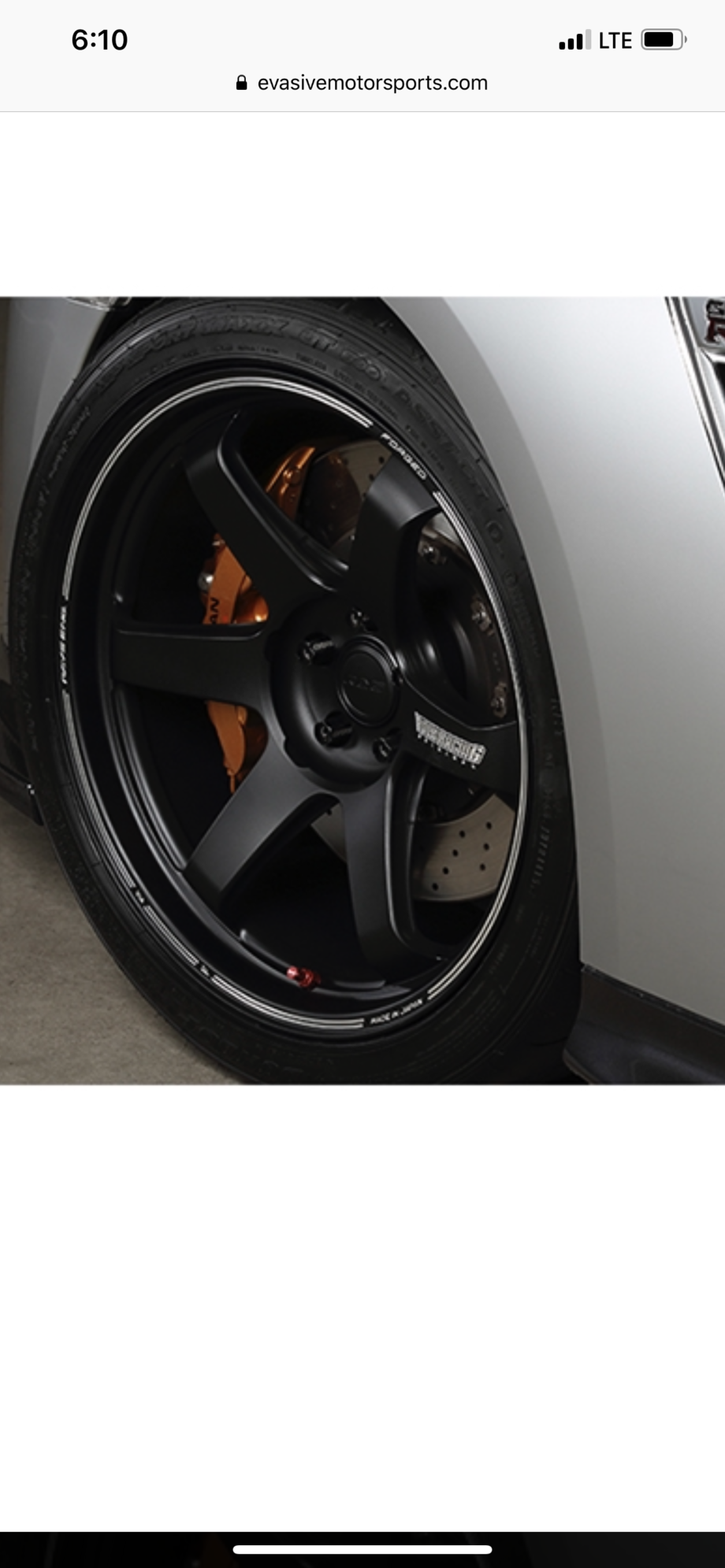

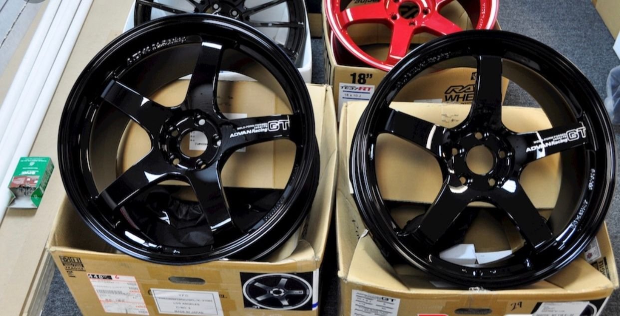

Planning on getting wheels for the wife’s 2019 IS350 F Sport. Debating on the Advan GT Premuim or the Volkracing TE37 Ultra track edition2. Advans don’t make them in 19’s gloss black so I would be getting any color and just get them powder coated gloss black if we go with Advan. For the TE37 they make them in front 19x8.5 + 35 and the rears 19x9.5 +35 flat black called the blast black. Is the rear too aggressive if the car is lowered? Will the rear rub with that offset? Also I will be getting them powder coated in gloss black and pin stripe the letters white if we go with them. Tires I’m going with Michelin’s PS4 S front 235/30/19,Rears 265/30/19 We are not going to slam the car just a nice decent drop for functional not show. Thank you for any advice

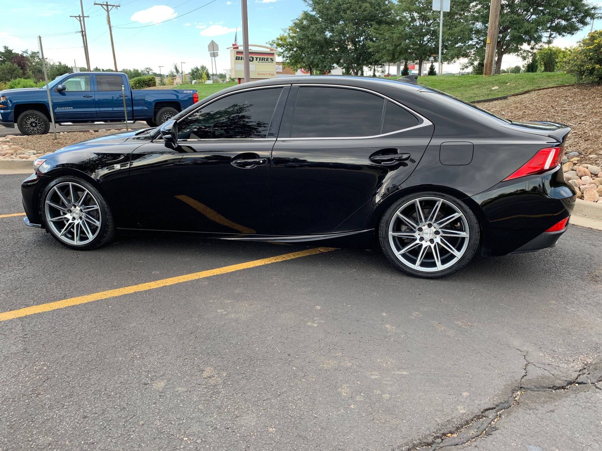

I went with 19" +32 in the front and +38 for the rear. Offset of +32 for the rear made it stick out a little too much and the +38 for the front you will hit the brake calipers.

I have the same fitment in the front with Rohana RC7s. It's going to depend entirely on the spoke design, it's hard to say unless you're using something that has been used before. The spoke design on the Advan GTs looks like they would clear the brakes at first glance.

I didn't use the spacer, if spacer was used then it pushed the wheels out a little more than I wanted. So I had to go with the offset of +32 for the front. Its all gonna depend on the spokes on rims.
