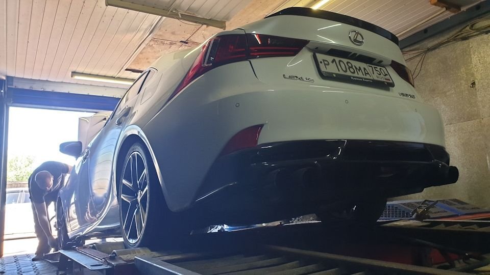

All fits bolt on. Using stock 6-speed transmisson (not 760).
315 HP on Dyno.

Wow, that is amazing. I need to find a 350 engine now. What's the cost for the project?
Engine about 1000 usd
How's that 6 speed automatic hold up so far? If it's all bolt on, no modifications needed to get it runnin, this should be a dream come true for 250 owner also, do you know if a rwd engine will work for awd?
Is it profitable doing on swap in America? You have a760h transmission now, it will works super with a 2GR-FSE combo. But you will need to make some ECU tunes.

Originally Posted by Sasnuke
Did you get the engine, harness, and ECU?
What about the fuel lines for the port injection?
All works well if u make right tune on ECU. No need to install ECU from 2GR-FSE: hardware remains the same.
