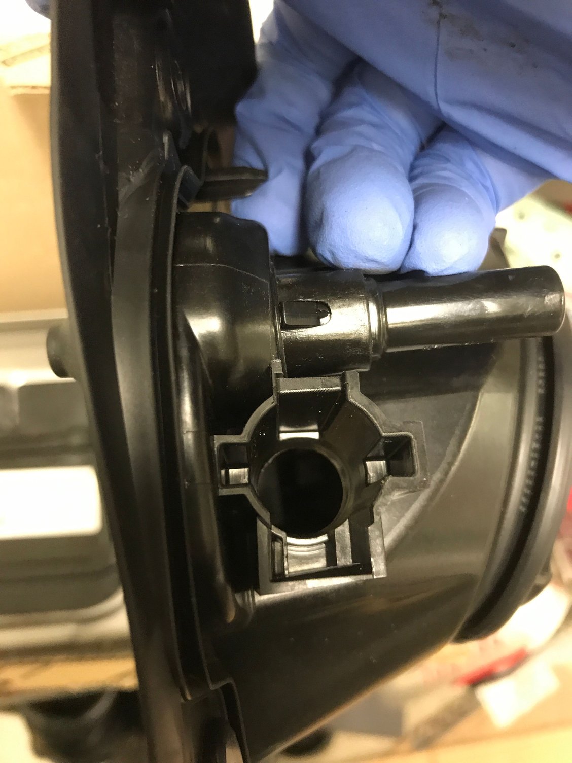

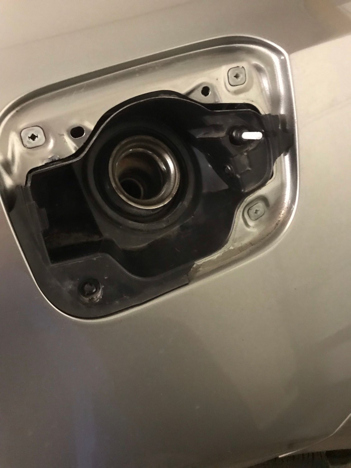

The whole plastic black piece needs to come out.
There's nothing else blocking it except for this thing on the right, some sort of sensor?
This is the new one, something plugs into there and I'm assuming that's blocking it from coming right out as seen in the second picture.
This is on a 2015 IS350 F Sport, any help would be greatly appreciated!

Resolved, on the first picture, right below the white pin, if you pull forward the flap of black piece, there's a locking mechanism that you can just push the tab and it releases the whole thing.
