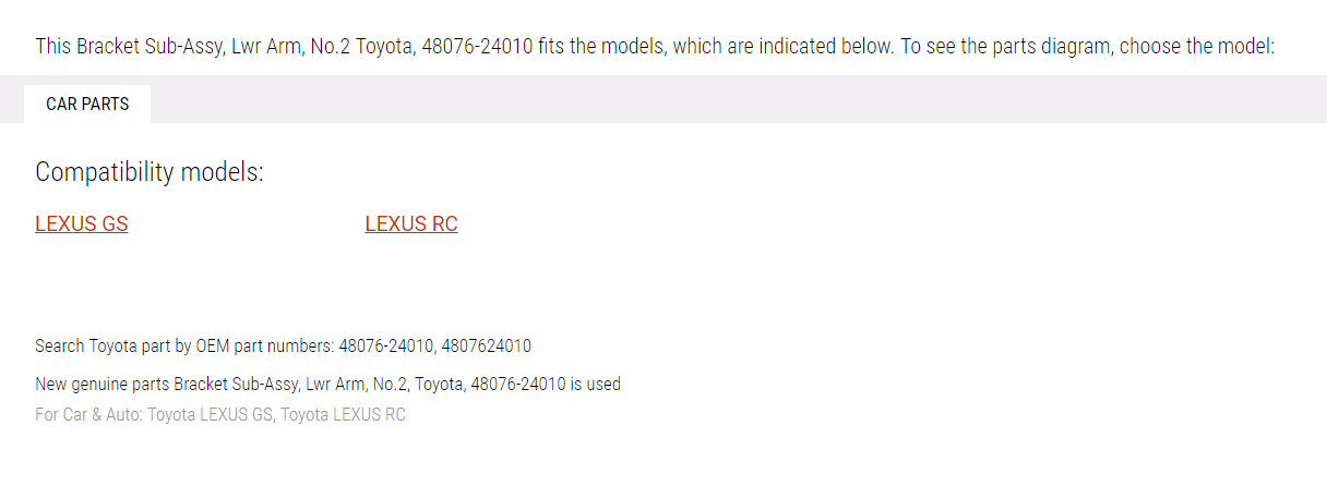

Originally Posted by ShrinkDoc
Where did you buy the parts and how much were they? I found it here for $67. Does this look about right?
Actually, the identical part (48076-24010) for Lexus is $67, for Toyota OEM it's $27. Can anyone tell me if this is the same part?

According to this site (Megazip), there should be no problems with the Toyota equivalent working correctly. Has anyone confirmed this yet?
