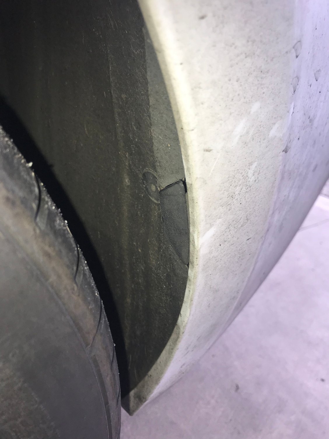

Can someone tell me the part numbers for the round clip and the square clip that holds the bumper. Not sure how these broke off or came off

Ah, not too extreme for that to happen. They're really light and somewhat loosely placed twist/ clips.
I dont have PN but I would take off and walk into the dealer with those. Auto parts stores are rarely helpful in that regard.

It looks like the part it inserts into is also broken from one side.

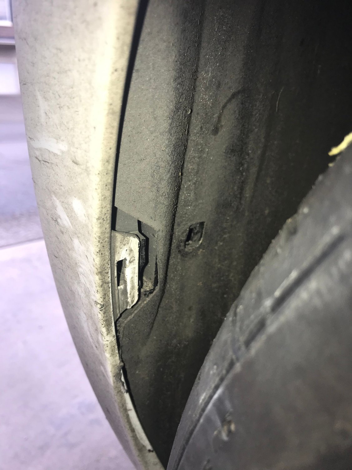

Looked through it on that site, did not see the part. Tried prying out the other side, felt as If I was going to break it.

Is this front or rear? Hard to tell what exactly I'm looking at based on these pics.

Its rear passenger side

52155-53070 - Support, Rear Bumper RH
90189-06157 - Clip, Rear Wheel Liner
The first one is the "square" piece that's broken. Note that this is much larger than you can see in your picture, as it has structure underneath. The second is the round clip.

$100 for that square clip??? I don't think the first part number is correct. The second picture shows the other side square clip. This looks like something else.

If you take it apart, you will see these are the correct parts you need. As I said, it is not just a small piece that is missing, but rather a small piece that is broken off of a much larger piece. The "round" clip that is missing has a square back side that fits into the piece that is broken (which is what you linked to on eBay).
These are 100% the pieces you need.

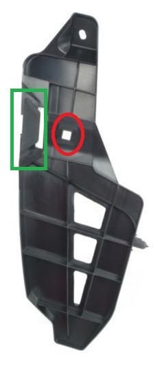

I think the pics in the eBay aren't very helpful because the part is laying down on the face that you would see if you pulled back the fender liner...so it's hard to visualize what it looks like from that angle.
Jeff is correct with the part numbers he provided.
Here's a better look at what he was talking about...the green rectangle and red circle are what the same parts in each pic:

Thank you, those are the correct parts. Does the bumper need to come off to install that large piece??

It doesn't have to come off all the way, but you definitely need to loosen off that side/corner.
You should have enough room at that point to change the large piece.
