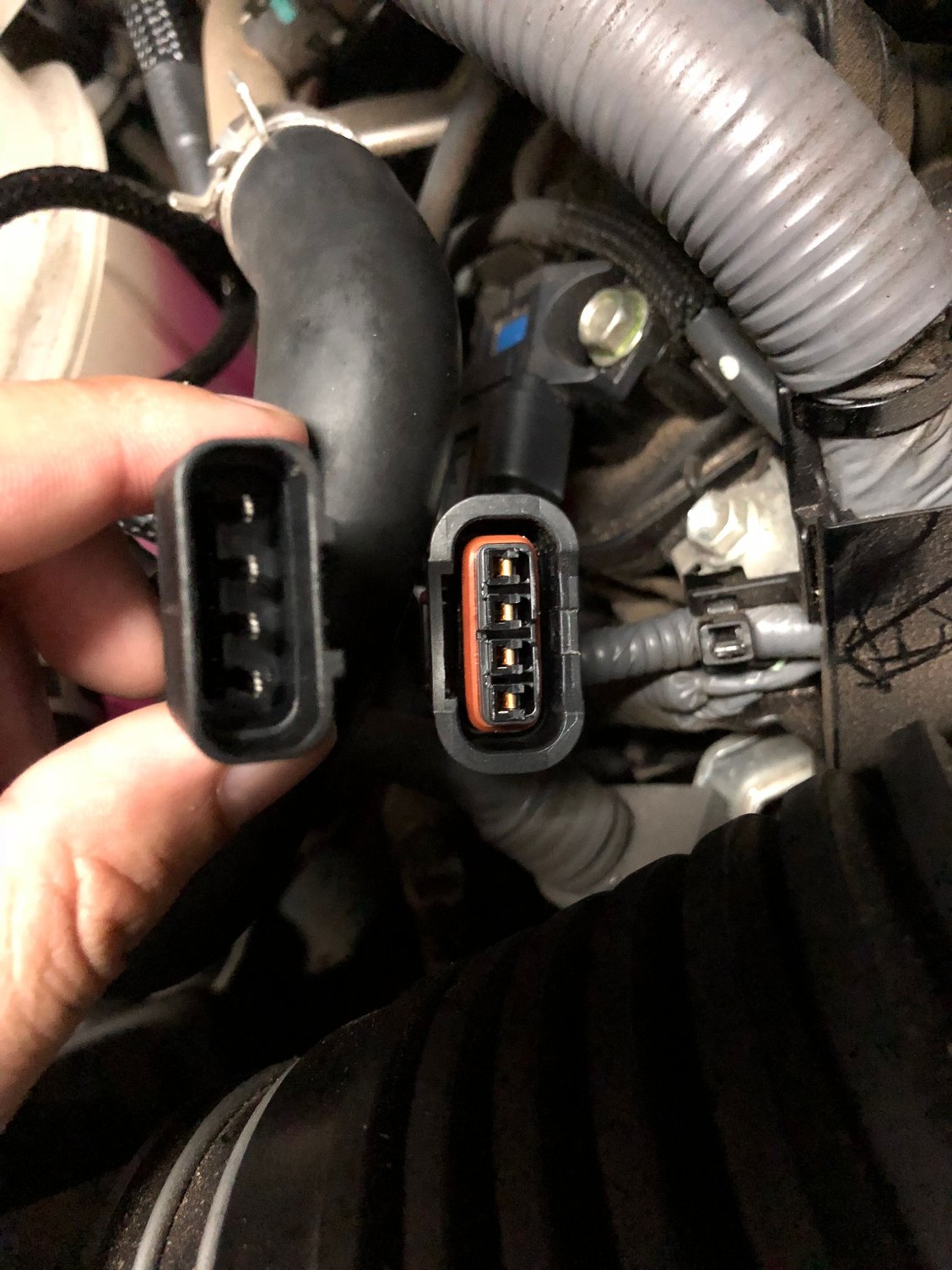

Looking for some input here...I bought the BMS Stage1 from E46CT, hoping it was just a simple plug and play...and it should be....but....
All the plugs plug right in, except for for the male end of the "rainbow" cable on the BMS harness. It will not plug into the female factory harness.
PIC:
The bottom is the factory TMAP harness / plug. The top is the male plug from the BMS harness.
The plastic guides on the BMS harness keeps the two plugs from plugging into each other.
I know that several forum members have 2018 IS300s. Did you guys run into the same issue?
And if so, how is it overcome?
It would also be super helpful if someone can take a picture of that same plug from 2018 cars where a piggyback module has been successfully installed.
Thanks in advance. I really need the help here.

I think you're down to 2 options:
  1. Get the connector from the year that matches the BSM plug and swap the pins over
  2. Cut off both connectors and solder the wires directly together
The first option is clearly the neatest and nicest of the two. And fairly easy to reverse as well.

So a quick update:
I verified that my TMAP is the same as the 2016-2017 models. PN 89421-78010.
So it kind of appears that they changed / updated the harness / plug but not the sensor.
As a side note, the other MAP that I didn't have a harness / plug issue with, is also the same as the 2016-2017 models. PN 89421-78020.

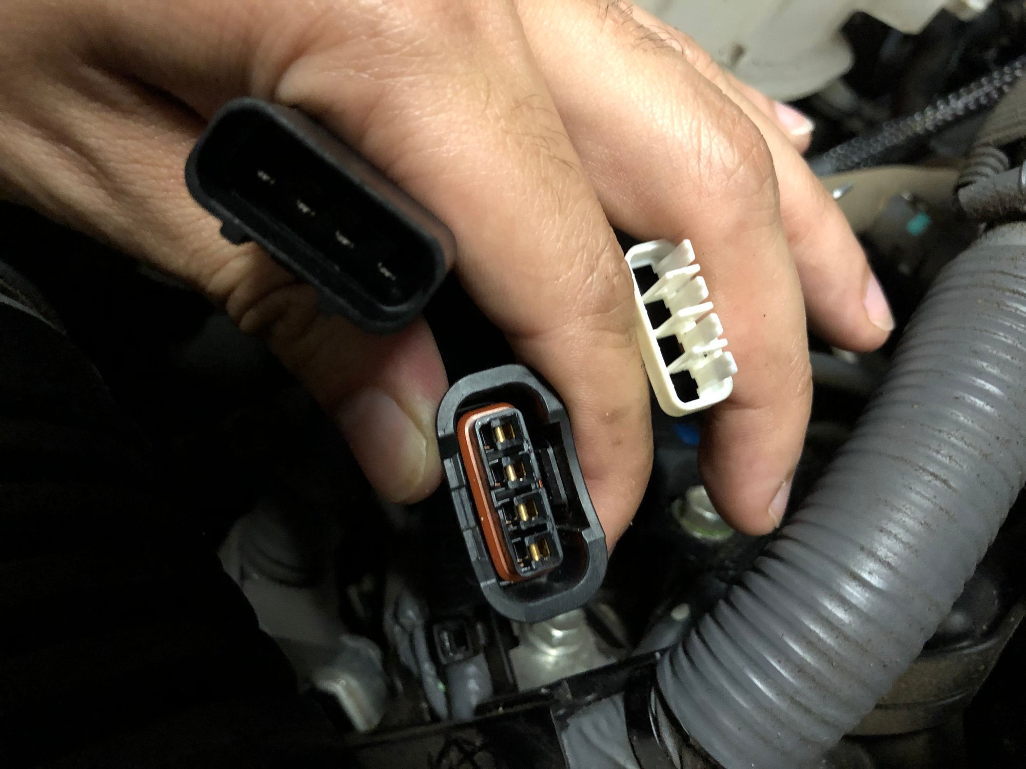

Use a bird beak/ long nose pliers and remove the white section of the top plug (BMS connector). The previous owner should be missing theirs which got stuck in there.

Sheddy FTMFW!
It pulled right out.

Originally Posted by mvaldez24
Is that white piece not suppose to be there in the BMS side connector?
The white piece should only be present in the female connector and not the male.

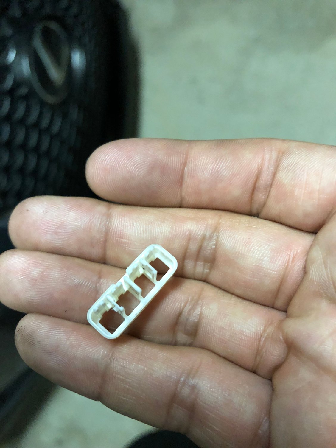

This is how mine looks. I had a little white piece fall out the other day when I disconnected it. Dropped in the engine bay. Couldn't reach for it.

Managed to grab it just now. This is actually mine from my female connector. First time I connected it wouldn't snap in. It would plug and slide in but didn't snap into the tab. When I unplugged it this piece fell out but when I plugged it back in, now without this piece, it still wouldn't snap in. Should it lock into the tab?
It should be able to snap in, but it's also fine if you take it off. I would much rather it lock into position.
