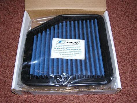

When you guys say f-sport filter do you guys mean .. sorry for all the questions just kinda new to this
Sorry for all the questions just kinda new to this
Yup just a better filter that’s reusable and allows more air through it. It’s not as restrictive as a paper filter.

Yup. Part number is PTR03-53141-AA or you can shop for it online.

The 2018 models aren’t in almost any website database so if you use 2016 or 2017 Lexus IS 200t that will pretty much confirm it since it’s the SAME exact car engine and transmission wise. That’s what I do. But to confirm yes it should fit although some people said they had to cut out the carbon filter for it to fit perfectly.

If you have the 4-turbo then yes it should fit.
i got mine off used on ebay for like 18 bucks. in mint bright blue condition (very clean)

I don’t like oiled filters personally. The F Sport filter isn’t oiled and changing the filter cause a significant difference in noise from the turbo. Go aftermarket intake for loud turbo noises d:

I wouldn't go K&N or oiled. It's risky in my opinion. No two people will oil it the same, enough, or too much. Oil on the MAF is something you definitely want to avoid if you put too much. And there's no real definition of "too much."
Go F sport! Set it and forget it. Clean (spray cleaner and rinse) every 10k or so.
