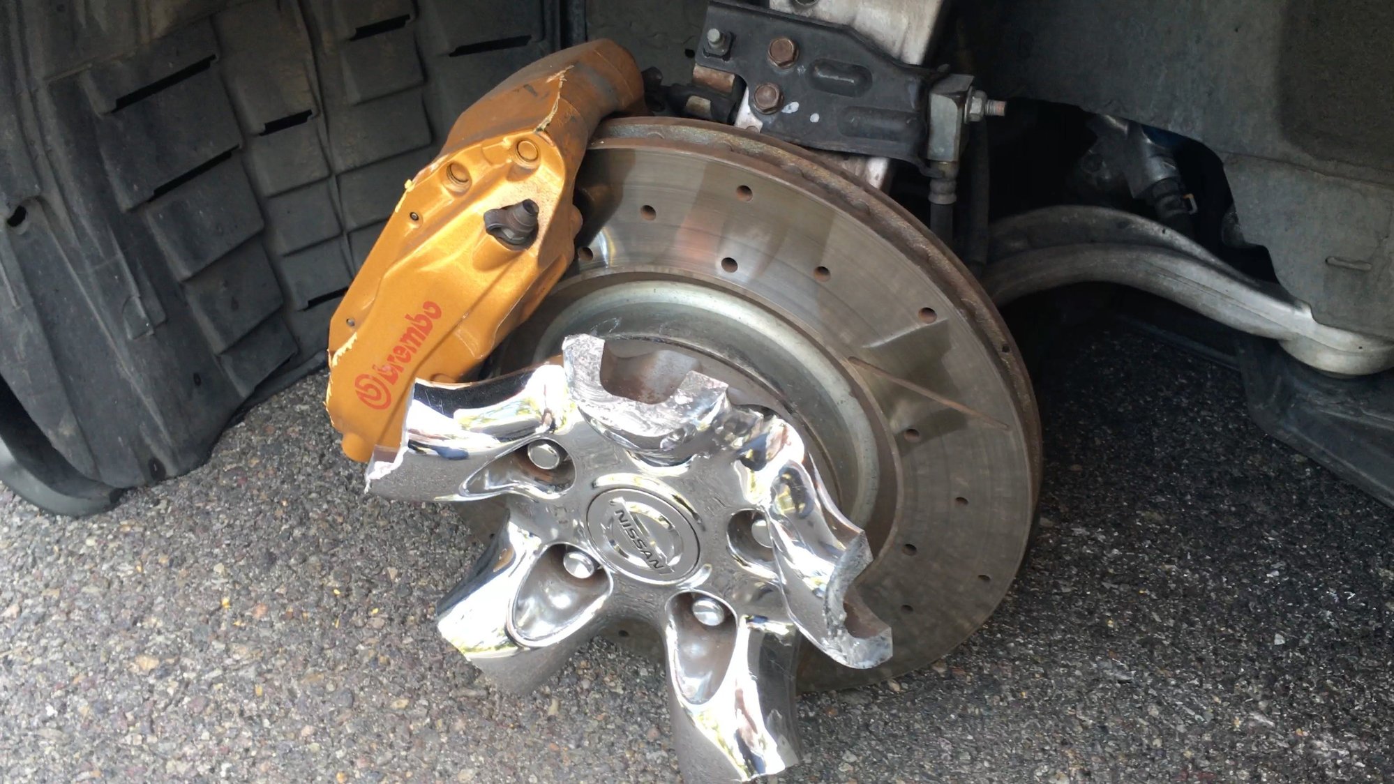

3) Nope. Your life is literally riding on your wheels. As cars are required to be as light and efficient as possible, without computer modeling/simulations, you have no idea what risk you've just created by reducing the mass of your wheels. As it is, they are probably at their limits. Once microcracks form on the back of the wheels, that's not something you'll notice until you're doing 80 down the highway. Not to mention other problems you might create with vibration, corrosion, etc. you're basically experimenting with your life there. Is it worth it?
Just showing the general nature of wheels cracking due to fatigue. Shaving a wheel down even more would scare me.
